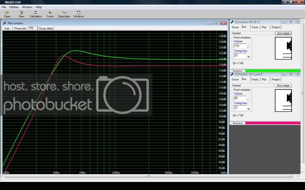

I recommended what I did because you said you didn't want to add any more power. SE's are rated at 600W and can handle a little more, and should have great SQ. My SDC sounded fine, had a little excursion noise, but you wouldn't notice it all the way in the cargo area...I wouldn't tune it as high as I did though. I'd tune two SE's to 33 and two SDC's to 35.
In Green: 2 12" RE SE's in 4 cubes @ 33Hz
In Pink: 1 12" DC Level 4 in 1.7 cubes @ 32Hz
