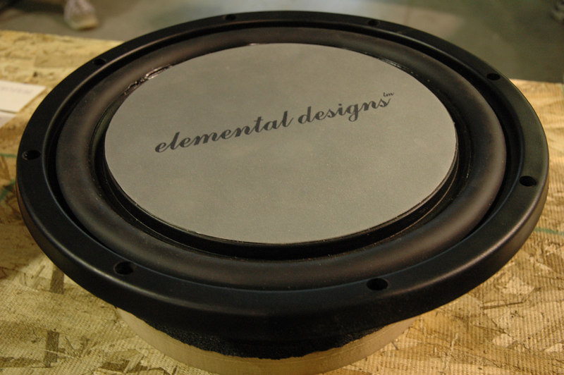

New Product Release : Elemental Designs SQ10 - Slim 10" Subwoofer
After more contraversy than I ever want to see again in my life. This product is now underway. It's in a similar point in production as the Eu-700 was when we did this. We think is a good way to introduce the product.
The Product : SQ10
Avaliable Voice Coils : Single 2 / Single 4 - Will be noted as S2 / S4
Size : 10" Only to Start ( Will explain this later )
Box Size & Power Handling Spec :
Sealed - .3 to .5cF
Sealed Power Handling - 100w / 500w
Vented - .5 to 1.0cF
Vented Power Handling - 100w / 300w
IB Capable - Yes
IB Power Handling - 50w / 200w
Specifications :
Qts - .29
Vas - 46.7 L
Fs - 25.5 Hz
Re - 3.2
Xmax - 9.3
Qms - 2.7
Qes - .32
BL - 15.1
In Car Frequency Response (eMAX Testing) : 10 - 100Hz
Anechoic LMS Frequency response to 350Hz
Voice Coil Diameter : 2.5"
New eD Toolings : Spider, Spider Landing, Cone, Dust Cap, PVC Logo piece, Surround, Gasket, Motor. (everything basically)
Other Features : FLEX Spider (new braking design), Woven tinsel leads (amazingly effective especially in this case over hanging for durability). Co-Linear Motor design. Integrated cooling features. Neo magnet.
Pricing : Right between 9Kv.2 / 11Kv.2 (per output tests this is where it belongs)
eMAX Results :
133.1dB Peak @ 54Hz
120.25dB Average SPL
Virtually dead on output wise with 9Kv.2 / More than old 10KX which sold for more than this will, using a smaller box.
Physical Dimensions :
Overall Diameter - 10.3"
Mounting Depth - 3.0"
Mounting Diameter - 8 7/8"
