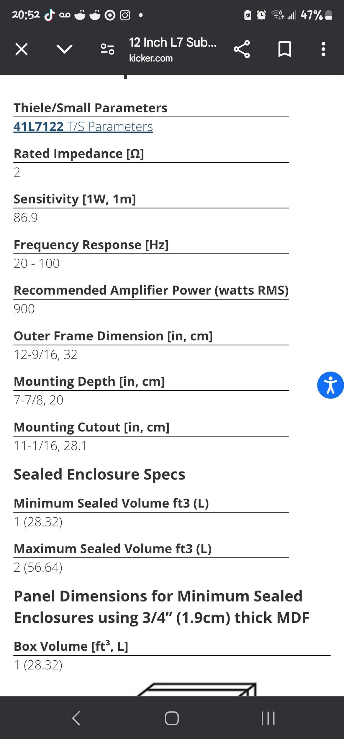

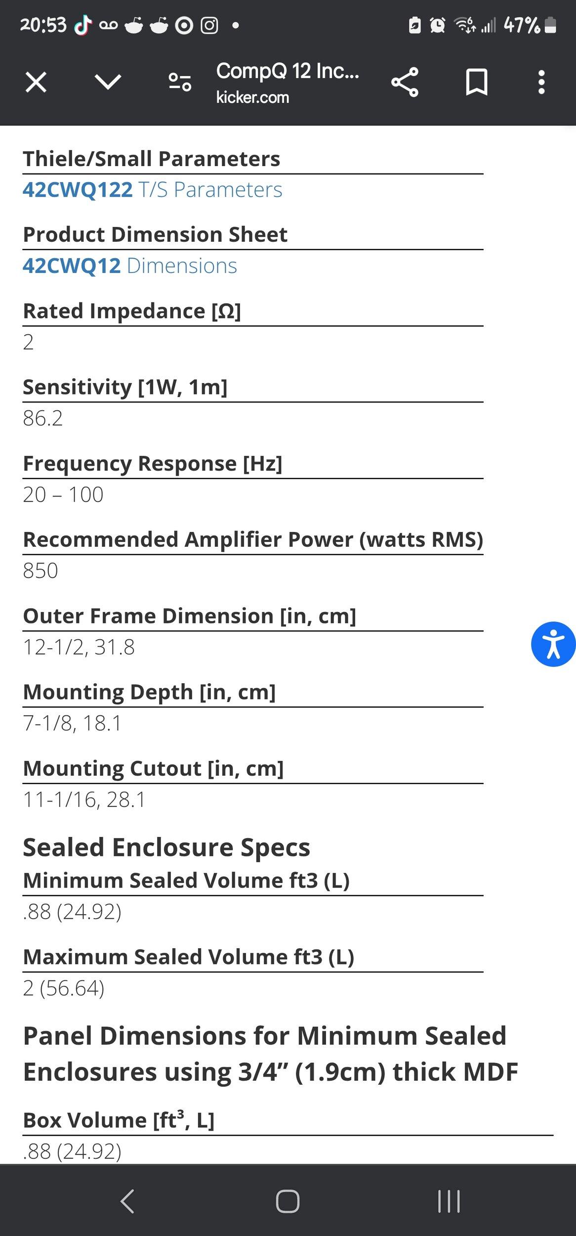

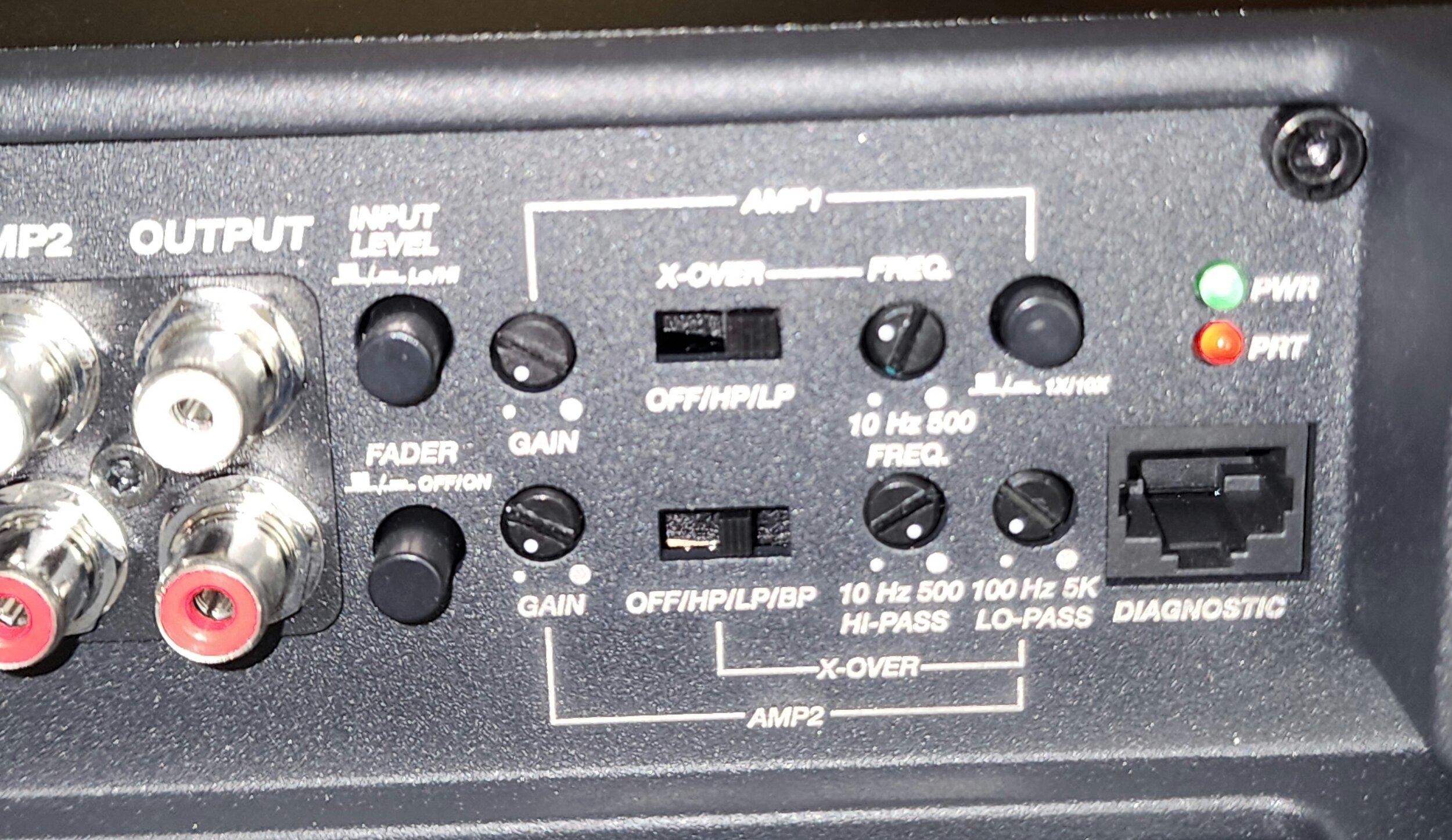

I have a kicker warhorse wxa1000.4 and it has 2 amp I'm trying to hook up the l7 qclass 41l7122 to amp 1 and the 42cwq122 round comp to amp to. I'm provided pics. Can anyone offer guidance. I don't get the 1x/10x button. Im kinda new to this so please be kind

"Set the 1X/10X frequency multiplier switch to the setting that is appropriate for your application. A setting of 10X will set the range of the AMP 1 crossover to 100Hz–5kHz"
You'll want to leave it at 1x for subs and cross them over starting at 80Hz, then adjust down until the sound blends well with your mains.

it sounds like you are saying you have a Kicker wxa1000.4 that you would like to wire up as if it is 2 separate amps. Basically, you want to hook up two subs to it by bridging 2 channels to each sub. Is that correct?
Pics of your sub setup may get more responses, 2 sub types are unadvisable usually. L7 and compR? I'd like photos and goals stated.

I reiterate what I said... the way I read your question is you have a 4ch amp and are trying to power your substage. What are you trying to accomplish and with what? Photos of your subs/enclosures and install would help
