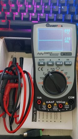

If you order one of these meters from Amazon or the upgraded version with higher resolution display, setting your gains will be pretty easy. Also, order a second set of leads and an RCA connector like the one at the bottom of the pic. You can use it on the outputs of the head unit to find out how many volts it is outputting and the distortion.
