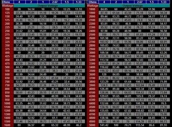

  • 741313448_ampchartRMSchart-nodirections.jpg.deba0c92db461eaa1feb91ef6d1938b3.jpg

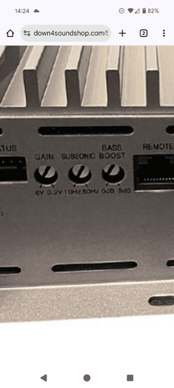

Gain can also be thought of as a voltage matcher. Your amp just says min and max, but many will have a couple numbers at the min and max. Here's a pic of a Salt 8k. If you're head unit puts out 6v, you would have the gain set at the lowest setting. If the head unit only puts out 0.2v, you'd be able to put the amp at max gain. For most, it's somewhere in-between.
