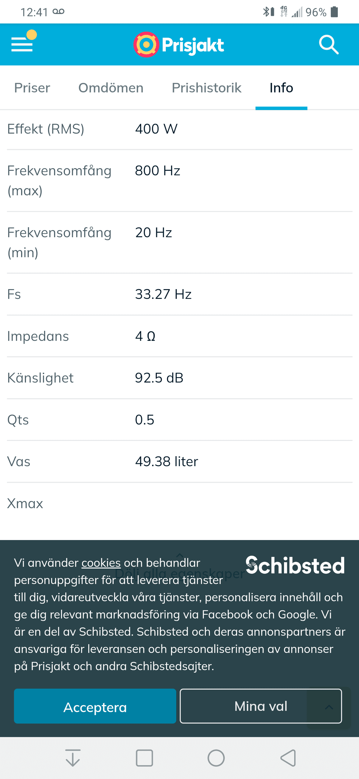

It's called MDS DS300RS. Got it at a second hand place. I can find very little info about it on the web.
This should get you started. https://www.prisjakt.nu/produkt.php?p=158785#statistics
