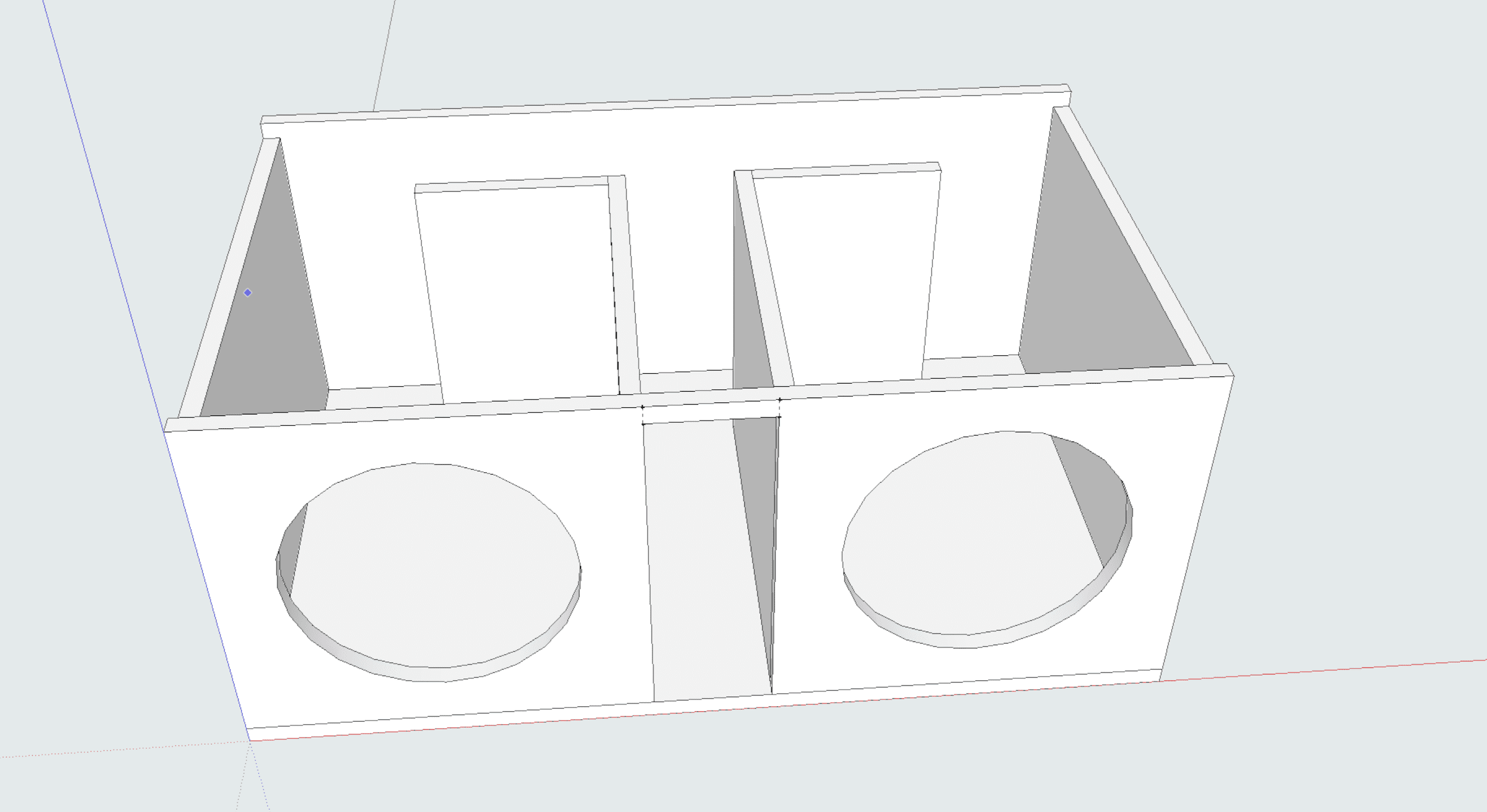

I have a 2018 silverado and I'm looking for help designing the box. I made a custom box for my old car, a 2008 impala for two kicker cvx 12's. Turned out great. I used google sketchup to make it 11 years ago. I'm just now getting back into it and it's kind of coming back. This is difficult for me because I'm putting it under the rear seat. There is a guy on youtube, MB enclosures, he makes bad *** boxes but want's almost $1000 for one. No thanks.

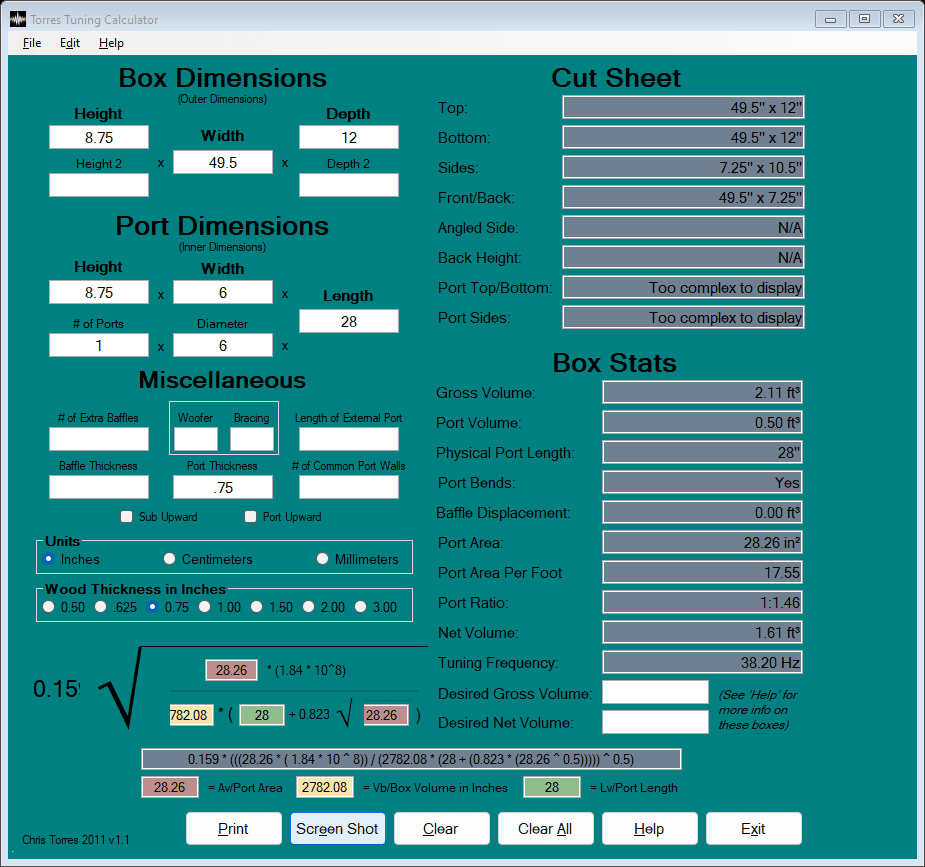

I am going to be using two 8" kicker ls7 solo baric. I forget how I tuned my old box to 33 hertz, alothough I think I used Torres box tuner. I will attach what I have done for my old box and the dimensions on the new box. I would really appreciate any help. Pleas let me know if the box dimensions in Torres make sense.

Thank you so much for this information. Did you design and build the box? Is it for two drivers? What is that program you're using? I would love if you could help me some more. I designed this box I attached 11 years ago for two kicker cvx 12". Ported and tuned at 3.17 hrtz I have no idea how I did it. I forget. Take a look. If I could get the dimensions I could build it in Sketchu and then make it with wood obviously.

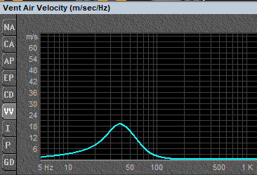

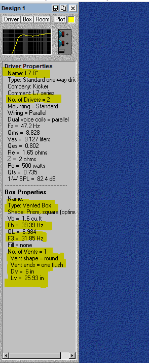

I used BASS Box Pro. It’s what parts express uses on most all their woofer spec recommends. I didn’t build the box phisically that is. I also modeled the box you provided as well. Going off the NET 1.6cu ft of your box - two, 4” ports 23.5” long or one 6” port 25.68” long. The single 6” vent has slightly less vent noise, both options are pretty good. using the box you proivided and the results are almost the same, even looks a little better. So, the box that you initlally posted and two of the Kicker L7's, 8" woofers.
don;t worry about the secondary rise in the graph, it's not a factor, not relevant.
For the others you listed, Name: CVX12 (2 or 4 ohm) Type: Standard one-way driver (12" Sub) Company: Kicker
BASS Box pro didn;t like the CVX 2's a ported box, stronly suggested a sealed box, and a big one at that! At 31Hz, wanted a 6 cubic foot box, which looked pretty good, 11cu ft sealed box looked very flat dwon to 31Hz.
The response in any of the ported boxes were very peakey, somtimes as much as 9db, very undesirable in my book. This was 2 of the CVX 12's in a 6cu ft box, 6" port 40" long!
