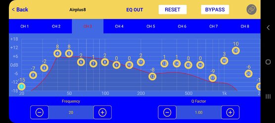

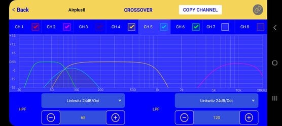

Hi all,
New here. I've been diving in to the world of car audio and have a DIY Frankenstein of sorts. Cars name is Nebula. She sounds good but I'm messing with my DSP settings and getting in a little over my head. I understand it all I'm just not exactly sure what process to use to balance it all correctly? There's just so many different settings. I'll try to get a full enough list of what I have. Keep in mind I've done every bit of work myself and have been working on a shoestring budget. Invested around $600-700 so far.
Sjoybring head unit
4 @ 60w speaker level outputs supplying two 3.5" stock dash speakers and two rear door speakers
4 @ low level rca outputs supplying DSP
Wireless android source (usually)
Marts bluetooth DSP
4 ch in
30 band parametric eq
Phase swap
8 ch output
Input eq
8 ch output eq
Ind gain
Delay
Ind crossover settings

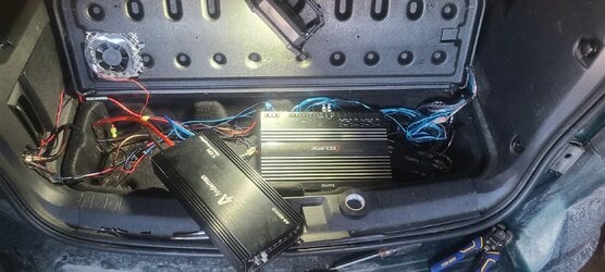

Just upgraded to Andemann AS2200.D amplifier (DSP fed, ch 6)
Class D
Tested 1000w RMS @ 2 Ohm
4ga power/ground
No fuses
Internal protection
Subsonic/LPF
Using bridged input but has R/L and bridged output for strapping (?)
Gothic 12" subwoofer
Dual 4 ohm voice coils wired parallel
1250w RMS @ 2 Ohm
Tuned to 20-90hz
300w integrated amp (DSP fed, ch 5)
Kicker 10"
Not sure of specs
Used for midbass, tuned to 60-200 hz
Eclipse EA4100 (DSP fed, ch 1-4)
300w RMS
4 ch in/out
4 x 75w RMS @ 4 Ohm
NVX XSP69KIT 300w RMS 6"x9" X-Series 2-Way Component Speakers with 1" Silk Dome Tweeters
Didn't use included 4,500 hz crossovers.
6x9s in front doors tuned around 100-1000hz
Tweeters on windshield in top corners tuned around 4k-20khz.
I know I'm missing some freq but my 6x9s (ch3,4) seem muddled when I raise the LPF. Any suggestions? Maybe raising LPF and lowering dB in the 1k-4k range?
