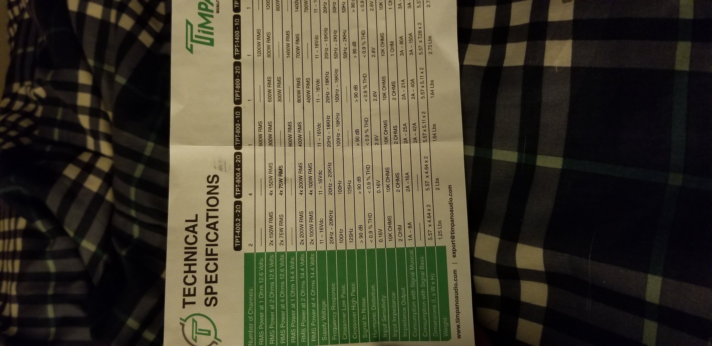

Ok so i set my gain on my sub amp with a dmm,
but On my amp for my doors (timpano 800@2 ohm) it has a connector and leads for speaker wires. That plug into the amp with 2 pos and 2 ground leads . When setting the gain on that amp do I connect both pos together and both neg together and then set my voltage from those leads? And if so I plan on running two speakers at 4 ohm so would j set the voltage to 56 volts?! Kind of confused. 56 volts seem a lot for a mid speaker amp?

Running 2 prv mb250 ndy 8 ohm speakers.
As long as you have wired the PRVs correctly you should be at 4 Ohms for a pair to a single speaker post on the amplifier
