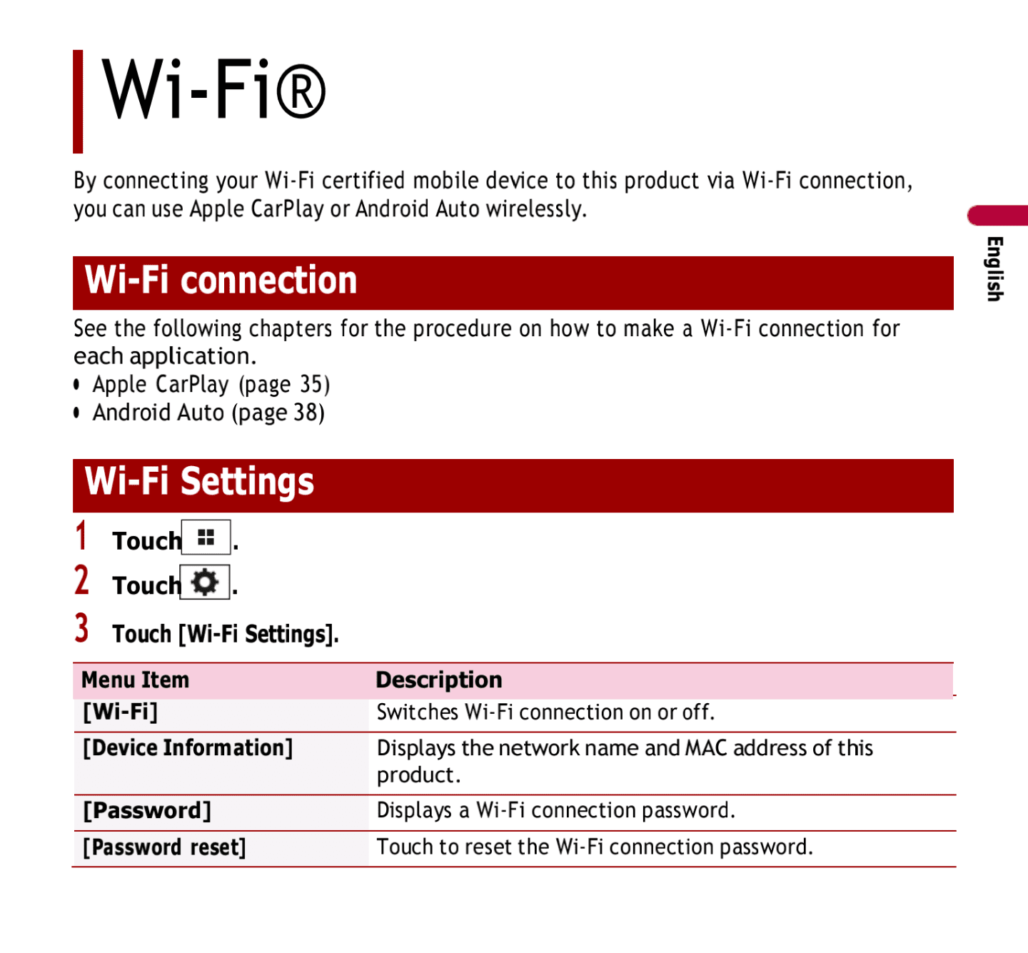

Hi all. I had a SPH DA360DAB installed today. All is working fine, but it seems that the wifi isnt transmitting?
I set it to on in the settings, and I have tried on 2 phones, but the wifi doesnt show up.
I need it for the Andrid Auto wireless feature.
Any suggestions?
Any suggestions?

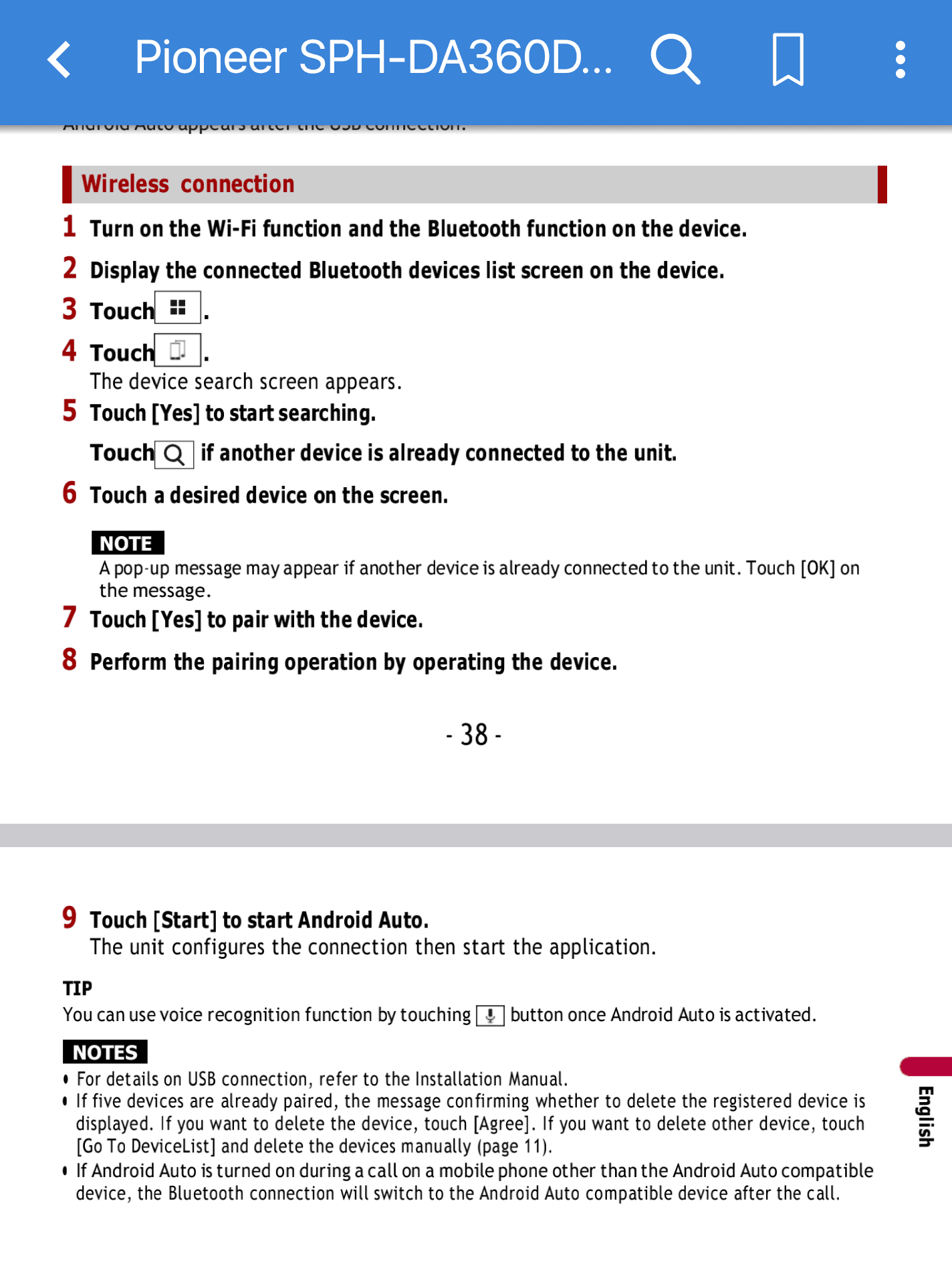

Thanks. So the connection to wifi isnt via the usual phone wifi connection way? It has a wifi name and wifi password...
I first turn on the radio, let it fully boot up, and then the phone's WiFi. The phone should detect Pioneer when you do a search. Mine is an old unit in which I use a wireless display adapter via USB port behind the radio.
