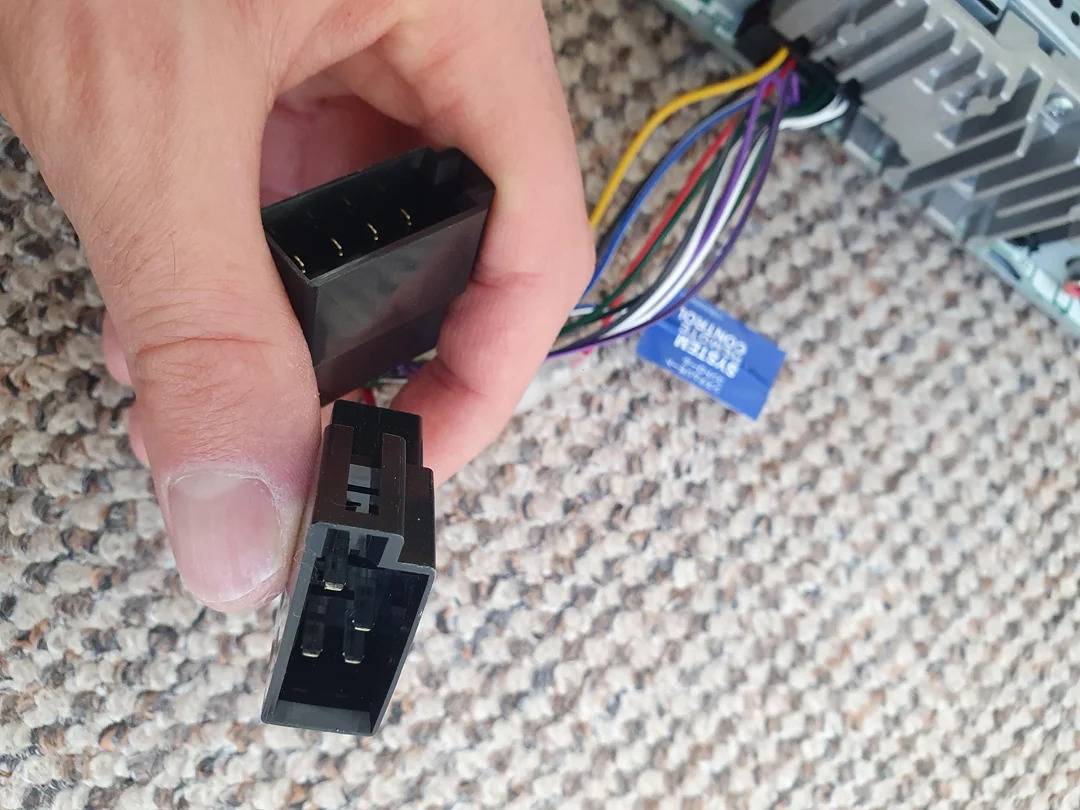

As I understand it, the Peugeot 207 has a 'quadlock' connector to its head unit. I cannot find what exact harness / adapter I need for the Pioneer unit to fit this. I have what I think is a Pioneer to ISO harness from my previous car - see pic below. So that might help somewhere along the way?

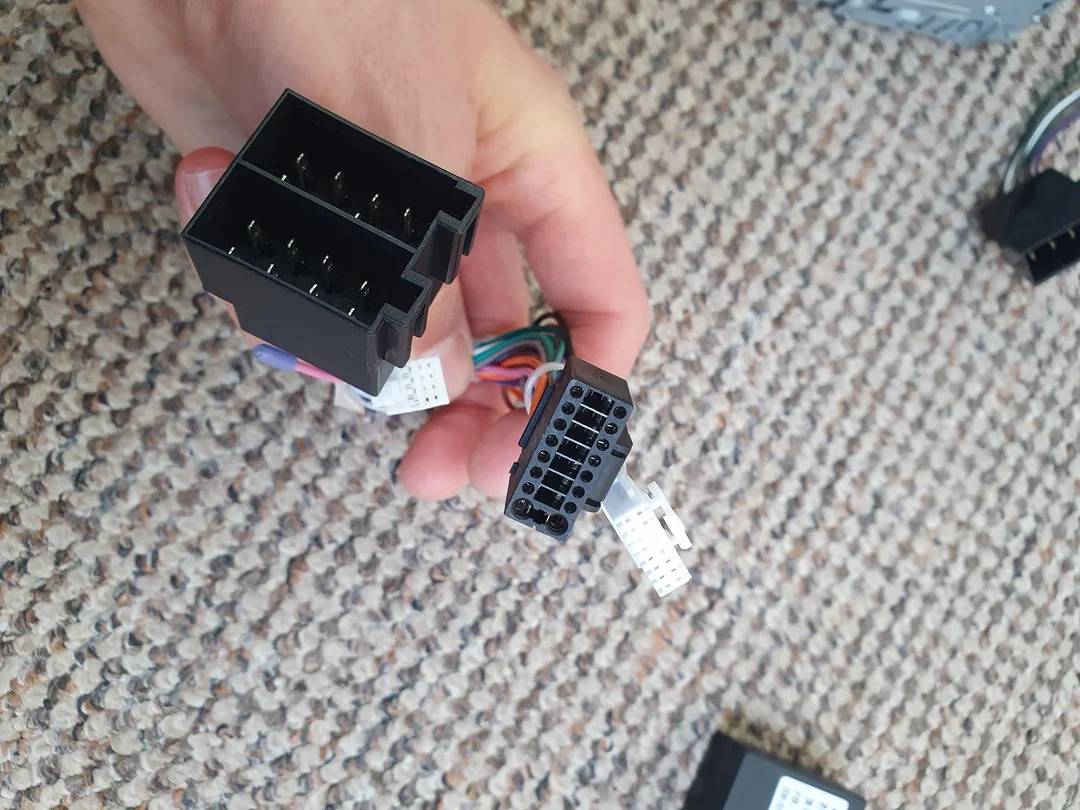

I also bought a Quadlock harness from AliExpress, but this does not fit, as the connectors are the wrong way around (they should be 'inputs' instead of 'outputs' - also im not sure they even match up with the quadlock in my car):

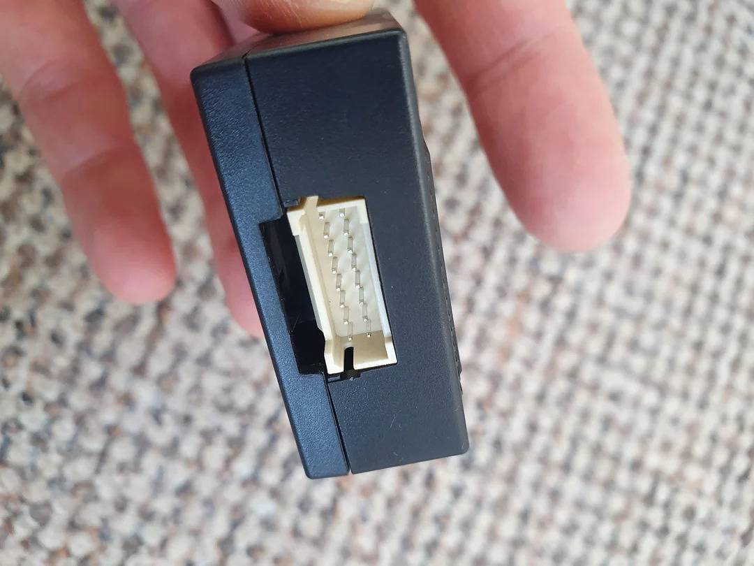

In that AliExpress kit came a Canbus adapter, listed for my vehicle, which I hope might work.

- **Quadlock to ISO Adapter:** You will need a Quadlock to ISO harness adapter to connect your Peugeot's factory wiring to your Pioneer unit. Look for an adapter specifically designed for the Peugeot 207.
- **Steering Wheel Control Interface:** If you want to retain your steering wheel controls, you will also need a steering wheel control adapter that is compatible with both the Peugeot 207 and the Pioneer MVHS420BT unit. Brands like Connects2 or Autoleads often make these interfaces.

- **Wiring:** Connect the ISO harness from the Pioneer unit to the Quadlock adapter. Make sure to match the colors correctly (usually, the manual will provide a wiring diagram).
