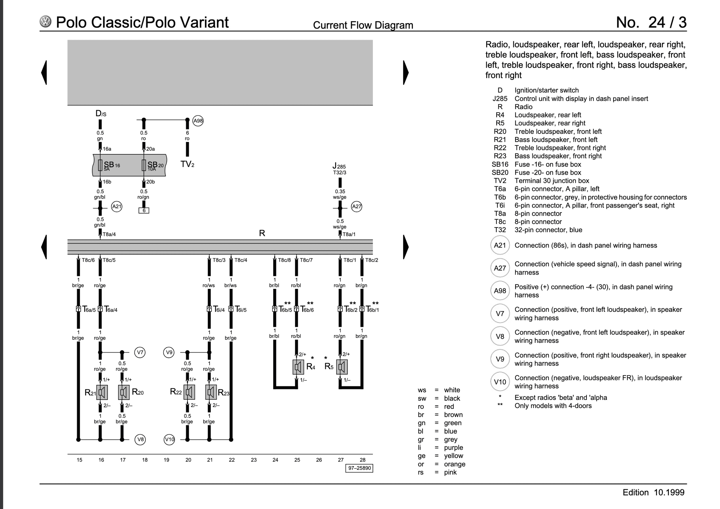

Hey,
recently I installed the Pioneer SPH-DA250DAB in my Polo 6N2 with 4-doors and now I want to get new speakers.
(I know I just installed an 300€ head unit in a car that is valued like for 1000€ but this was my family car for 24 years and this car is my biggest love and is now my daily driver and I want make some upgrades because this car deserves for his service and 400 000+km)
Below is the wiring diagram.
This diagram is making me a bit confused.
First, I don't know what they want to tell when they refer the speakers as loudspeakers.

It sounds like you're excited to enhance your Polo 6N2's audio system! Let’s break down your questions to provide some clarity.
### 1. **Loudspeakers vs. Speakers**
The term "loudspeakers" in the wiring diagram simply refers to the devices that produce sound, typically including the components that handle different frequency ranges, like treble and bass.
