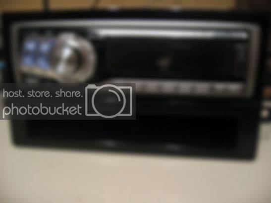

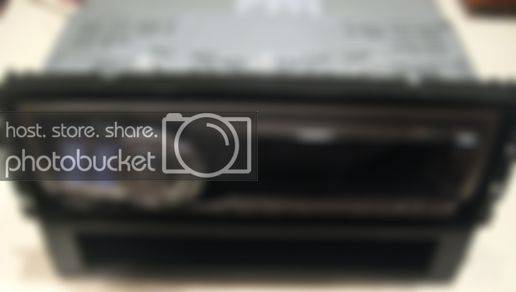

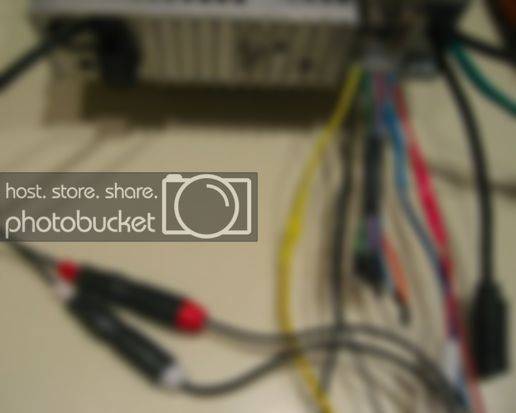

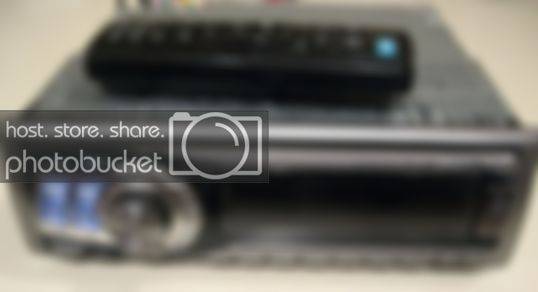

The Alpine CDA-9831

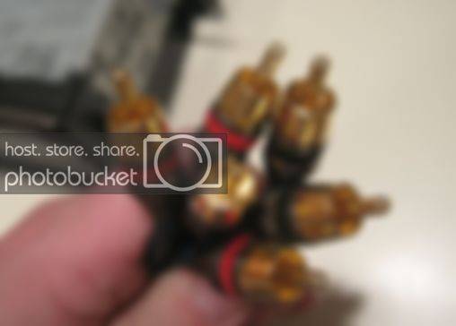

All connections have been soldered and insulated with heat shrink tubing. The small +/ - leads and Rca's in the pic are connected to a PAC IC-AV universal IPod adapter.

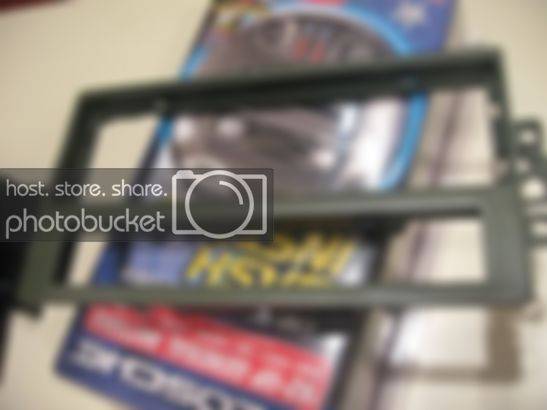

I ended up using a cheap dash kit but wanted it to look a bit different from the norm so I sanded it smooth and painted it satin black. I'm not really sure about permanently modifying my dash so this is the best its going to get for now.
Here it is painted.

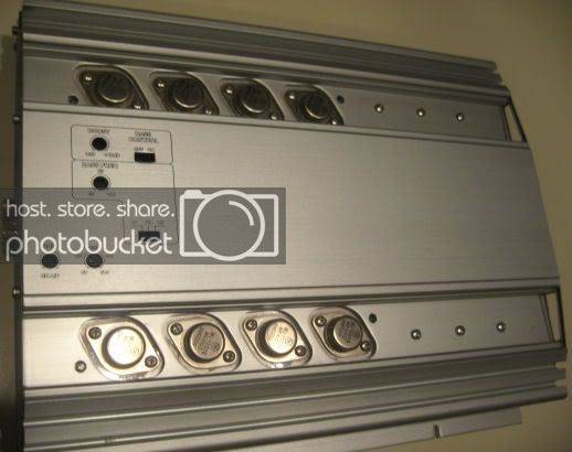

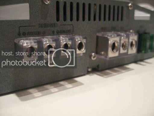

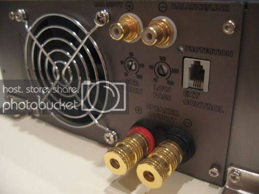

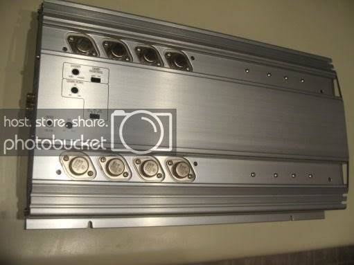

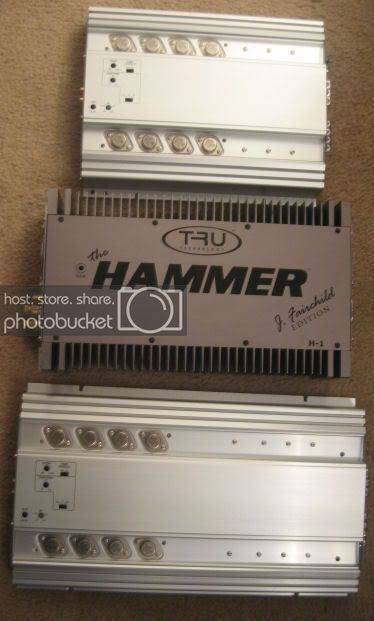

Here are some amp pics

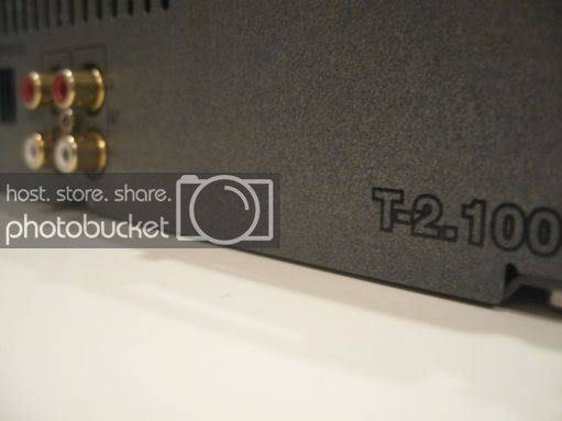

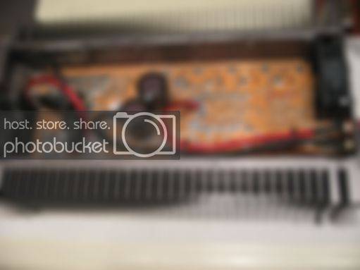

Tru T-2.100

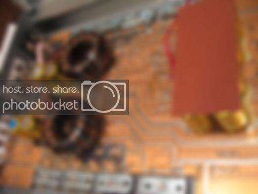

Most of the internals are on the back side of the board I just did not feel like taking it completely apart.

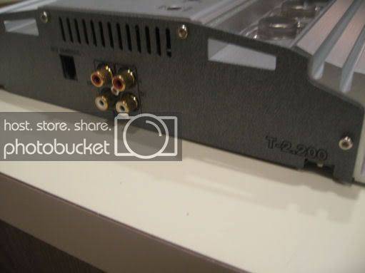

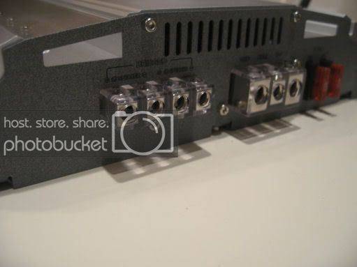

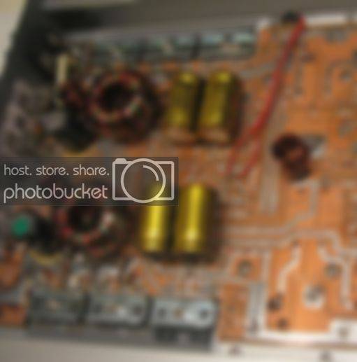

Tru T-2.200
Same as on the T-2.100 just did not feel like taking the board out of the heatsink

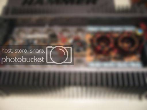

amps continued:

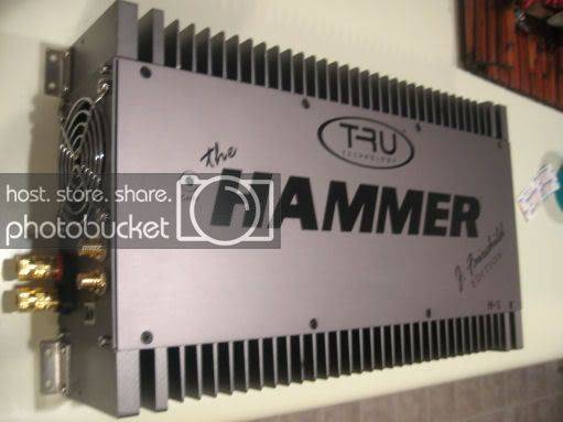

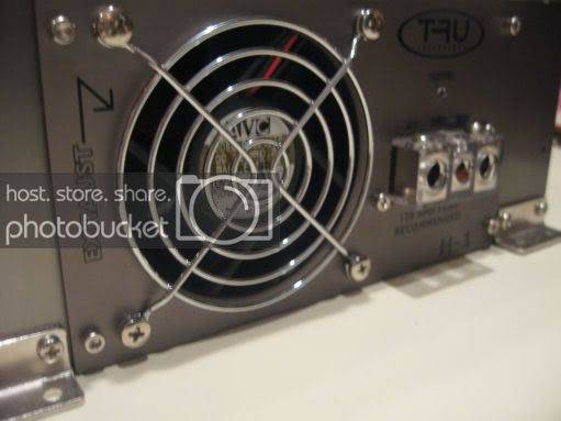

Tru H-1 Hammer
Still trying to figure out how to make the three of these amps look right together on a rack.
(It bugs me that they are different colors).//content.invisioncic.com/y282845/emoticons/frown.gif.a3531fa0534503350665a1e957861287.gif
