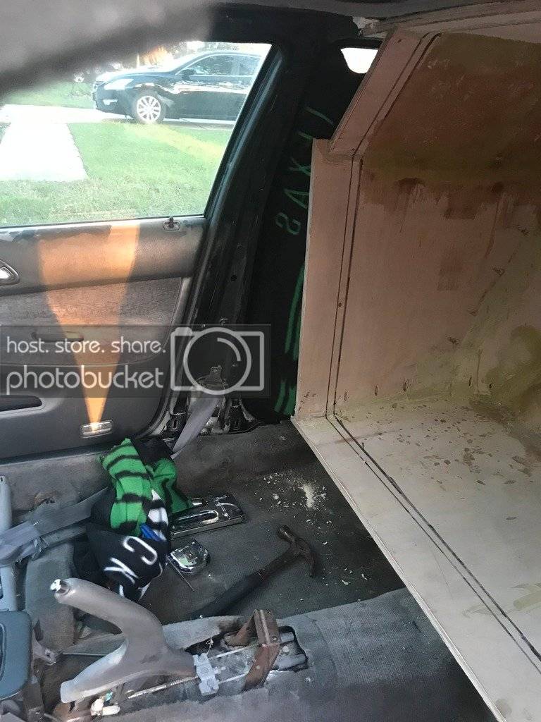

Lots of trial and error that’s for sure!
That's about the only way to get those oddball shapes/angles. Very tedious.
Got ya. Thanks for the tip. I’m planning to add some metal rods going from front to back and side to side. I’m hoping that will help as well
I'm not sure how much power you plan to run but I don't think the 1.5 layers all around is anywhere near adequate. You had better be planning a spiderweb of bracing in there.
As of right now I’m planning to run 2 4ks. I’m currently going to run 1 until I can get the 2nd one. I do plan to add a lot of bracing inside with metal rods. I’m hoping that will be enough. In the future I do plan to upgrade from that set up but it will probably be next season
You cannot possibly have too much bracing/layers. As strong as you think it will be it will probably still be losing output from flexing.
That’s what I’m assuming as well. I ordered some threaded rods and will find out how that helps and see if I need to keep adding from here. So far I’m planning to add 4. But like you said I’m probably going to lose due to some flex somewhere but I’ll find out when I get there. Right now just hoping to have a musical Car that I can run

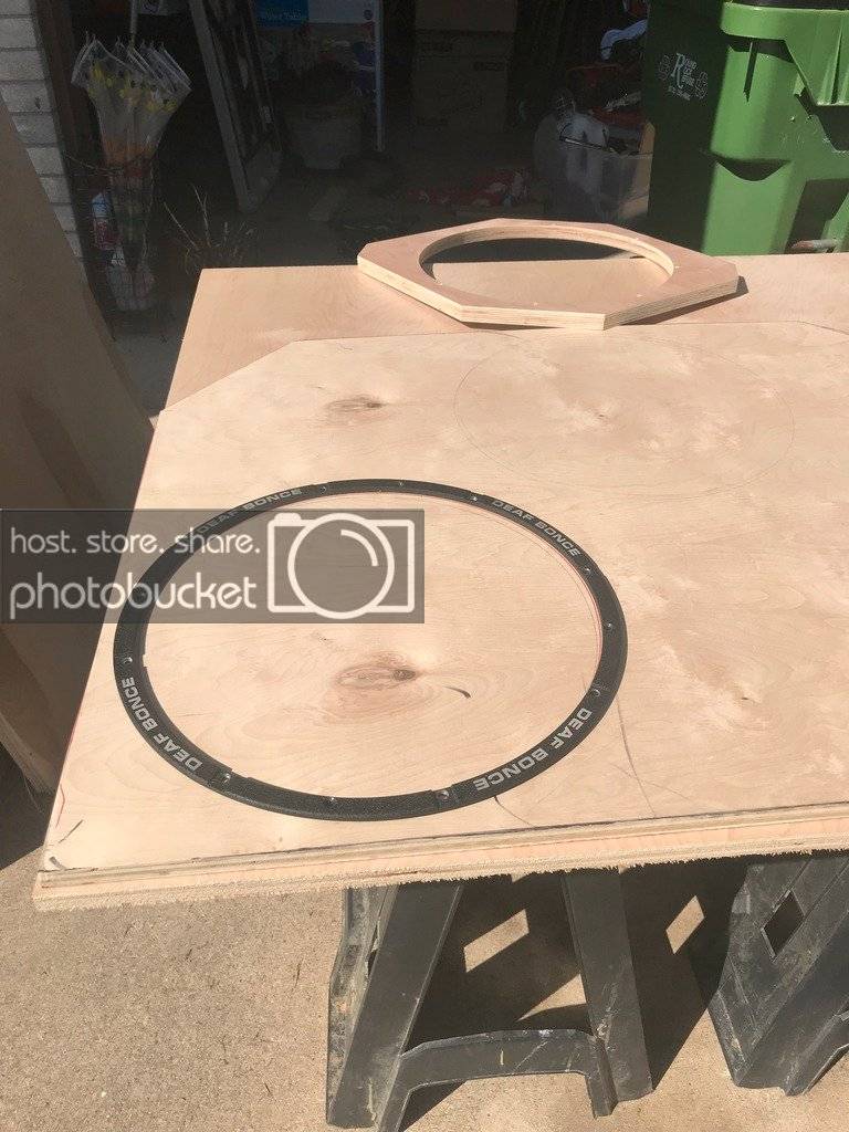

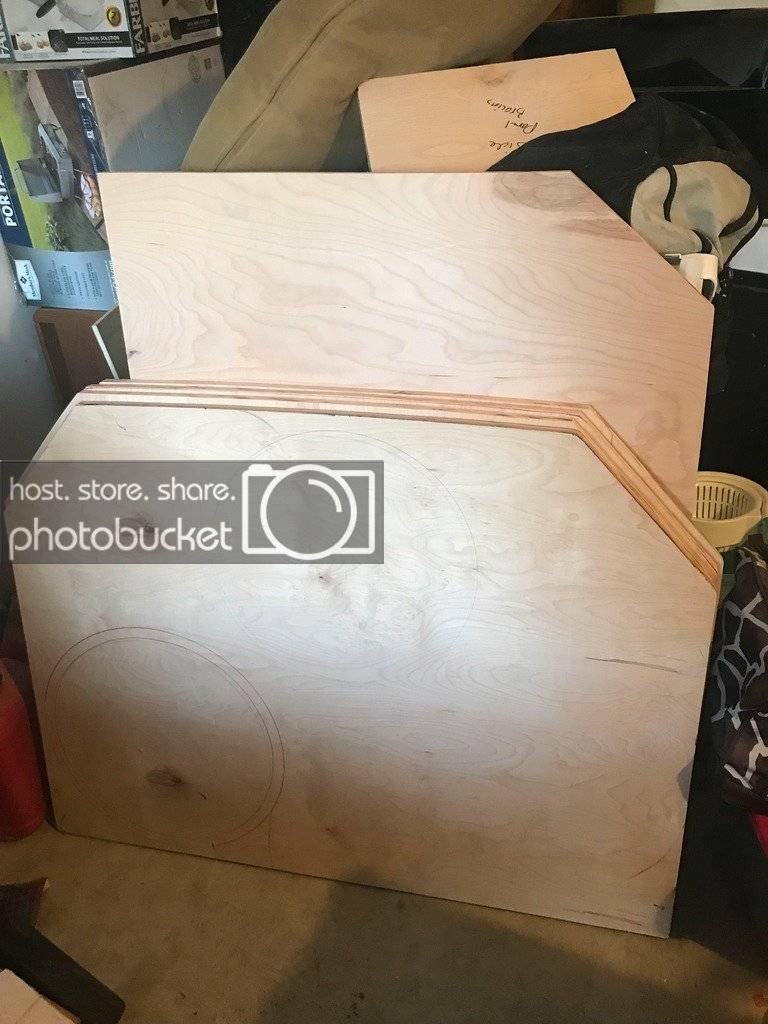

So after talking to some teammates and some convincing I’m switching from 2 18s to 4 15s. So I stopped where I’m at on the baffle since I’ve only cut the shape to fit into the box and not the sub holes or port and will keep going once I finish the sell of the subs I currently have. Once I get those funds I’m planning on getting the dbsa2715s

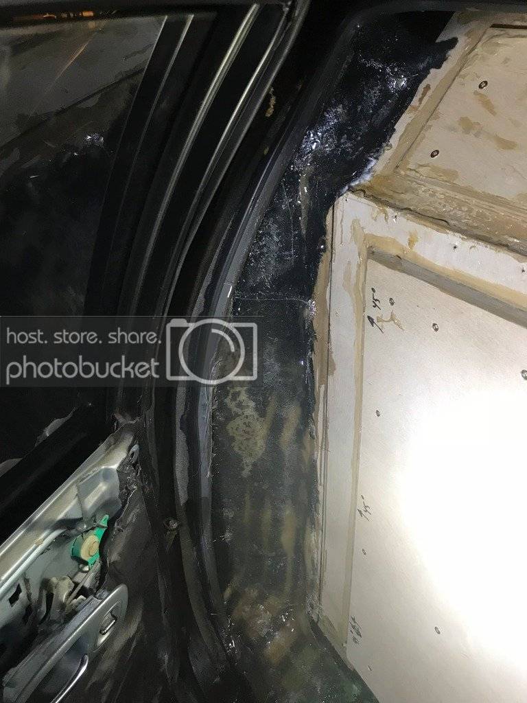

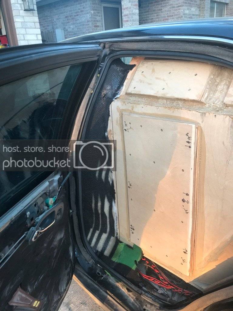

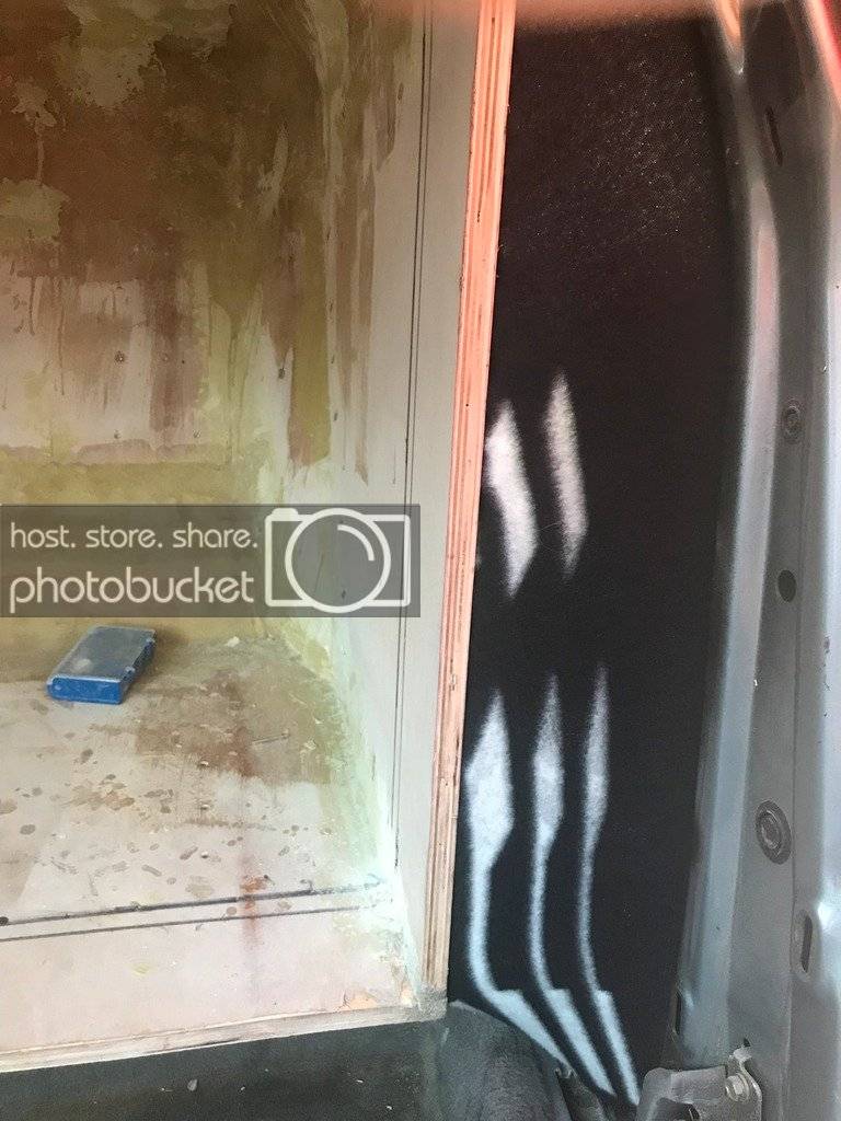

So currently I’m working on sealing the b pillar
So I have the pieces ready to glue down and cut out sub holes and start port just need to wait to order speakers spoken, hopefully in the next couple of weeks. And I’m currently 3 layers of fiberglass and resin in and still planning to do another 5 of both or until I’m happy with it.
I know this sunroof is going to be a pain but any ideas on bracing without going past b pillar? Going to try and be in modified in usaci and nothing can be modified past b pillar
