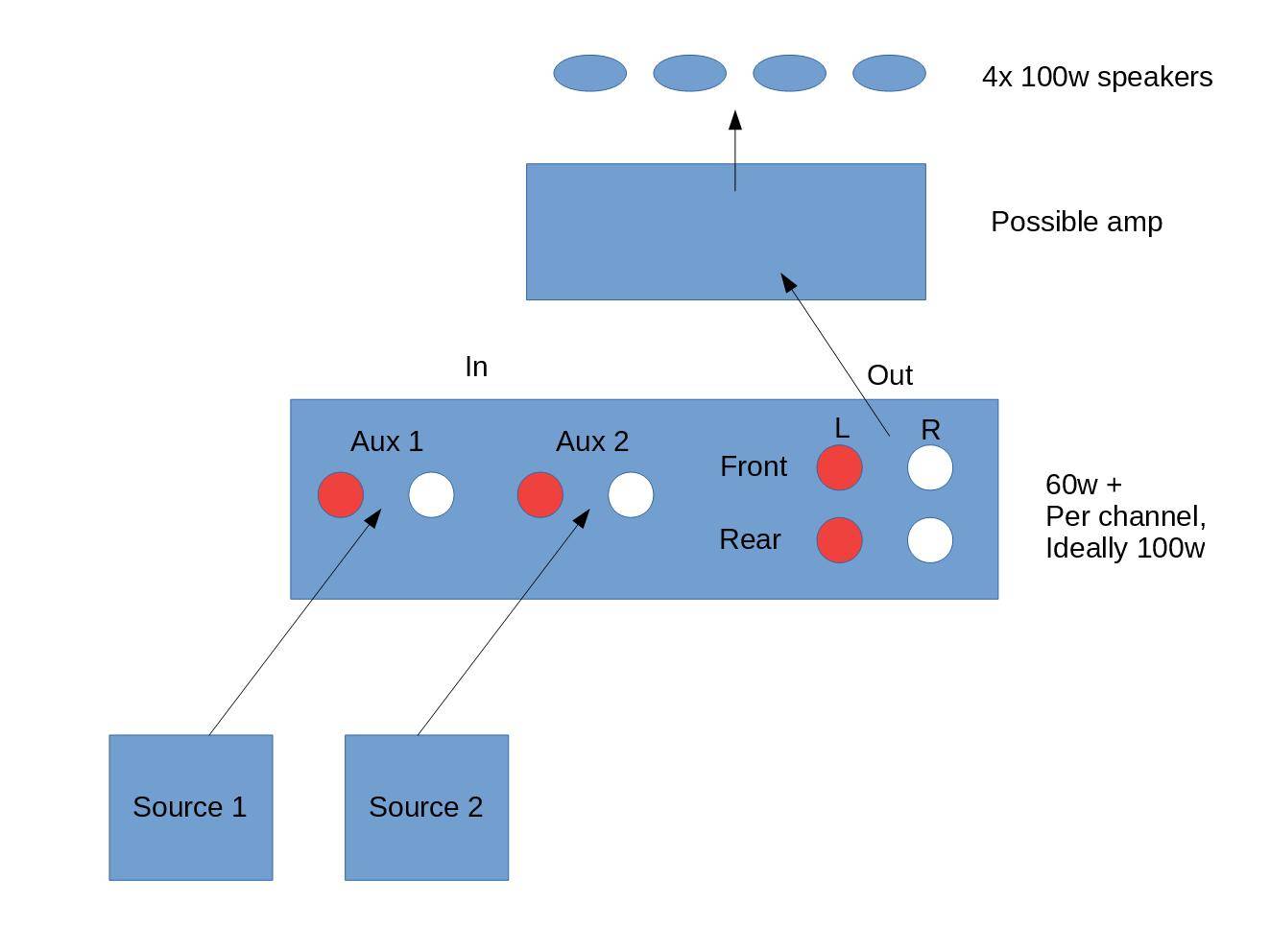

Noob question: how do I build this simple set-up?
I'm looking to replace my head unit and it seems my old Alpine CDA-9832RB, rated at 60w per channel, was one of the more powerful units on the market. I have Polk Audio MM651 UM 100w speakers so ideally I am looking for a head unit with 100w per channel. If this is not feasible/cost effective, then I could look at an amp, but I live on a boat and power consumption is an issue.
More to the point, the unit needs to have two aux inputs (RCA) so either of them can benefit from the four speakers. The Alpine uses a KCA aiNet box that allowed me two separate aux inputs that I could control from the head remote, but I don't think Alpine make head units with the aiNet input any more (is that correct?).
I'm after something like this:
The two sources are two PCs, so they'll be RCA connections.
Questions:
1. What recommended head unit is rated at 100w per channel, with four channels and two aux inputs?
2. If head units don't come with 100w per channel, is there an alternative to the Alpine ai-net splitter out there?
3. If I buy an amp, can I by-pass it by not switching it on? That is, does the audio signal pass through the amp without being amplified?
4. Have I got my maths right with the wattage rating, or is 60w per channel the max I can go with 100w speakers?
Any help appreciated, thanks.
Your old alpine wasn't actually 60x4. Head units are normally limited to 10-15 watts per channel. The 50x4, 60x4 are more marketing gimmicks of the power it can produce for milliseconds under optimal conditions. That being said if you were happy with it's output any headunit will probably do. If your input is from computers could you use usb inputs? Many head units have usb inputs and aux inputs.
What he said. I've never seen or heard of a head unit exceeding maybe 10 or 15 watts per channel. That 60 was a "max" rating, almost for sure.
If you're worried about current draw, use a class D amp. They're more efficient. For example this one:
Alpine MRV-F300
50x4 at 4 ohm class D. Shouldn't drain even the smallest charging system.

No head unit does this. You'll need an amp. There are plenty with more than one USB input, but not both on the front. Similarly there are plenty with 1 AUX on front and 1 in back, but not both on front.
Not that I know of. There may be some sort of Y-connection which can take 2 AUX inputs into one, but obviously you won't be controlling that with a remote.
No. If the amp is turned off it won't output any signal. You can set the amp gain to 0, which will cause its output voltage to equal or be very near its input voltage, ie no amplification. This could be achieved with a remote gain control knob.
You can go at least to 100 watts with 100w RMS speakers. You can probably safely exceed that by a little.
See red text answers.

Apologies if my diagram confused you. The two aux inputs are not at the front, I was looking for something I could plug into from the back.
The two aux units are computers, one to run movies and a low powered mini stick pc to run music (this would be on most of the time). Currently I have one nuc doing all the work but I'm trying to reduce standby power consumption.
