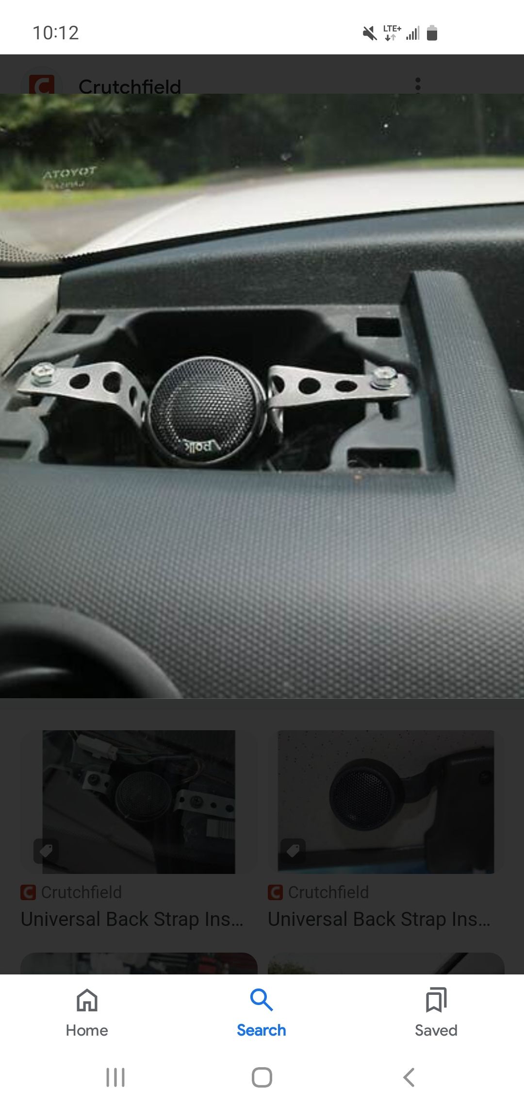

Thanks for the advice. Any tips on how to replace the 3.5s with tweeters? I know the wiring is the same but mounting a tweeter there seems like it might be too small to fit in the cutout.
If your mounting it behind the stock grille then you can do the same thing or make an adapter out of 1/4" MDF
If its behind the grille then you won't be able to see it of you paint it black
Not that there is anything wrong with using ABS.
I just hate cutting it for some reason plus its not that easy to get around here and I have no patience for ordering online when I'm mid project
Thanks again, my plan was to not use any 2-way speakers expect the 6.5”s in the rear doors. So if the 5.25”s in the front doors did not have tweeters, do you think 1.5” dashboard tweeters wiuld be enough? My only concern is lack of a driver in between those sizes leaving out that frequency range. I could also consider putting the 6.5” two ways in front and the 5.25”s in the rear. Do you think the full range would proper representation then?
I don't have any pictures of mine, but here's an example.
