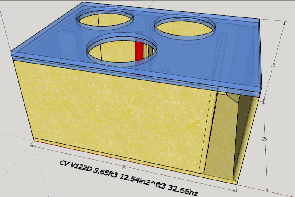

I put the T/s specs into Winisd and used this enclosure and it looked pretty good to me... Imagine that... lol
That looks simple enough. Yes the whole setup is low buck mainstream garbage. The next build will be with quality equipment. I want to get my feet wet with this build as I get more comfortable with car audio. Sure I could buy a high quality Cerwin Vega - Stroker Pro with a Crescendo amp but I'm trying to do something a little different here. Its hard for me. lol

With 28"Lx36"Wx18"H available you got room to spare for a set of 12's... that was just an enclosure I used to see how it modeled up around 2ft3 net per and illustrate the size... pretty small IMO with that round port.

Top firing with 1 or more ports facing the front or rear of the vehicle. I just want the most subwoofer I can get in a enclosure of that size. I'd prefer 3 12's but if that doesn't work. I could do two 15's or one 18.
Spitballing huh?... once you decide the equipment you'll use I'm sure someone can help you better.
28"Lx36"Wx18"H = 9.75 gross... there's probably room for 3 12's there... that amp tho... lol...  got clearance to the tailgate with those measurements?
Yes. 3-4" inches rearward to the gate with 12" available front.
Spitballing could be the word; I'd prefer flexibility. Original goal stands but I have limited experience here. I could throw something together solo but I'd prefer to maximize the available space. I have plenty of money so I could buy different subs, provided there is a reasonable argument but I'd prefer to use 3 of the V122 CW 12" subs that I started with. Amp is easily upgradable, lets not get bogged down on it   :p

...So If I'm understanding this correctly its 28" available front to rear (depth) with 3-4" to the tailgate?
36" wide and 18" tall

Total overall length in the rear is 42"  x 36" width x 18" height. My thoughts were to leave enough length for a battery box to the front. If the extra space is needed for the box, the batteries will go else where

 I'm looking for a box design to meet three 12's in a maximum space of 42" Length x 36" width x 18" height. I will pay for a box design that meets my simple requirements; I'm flexible (provided a reasonable argument) to meet my goal of a top firing box with options of two 15's  -  or one 18 to any one that wants to design it.
