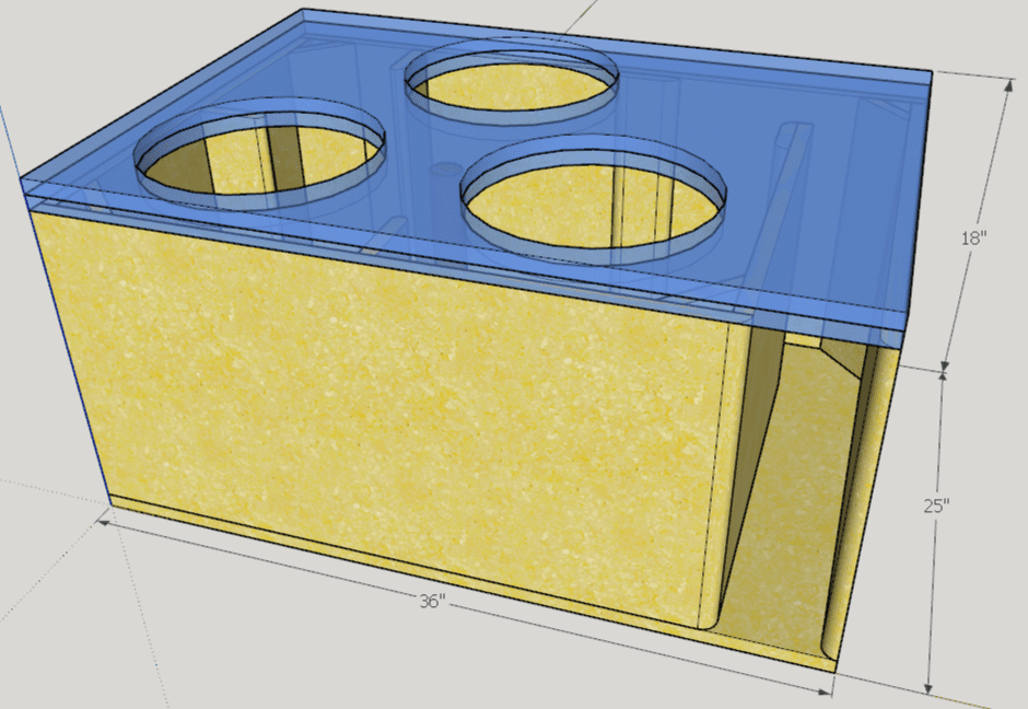

IDK if I'd assume you got 3200 watts on tap... but I came up with this.
I would flip the v shaped configuration around so there isn't a sub so close to the port.
Easy peasy...
Yes, it'll be better like this... Thx

I know designing boxes requires time to tune correctly so I'm going to condense everything down to this post for you to make it as easy as possible!
 At some point, we need a clear way to compensate you for your time and troubles. $200+ seems fair but we can figure that out when its done. Can't remember if I said it, but thank you for taking time to help me with this. I really do appreciate everything that goes into helping an internet stranger. I've spent a good deal of time over the years helping others on many forums so its nice to see there are plenty of people out there still willing to help.
  • Vehicle: 92 Jeep Wrangler Hardtop with no doors
  • Big 3 - 200a alt. (on order) - 1/0ga wires - 3 batteries - 3 300a fuses
  • box size: 42" Length x 36" width x 18" height (height: up to 24" if you need more volume) I'd prefer two ports for symmetry - If one is better, just put it in the center if possible. I don't care how complex it is, I have a woodworking shop in my basement and a whole winter to build this.   :)
  • Amps: Rockville DB16 2000w RMS (x2)
  • Subwoofers: CV st154d (x2)
