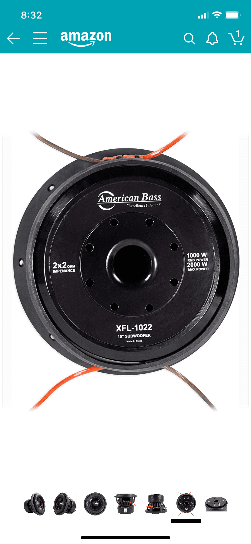

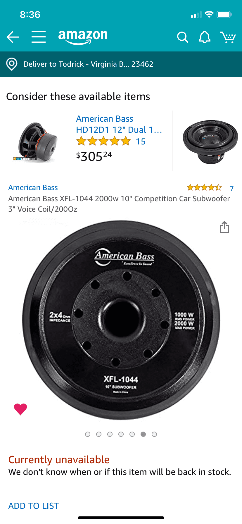

Alright guys so I’m gathering everything I need to buy and I was gonna buy the sub of amazon but the no longer have it . On the site that was recommend the sub says this on the back the left picture and on amazon the sub is actually listed as a competition sub and says this on the right picture. I should get the competition sub at 4 ohms like recommend? On amazon it dosent give you a choice of picking 4 ohms but it says it on the sub but on the website it does give you a choice but doesn’t say it’s a competition sub. Just wanna know if it matters hope this makes sense.
