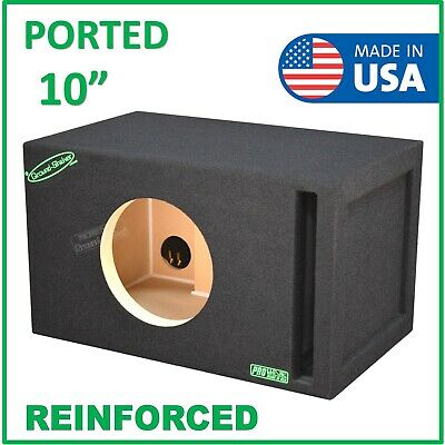

Went a little over Budget here.. May get the 4 ga by the foot as needed rather than a kit... Tuned enclosure Bought is a killer on the budget as well. Maybe look some more on this to stay in budget.Never Skimp on the Distro blocks or Fuse blocks.. Always get good solid quality.Anl fuse holders are pretty Durable/ bullet proof and hold tight
You may have to file some edges off to get that sub in there but It will work, and bring you back to budget. Or you can call High Output Enclosures and see if they can make you one at bare bones. I think Buck is the one that makes the H.O.E. enclosures if Im not Mistaken.He may have something lying around that he can work with you on as well.
Thank you for all the information it’s very informative and much appreciated. For the sub would I go with the 4 ohm?

Box - $150
audiobahn recommendation . Yish that’s an expensive prefab I bet if you checked your local craigslist or let go there’s a guy near your that builds enclosures who could shave that cost for a bare bones box
