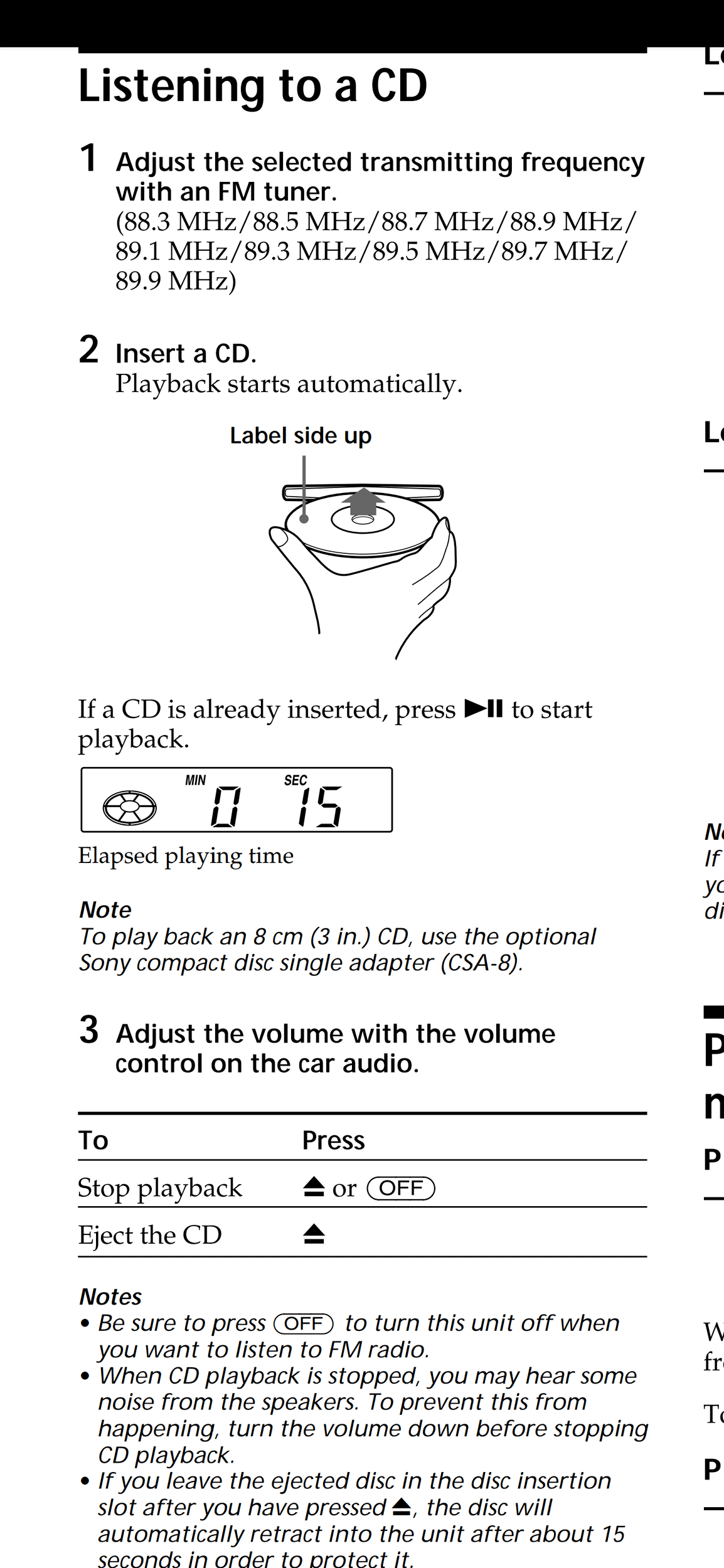

since then i've gotten a cassette-aux converter that gets the job done, but i was hoping to be able to use the cd player to listen to some that i'd kept around. so far, i haven't been able to get stereo to recognize the cd player as a possible source for audio, meaning that i can't even play with the volume to make sure it's working. it seems to be reading the cd just fine, but it won't register the cd part of the system aside from that. i've found both manuals and searched for resources on them as individual parts and as a set but nothing has worked, so here i am.
According to the manual, you must select a specific FM frequecy to lusten to a cd. Manual also states that if battery disconnect or any such power loss has happened, you must reset radio by poking a small button with a ball point pen.
