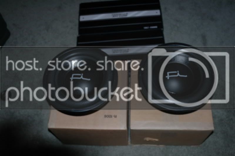

So, looking around at the time I decided to get a set of RE SE drivers. I build a basic slot ported box single chamber ~5@35hz installed it and it pounded.. but of course not enough. So I went back to design, built another box dual chamber 3.25 @ 32hz.. much better, so much so that people started asking a little to much about what I was running. These leads to me sell the subs and box a local forum member that gave me almost twice I paid for everything.
Heres a pic of them:

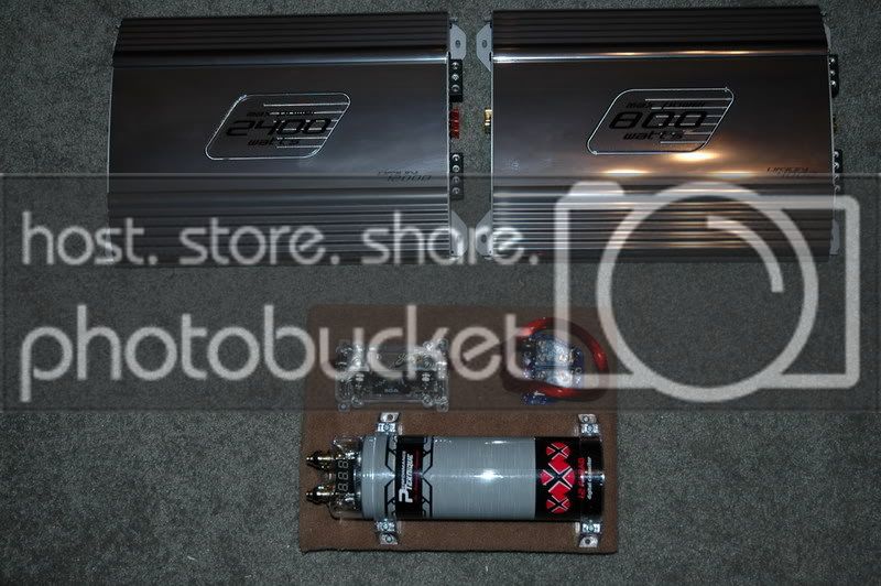

Ironically, when I went to my Jeep the next morning I start it up and no sound, the system what gone. The thieves sure knew what they were doing, did not put a nic on my car and all the wires where still neatly put together. After being pissed for about 2 months now I decided to start over again…
Here is my only memory of that equiptment:

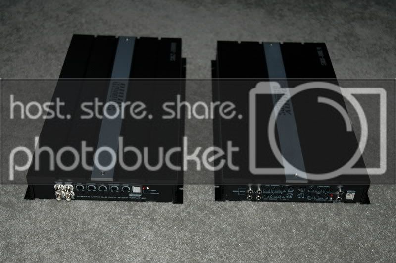

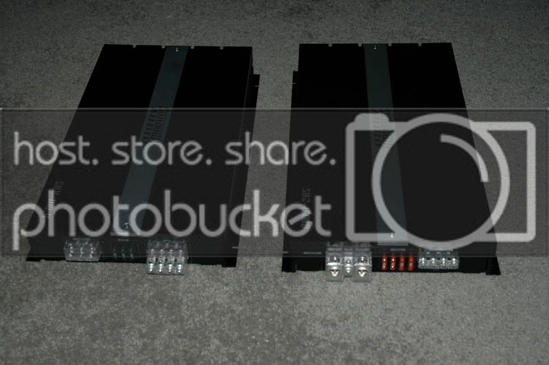

So that what you’re here for, system specs:
(the highs are still the same, 2 Polk Audio DBi 6 ¼ Component sets)
1 Sundown Audio SAX-100.4
1 Sundown Audio SAZ-1500d

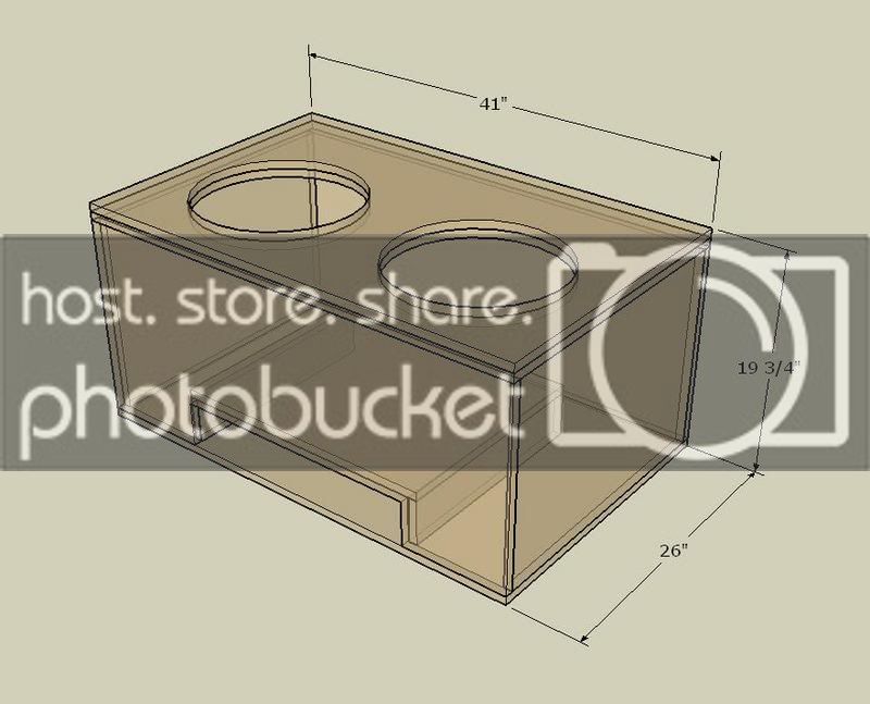

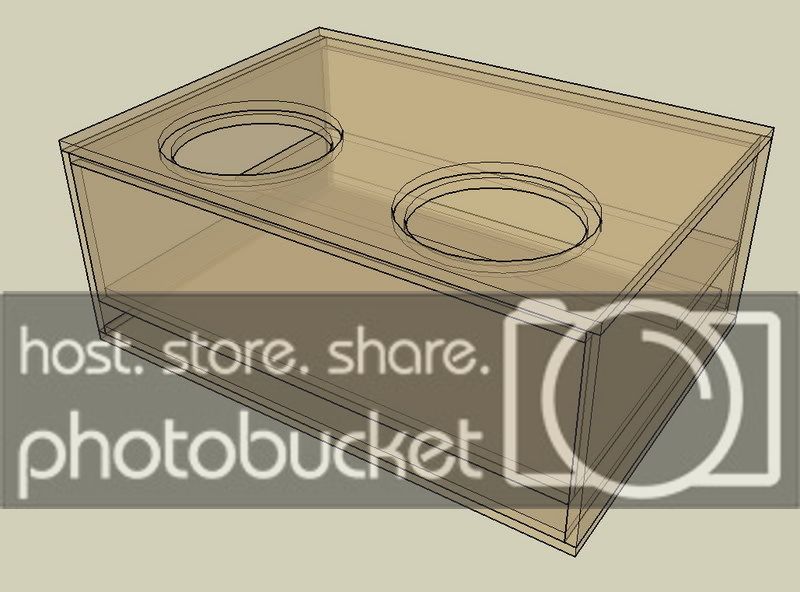

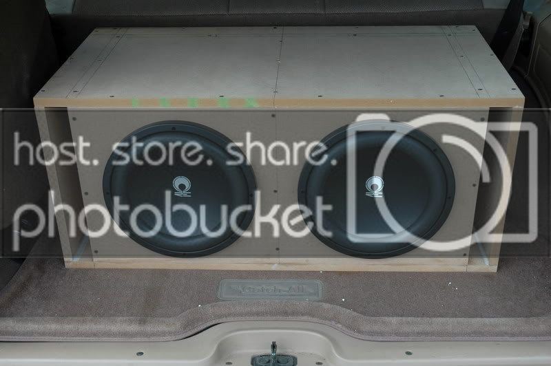

The box design is going to be one of the following:
Let me know what you think;)_

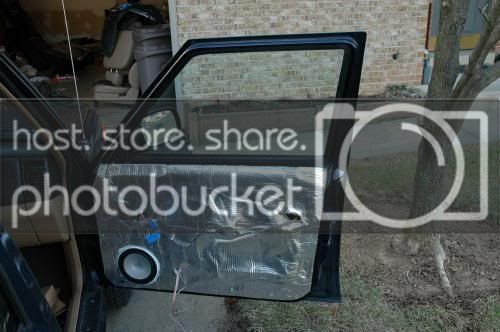

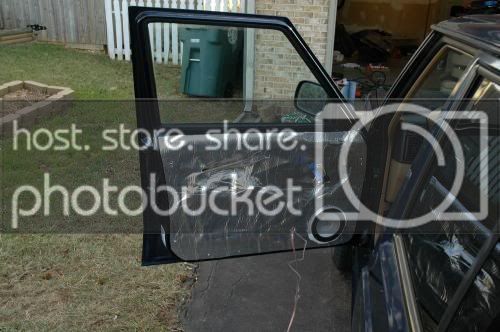

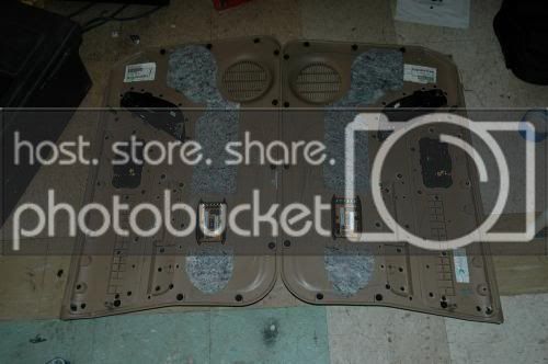

Someone asked to see the component install.
Heres what I have:
Skins and x-over install w/ tweeter
Drivers side:
Passangers Side:
you definatly are putting some time and monies in that car. good for you man. i like seeing somone do a good job and enjoy it.
good looks on the equipment too. im sure you will get a similar sound out of the q's.
as for the box, if it were mine, i would drill some holes through the bottom and bolt the **** thing right to the floor where it will sit with some nice fat washers helping out... i would then make a cover for the amps and screw that down with some security screws, try and bolt the amps to the box - leaving the head of the bolt on the outside.
a bolt something like this
http://www.simifast.com/prodcard/vcb197.htm
that will deterr them a little bit //content.invisioncic.com/y282845/emoticons/wink.gif.608e3ea05f1a9f98611af0861652f8fb.gif
because you know what. if they know where you live now, they have gotten into your car once. they will be back again.
