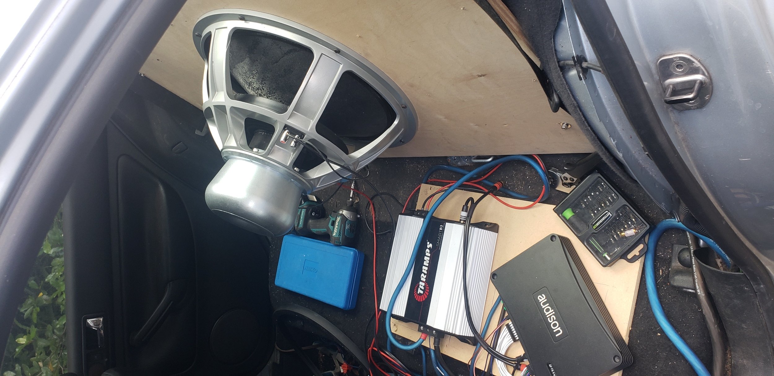

Nah, it was just eaiser to put it in that way for a test. I find it eaiser to gauge Xmax looking at the spider/coil joint. I wanted to see how close to Xmax I could push one of these with the 3k IB. Ate the power up until about 20hz where it was getting close to Xmax.
