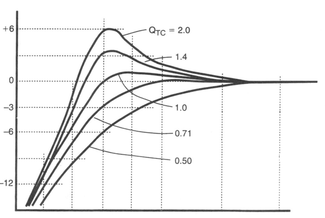

Any sub can be ran IB. They will all sound different. Some people like a system QTC of 707, others prefer closer to 5, some people don't really care at all. Any sub in an infinite baffle system will have its QTS become the "enclosure" QTC value it's pretty simple.
QTC example chart:
