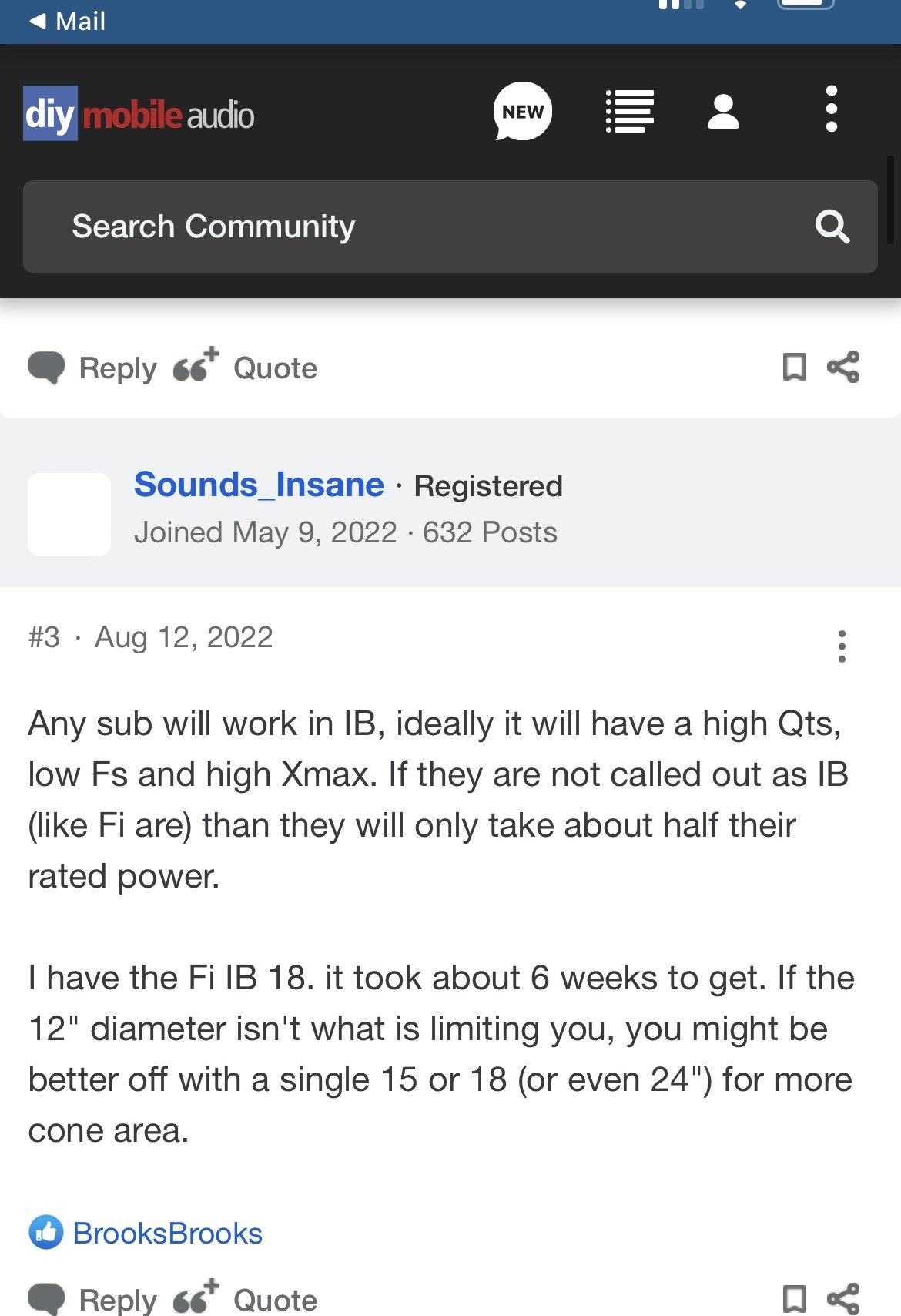

Infinite baffle is on my bucket list!

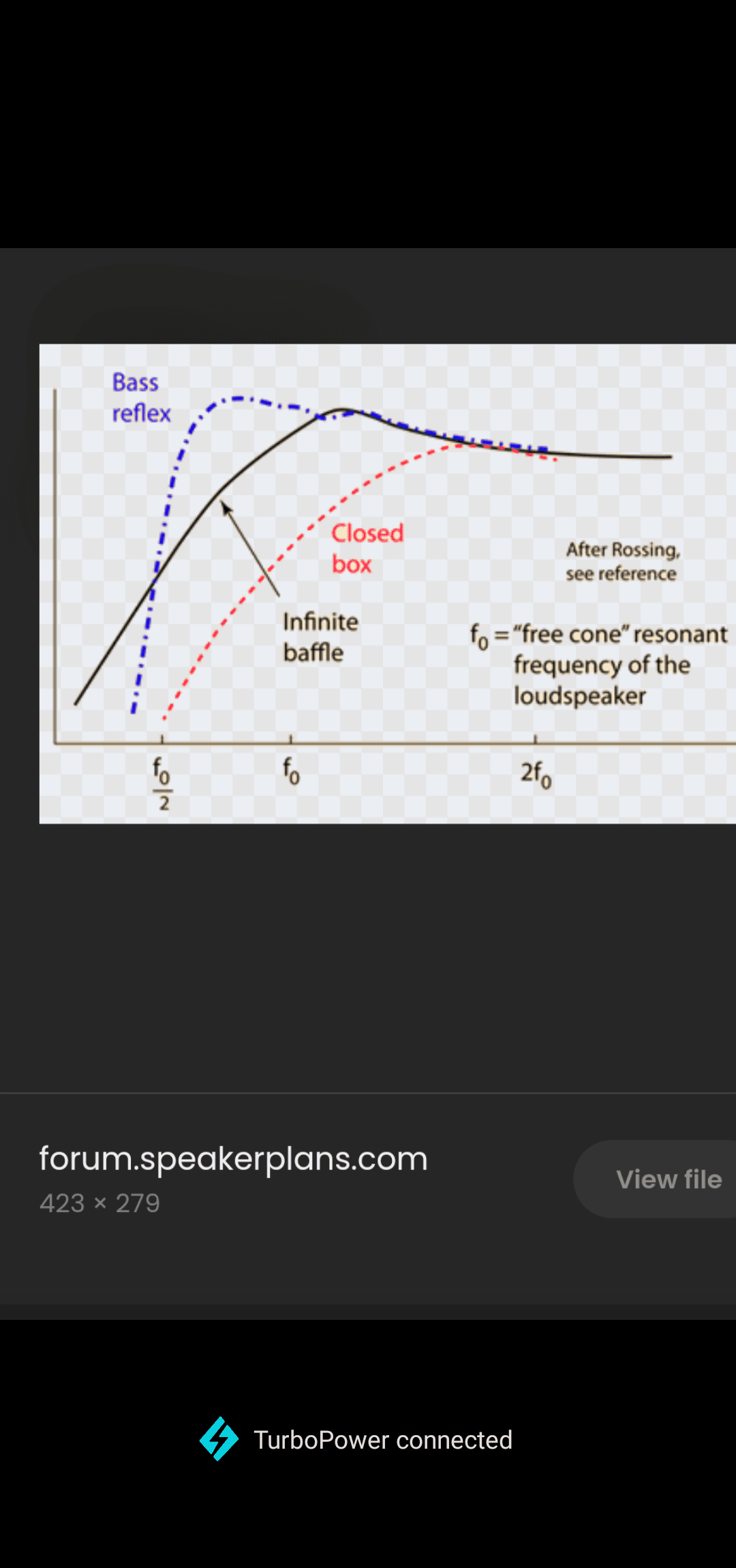

How does the Subs (FS) play into the infinite baffle output?
Looks like the desired curve for me but only satisfied with 28-33hz output!
I read infinite baffle subwoofers need the Qts above.50 as far as qualified specs. Otherwise enclosure is needed.
What's subwoofer are you going to use?
