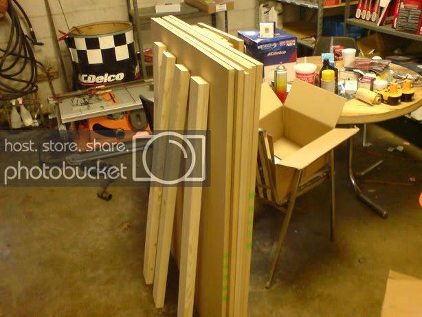

The beginning... I fit 2 x 4x8 and 1 x 4x8 piece of wood in my Integra Hatchback. A few cuts and I was good to go.
MDF

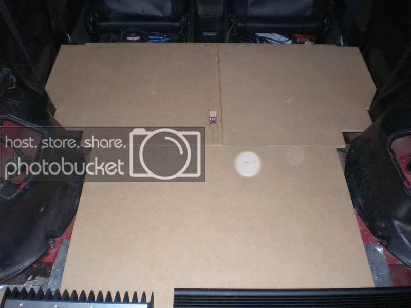

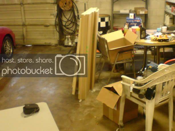

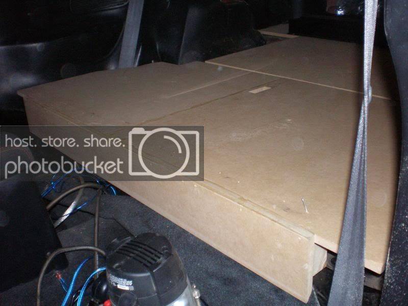

After some measuring, cutting down the pieces into the right sizes. We are finally starting. But first, I needed a new false floor.

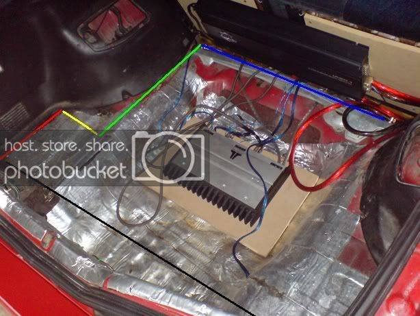

How it actually looks without false floor and with rear seats (I have rear false floor but it was crapppy), BEFOR.
The aftermath, after some hit and miss cuts and measuring.

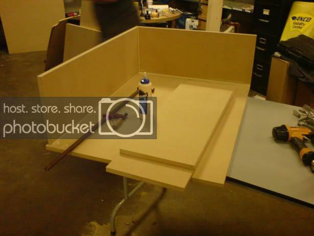

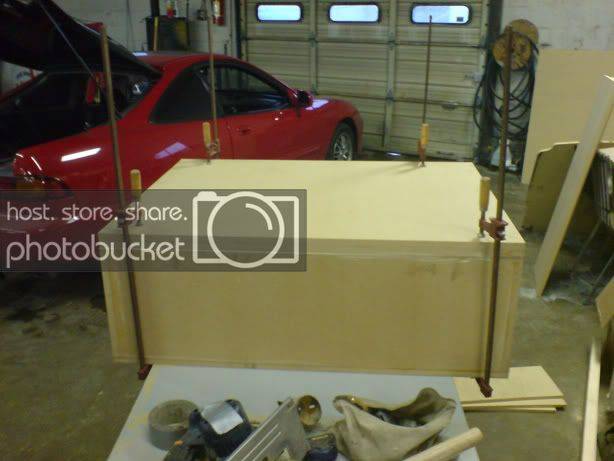

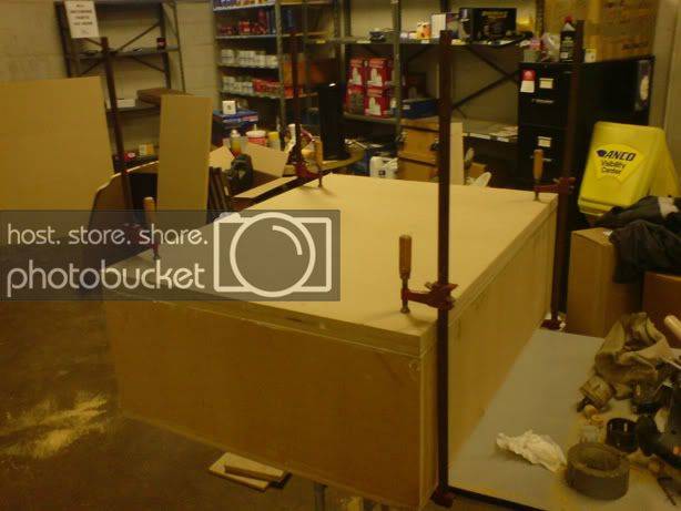

Putting the pieces together, glued/clamped and brad nailed ftw.

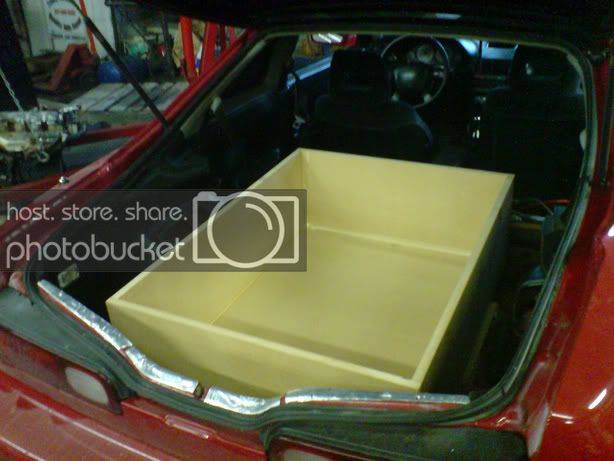

Got 4 pieces put to gether for half the box and decided to throw it inside the car to see how it looked and how big it was.
Finally got the box together and baffle on. Clamping for glue to dry. Might look ugly right now but it'll look better.

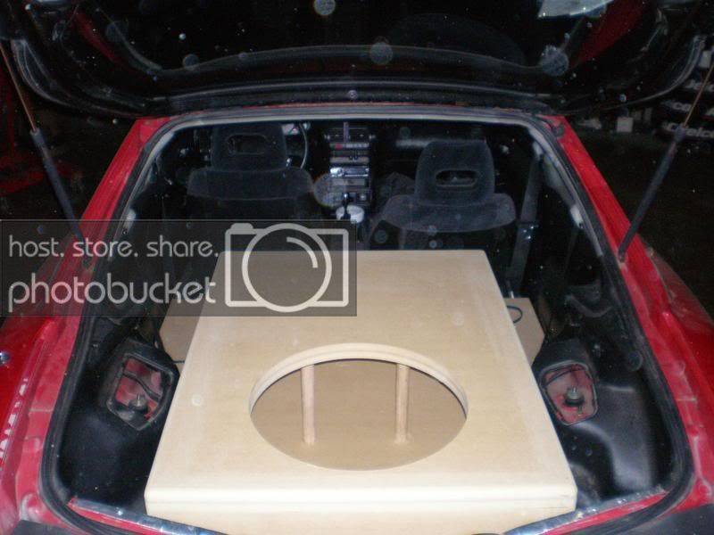

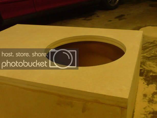

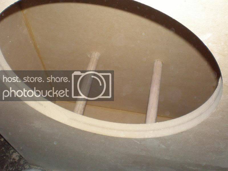

Got the big *** hole cut. I didn't expect the hole to be this big. Double Baffle FTMFW.

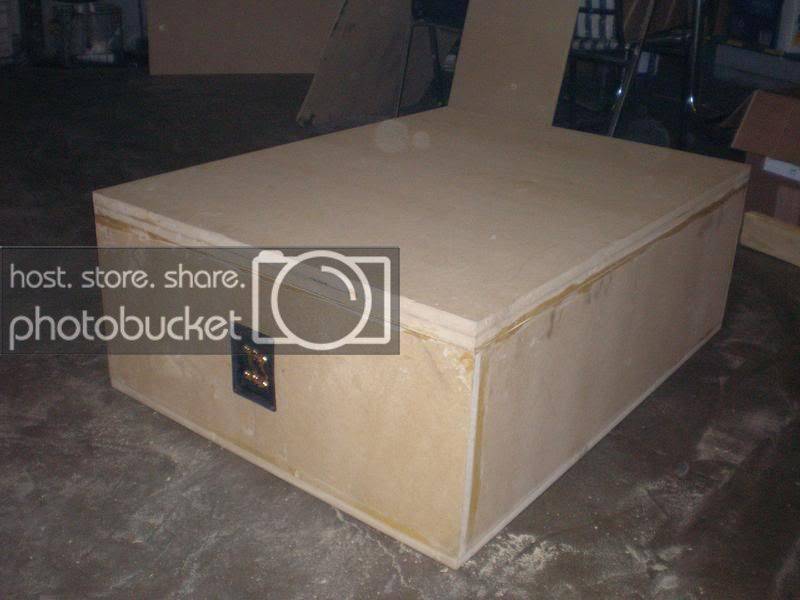

Finally got my Terminal cut, and mounted for temp until I get home and solder on the wires and glue it and screw it on.

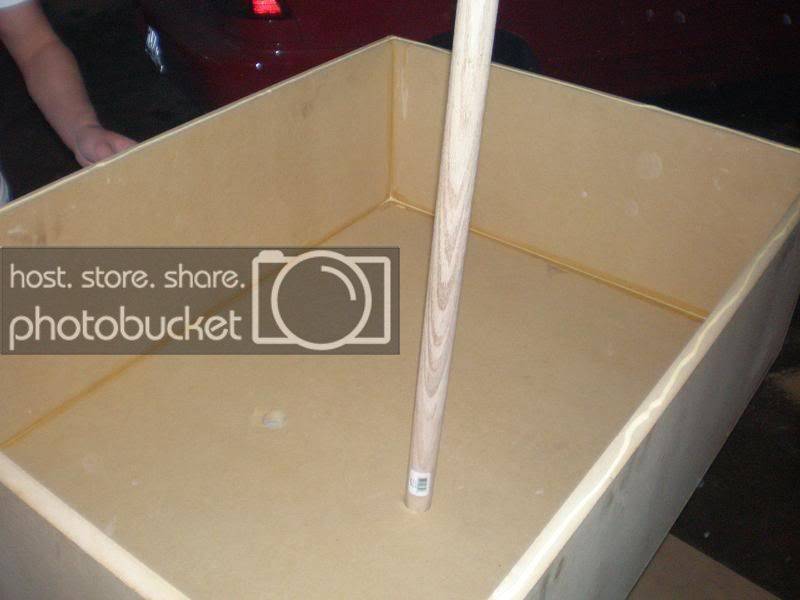

Onto the bracing.

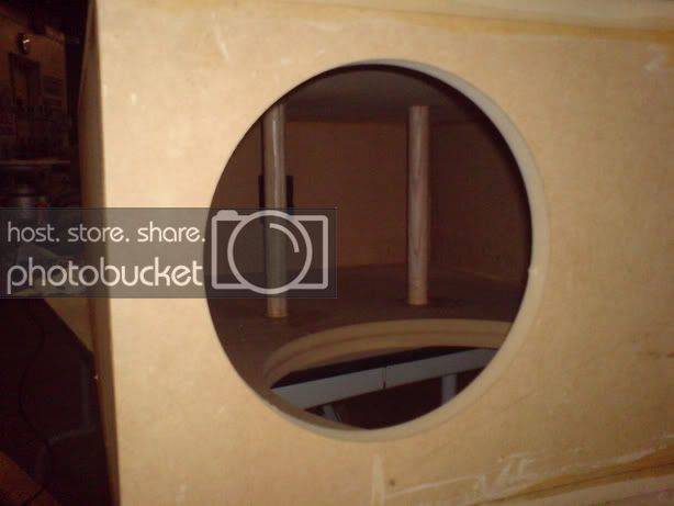

Started to cut the holes for the 1 1/4" Oak Wooden Dowels. (HD biggest one, and Hardwood and Oak Wood, the hardwood one was weak)
Cut the dowel in half and used it as 2.

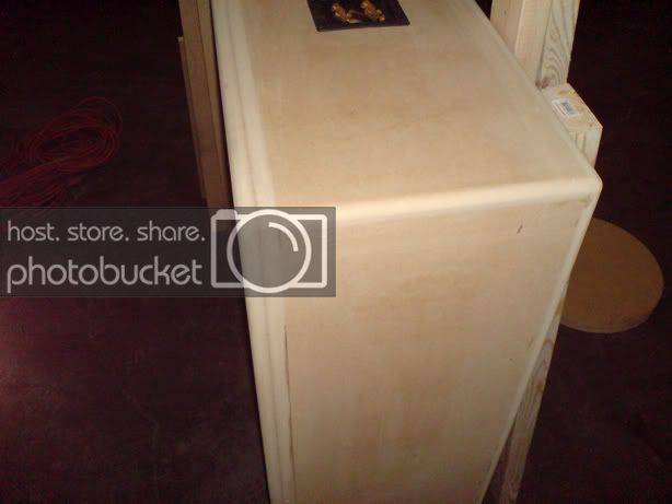

Edges rounded up. Still needs touch up but it'll do.

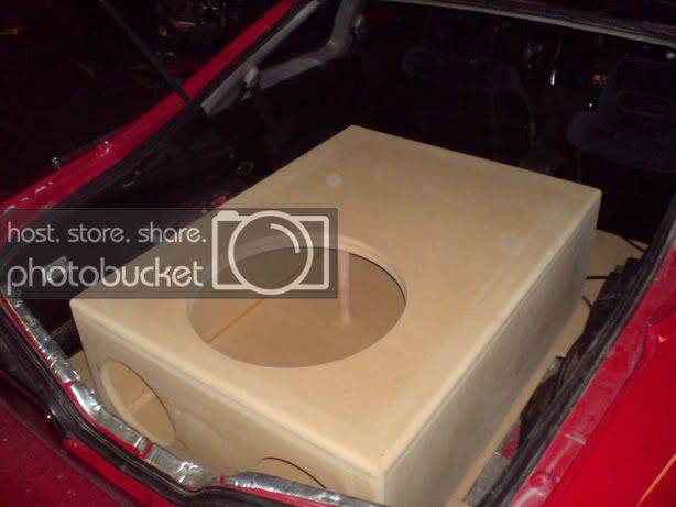

Box finished and in the trunk
Hope you guys like it. Comments/Suggestions welcome.

one question.
why didn't you go with a slot port, it would of doubled as bracing for your top baffle. much better then the wooden rods. but im sure there was a reason for aero ports against slot port. and also notice that the ports are very close to the rear hatch. do they have a good clearance?
just wondering.
again nice build.
I like it alot. Did you cutt he double baffle hole with a rotor? If so what bit did you use to get that deep?
Straight bit was used. Barely even went through, the bit had to attach right on the edge of the tip just to get it through the baffles. Plunge Router.

The thing is slot port takes up way too much space. I like aeroports also, they're nice and easier rather then a slot port.
i was kidding. you said the box is finished and there are no ports in it
Doh //content.invisioncic.com/y282845/emoticons/rolleyes.gif.c1fef805e9d1464d377451cd5bc18bfb.gif Thought u meant in one of the finished pic where u can see the port (not sure if I posted that one) It looks short.
