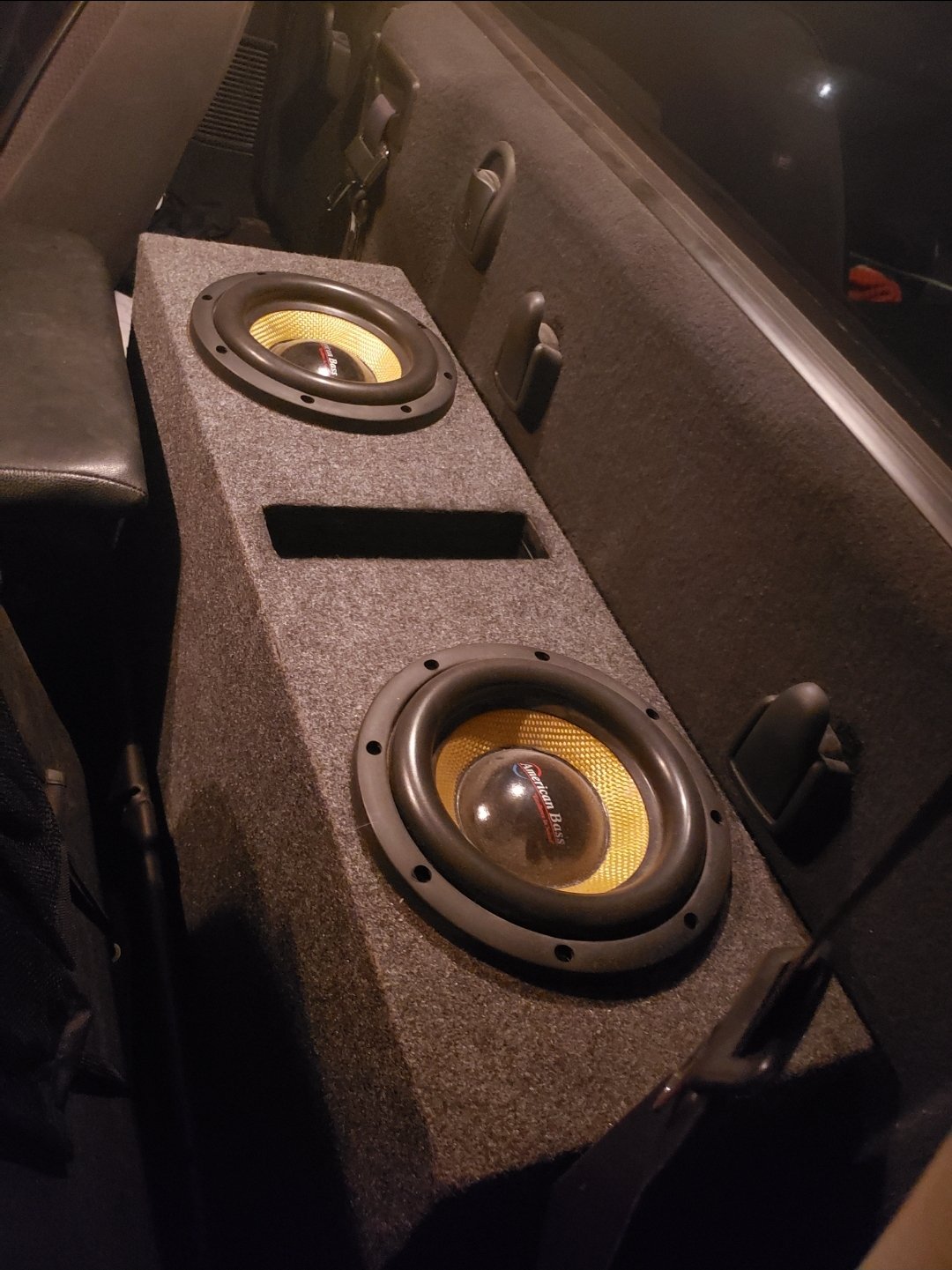

So, right at 8.4 cubic feet gross. So, 2-15's should barely fit after port, bracing, speaker, and 45 displacements. Two good twelves would be a more comfortable fit.
so thats the max but realisticly i was planning on the exact box specs, were gonna b 47L, 18W and 15H with 2 8”aero ports tuned to about 34Hz, cos i still want a lil bit of space in the back
i was planning a box like this but subs up port back
So, those dimensions are roughly 5.9 cubic feet. You should go with two nice 12's. 2-Fi Q Series 12's with a Taramps Bass 5K
