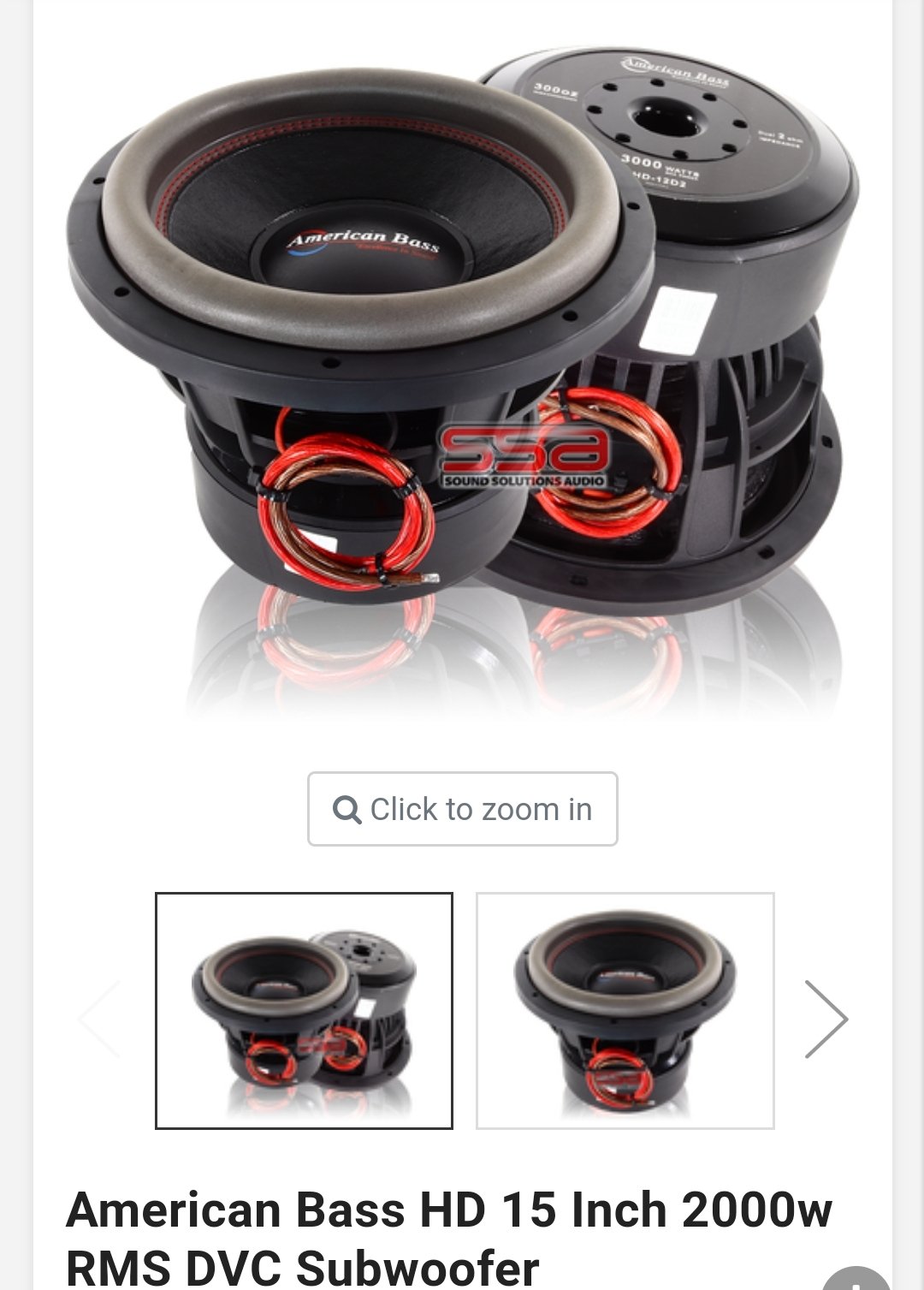

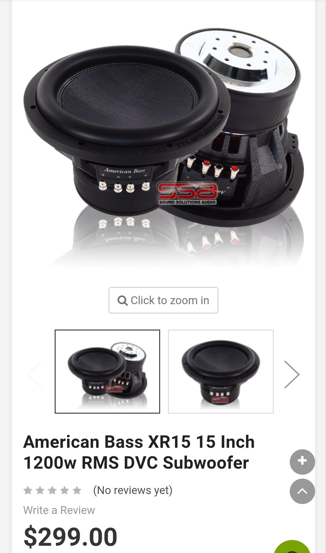

I'm an AB Fan. So, look at the American Bass XFL15's and the American Bass HD15's. They get loud and van take a daily beating. Plus, they are hard to beat for the price. There are plenty of videos of them on YouTube.
yea ive seen those but do they sound good? does it have a good bandwidth is what im trying to ask bc i listen to rap old school and corridos i never listen to decaf or anything of that sort
I'm running a single HD15 and love it. They do have an XR line, which is their sound quality line. The HD line is a mix of both. Both are pretty much the same price.

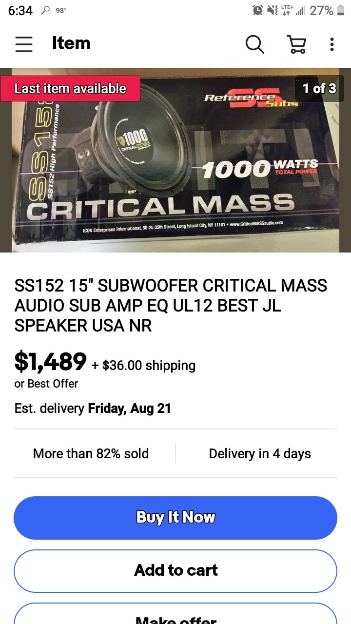

96.87 sensitivity ... I have 2 in the box for less than th he one is selling for ...most subs are in the 80s as far as sensitivity ... these get louder on less power and hit low doing it .. I bought mine for a build a couple of years ago and never finished it out .
But aren't the subs built a lot stronger these days? Back in 89' I had two RF pro series 12's, dual 8 ohm. I had them wired to two ohms with a Nakamichi PA-400m. I was only feeding each sub 220 watts, but it was loud as anything in my 89' Probe. Those subs must've had a high sensitivity, as well.
Yes a lot of the early subs were higher sensitivity..that's why they played louder on less power ..other advantages to less power not as much electrical upgrades... the new subs are made to handle more power ... so stiffer suspensions more spiders ..mean lower sensitivity...I've seen some high power subs with 78db sensitivity ...it would take 2000 watts to make that sub hit like 500 watts on a sub with a sensitivity of 96 or so
