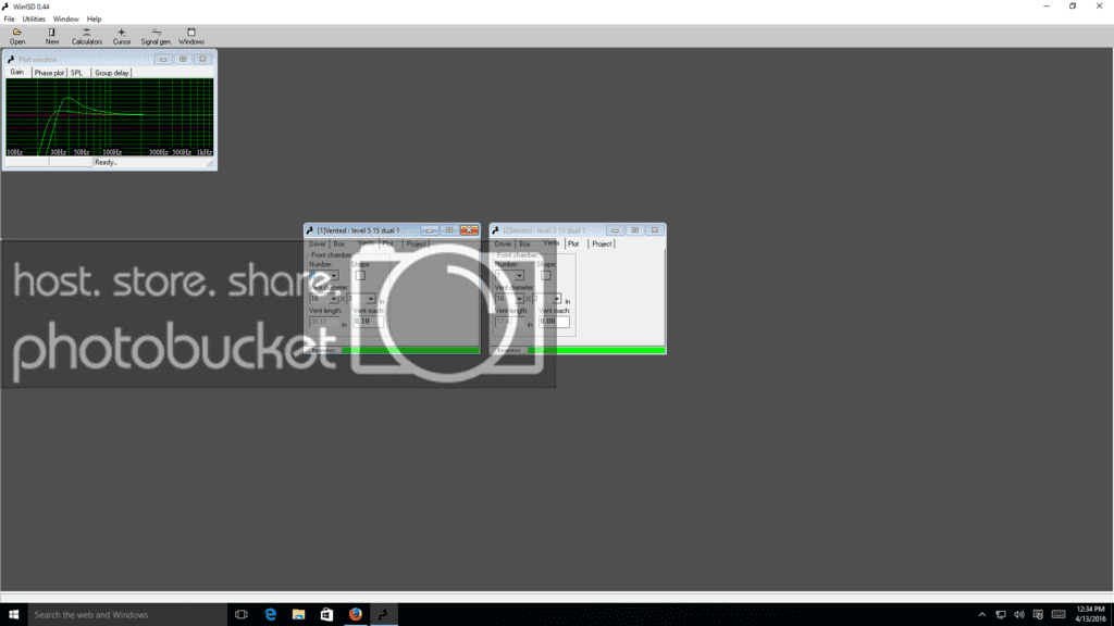

Need some professional box plans for single 12
I was thinking of using 1/2" on the port to gain some cubes but it's very minimal. It's gonna be hard to get 3 cubes after displacement. I'll try some different measurements and see what I can come up with.
This is a little better cubic ft wise. This would be using a 6" round port. The dimensions I gave are the max dimensions, I could go bigger but if the owner of the car ever had to get to his battery, it would be a no go. The stock battery is in the trunk

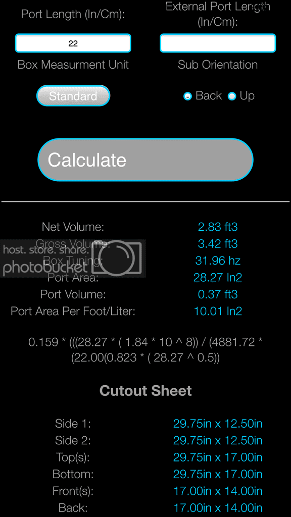

Port area look good? And should I cut it to length after flaring? Also should I fire the port out the side? It would be about 3-4" from the side of the trunk.
Yes when using areo ports the sweet spot is like 9-10" and your at 10"per so your good. 3-4" away from the side of the trunk is good... Are you making your aero port?
