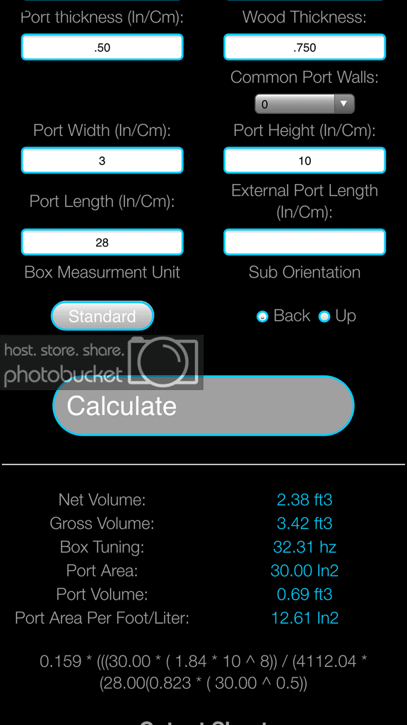

I'm telling ya 3cubes after displacement... That picture u are only 2.3cubes
3 cubes
Port 3.5"x10" tuned to roughly 30hz will hammer
And why is your port .5" and your box .750"???? It should all be .75" if your using 3/4" wood
