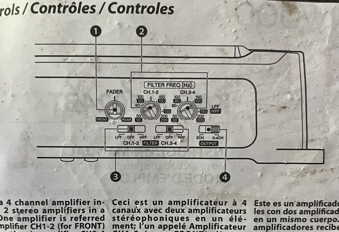

I’m such a noob but my amp doesn’t have a gain control knob. These are the only controls it has
I’m such a noob but my amp doesn’t have a gain control knob. These are the only controls it has View attachment 41994
It may not have a gain knob as it's an all in one.
Set the hpf at 100-150hz and try a 40hz test tone. You shouldn't hear the speakers at all. Turn the radio up till you hear any crackling. The point you here cracking/buzzing is the clipping point. The volume number 1 below that point is your max volume before clipping.
Basically the volume knob is the gain. Youay only be able to get 35 out of 40 before it clips or it might be 37/40 or 40/40 we don't know without checking

Okay so volume is 1-7 and no sound on the 40hz test up until around 4 but it’s such a minor hum it’s not crackling or buzzing until 5-6. So is that the volume limit? My next question is there a better speaker in the 4” category that is able to go higher?
Toe it sounds like the amp starts clipping at 4 of 7. The hum is likely a very low 40hz tone. That's normal but any higher pitched noise is clipping.
