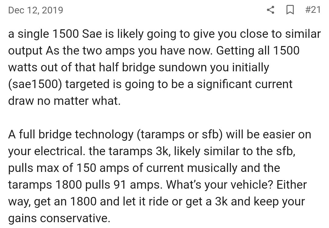

Now, you want him to run three batteries for 2,400 watts? The MD1800 will provide more power and less current draw. And, considerably cheaper.
The 1800 will pull more than 300 amps. Bobby you don’t know what you are talking about. And he doesn’t necessarily need that much battery but always more is better for reserve. With the sae-2000d he will pull a little more than 200 amps and with the sae-1500 he will pull around 175 amps
Brazilian always has pulled just a little bit more current than Korean. Not that much depending on what Brazilian brand you go with, like taramps only pulls a **** hair more than sundown but isn’t as tough and bulletproof as sundown.
I'll take my MD3000 over the Sundown. For that U sub, price, size, and current draw all factored in. I could buy two MD3k. The OP should get an MD1800 or MD3k for the U sub in a ported box. Just do the big three, decent alternator, and a good AGM (only one total) battery in the stock location. He'll be perfectly fine.
