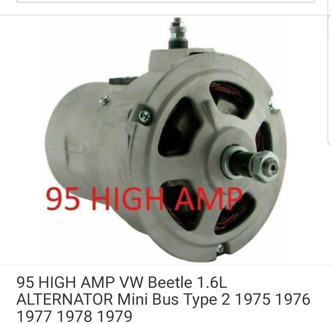

Now, I'm a liar? Do you need to see pics of my system? The biggest alternator that I could find was a 95 amp. 1-15", 4-6.5", and two tweets. Hit 143.8, doors open, car off and from the windshield.

I'm running all three of these with a 95 amp alternator:
Taramps MD3000 single 15"
Taramps DS800X4 four 6.5"
Taramps DS250X2. two tweets
Do the big three, alternator, and only one AGM in the stock location. Believe me, you'll be fine.

And before I leave. You are running more than a 95 amp alternator. A 95 amp alternator won’t support that much current. That’s like 450 amps of current. Bye Bobby!
OP, sorry about that. Taramps are great amps. Like I said, I also have a 55 year old car. People don't understand that we aren't running computers, GPS, back-up cameras, etc... all we have is headlights, tail lights, and turn signals. So, smaller alternators can work for us. You should pick what you are most comfortable with. Good luck and keep us updated!
It's the biggest off the shelf VW alternator that I could find. I'm not a liar.
Then you would have to be running extra batteries. Nobody should ever listen to you. Anybody that can do math can see there is something wrong with your equation. And even if you are running that on that low amperage then your amps aren’t seeing nowhere near their potential. But fuk it. Idc. I’m never gonna go back and forth with you again. Now I have to wait for the taramps guys to shun me. You know the guys I’m talking about. The guys you are trying so badly to get to accept you. The guys nuts who you wish you could sit on and kiss their ass holes even when they bashed you like a queer kid the day before. Smh

I have one extra battery. Why shouldn't anybody listen. I have real World experience with a 55 year old car running 4.050 rated watts with a 95 amp alternator. What is your experience with systems in 55 year old cars? You are telling him to run three batteries, a h/o alternator and a big three upgrade for 2,400 watts total.
Don't tell me what I'm running. I bought the motherfugker!
