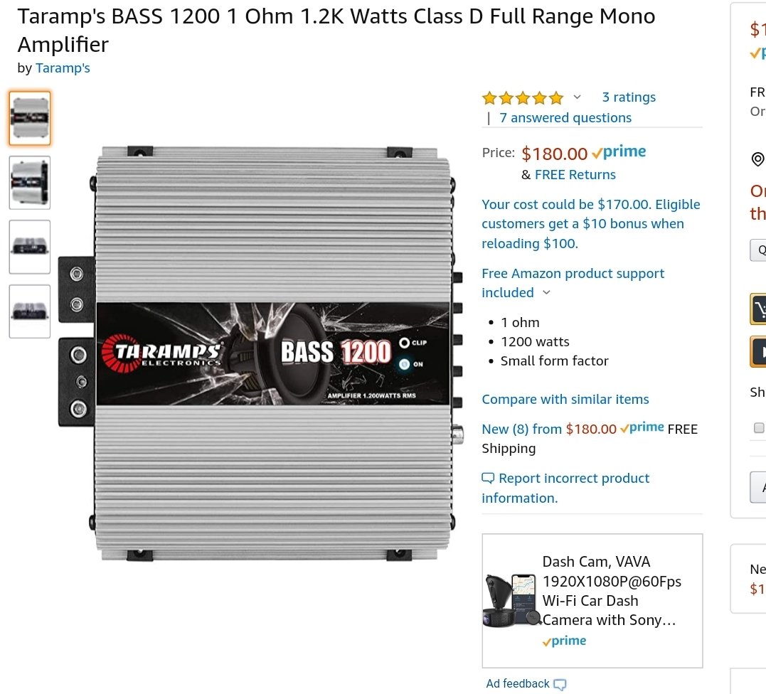

On stock electrical, you might want to drop to a smaller 12" and a smaller mono amp like this.

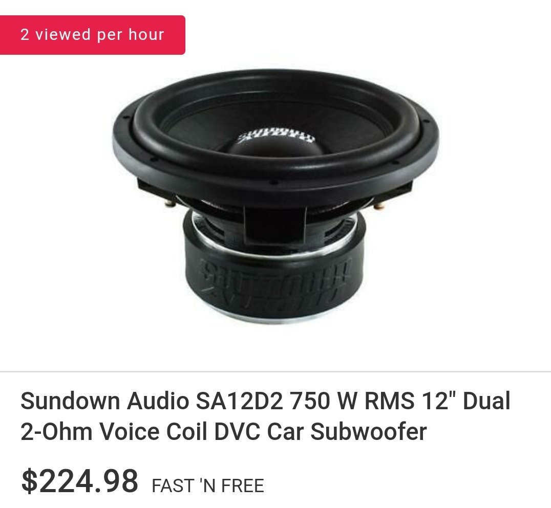

already have the sub. just don't have the amps yet.
O.k., that's fine. You will need to do the big three upgrade at minimum. And, you might want to switch to an AGM battery. A 65 Mustang doesn't have a lot of electronic and computer stuff going on, so, I think the big three and a nice battery should suffice. Your stock alternator is small, so, you may need to upgrade to the 130 or 200 amp alternator to properly power everything. Build a ported box for that sub. "You don't buy a Ferrari to drive the speed limit!" Get the most out of that sub as you can. Proper electrical is the same thing. You don't jump start your car with 16 gauge speaker wire. Proper electrical is essential.
