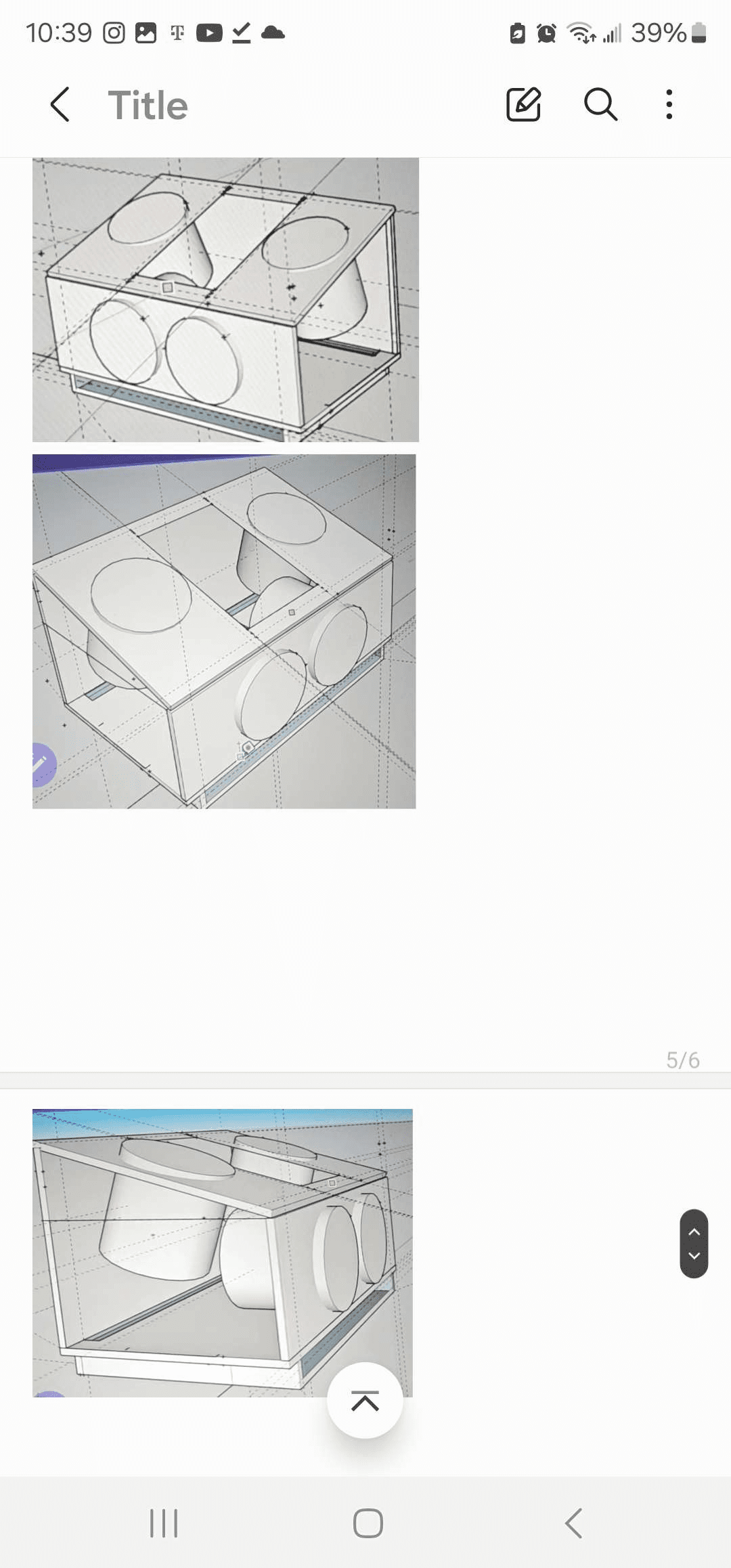

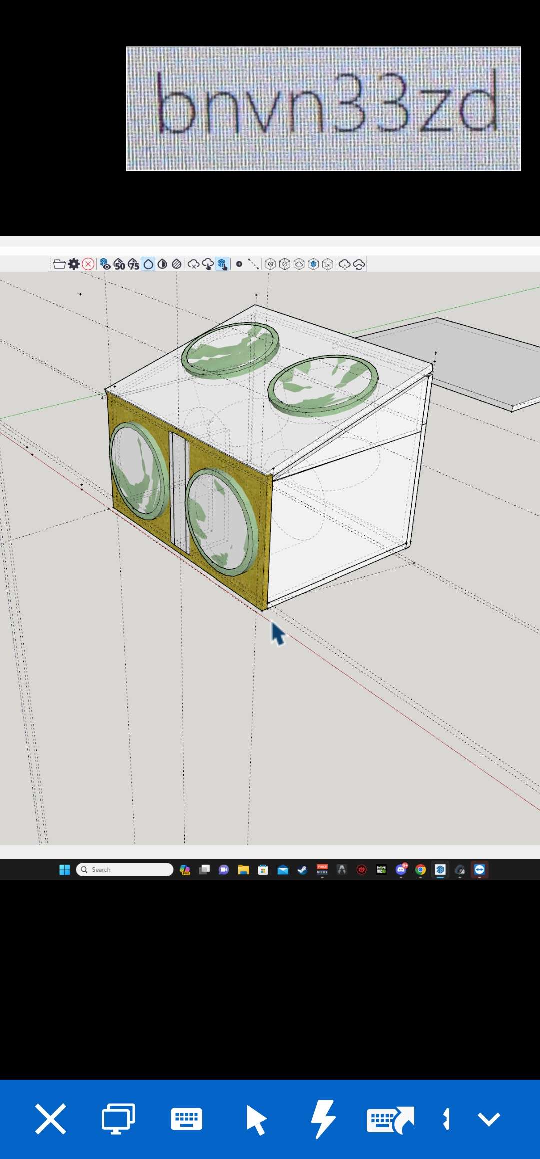

hi there.. so i have 4 x skar zvxv2 d2 subs and i have a jeep wrangler 10' the max diamentions in m jeep is a width 42in x length 26 1/2in would like less like 23 length or less if possible to have some space in my jeep, and the height i can do max 17in or i can do a Wedge Enclosures that measures 18 1/2in length max by 42 width max by back height max 25in and front height max 17in. i have some some models of what i was thinking. but i believe it has to much volume in it ill post it btw i like to listen to trap, rap, dubstep, house music, hiphop, edm

box max dementions
24 length x 42 width x 25 height back panel with front panel 17 height, or 17 height max
volume displacement of my 4 subs should be 33.84 liters im not 100% sure on this.
this was my initial idea, and the middle has plexiglass.
pictures are in link below
I have a cabinet shop next to my job.. And they are willing to make the box out of Birch for me :)
