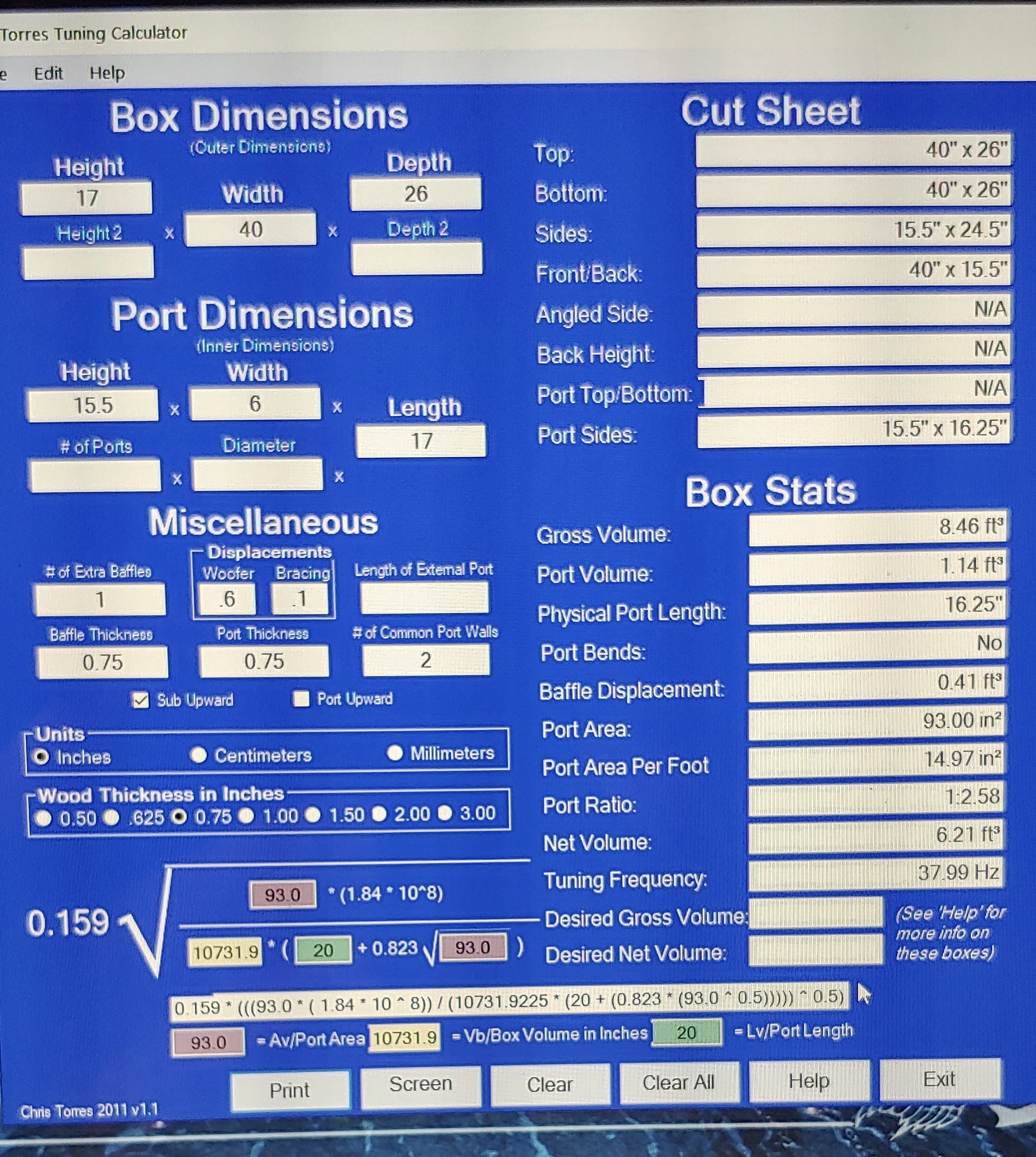

its a 94 explorer, i did some measuring and used torres and i would be real tight for a 4th order to fit but i came up with a ported box external dim. 40"x 26"x 17" with slot port 15.5" x 6" at 17" length, 93sq" port area with a 6.2cu feet net
sub up port back. not much smaller than the 4th or maybe i wasnt doing the 4th right but itll fit who needs back seats anyway lol. do those box specs look like they will work? ill be giving them the full 1500w rms i have a taramp 3000k 1ohm amp to power them.

Can you screenshot what you came up with in Torres?
When you do that, you need to count the sub cutout radius and do pi*r^2 * baffle thickness /1728 because that adds to airspace, if it's not flush mount. Some of the 4 and 5 layers walls for the you know like 3-4-5kw woofers, like a 16.5" hole that's 5 baffles deep is a significant amount added to box volume.

I'd have to check but that seems like too much net unless the mojo's have changed.
If you can OP, see what your group delay is if you do 6 cubes with the mojos and how xmax looks away from tuning frequency. I don't get why they recommend 3.25 cubes per 12. That has to be gross and not net. If I was you, I'd sell them and do 2 15's like maybe Dc's or sundowns or 15's that'll fit in 3 cubes net. If you do the 12's, I think I would try to aim more towards 5 cubes net, or I would.
Further looking at t/s of the 12" mojo6, they look maybe like relatively weak motored. They don't post the Re. Xmax is low too, that may be why they want it in a larger ported box is to try to make it a little more efficient. I wonder what the Xmech is on these. They don't give the Re configuration so their Bl doesn't mean much. Ugh i'm not opening a design program though. You can and look at the Re and Bl ratio. Still seems low to me. You might benefit greatly from a quasi-series 6th order with these. Do a small port area and have some sort of front chamber with some sort of loading wall. Idk if that would even begin to fit in your space. You could do a center port exiting rear and have the subs facing each other inside of the port, right at the exit into the vehicle cab airspace. That'll help with the lower xmax, keep the cones linear.
Hey @shredder2, with 2.1 cubes sealed, what's his Fc/Frc on that?

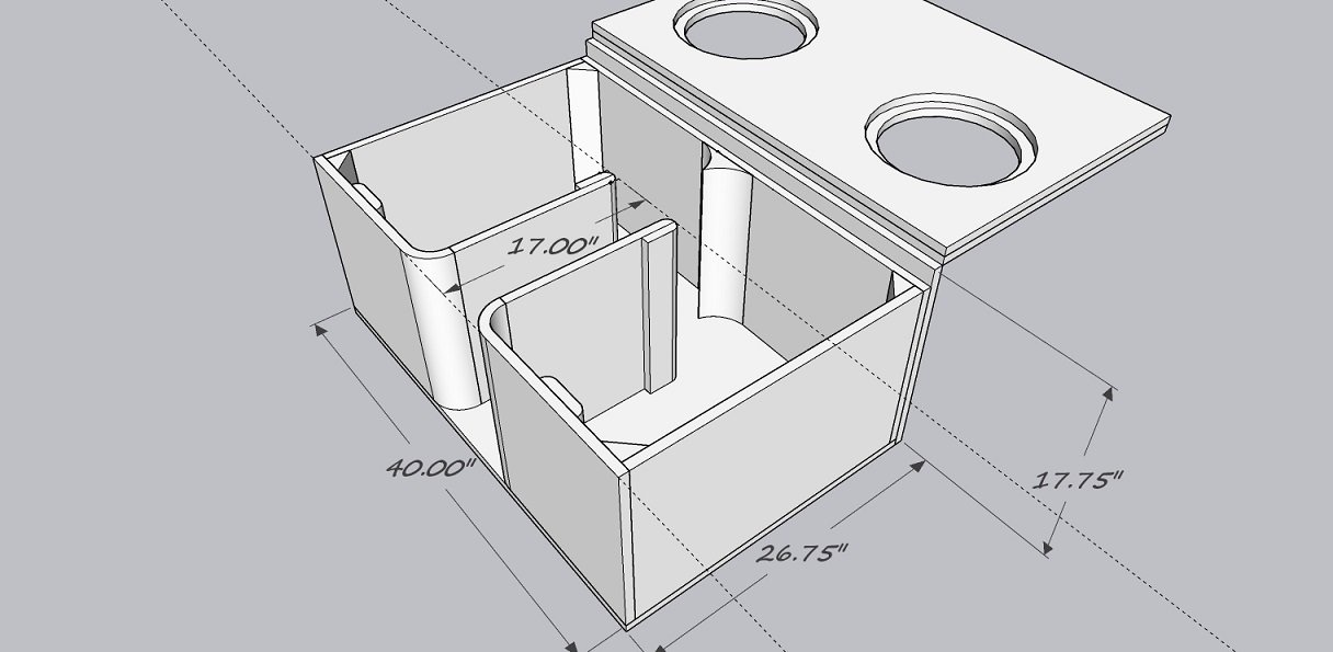

shredder2 here is the screen shot and a pic of the box i came up with i added a second piece on the front for strength after i used torres but i didnt think it will change anything, or will that not work. i still need to add some bracing inside the box that i know. Also , yes i did leave room between box and rear door about 6-8 inches. or should i leave more

That drawing looks good above, maybe brace the side panels to the port walls with some window bracing instead of worrying about bracing the smaller front panels.
Jmo
I agree on others opinion regarding the subs suitability in a ported alignment, I'd personally go a bit smaller volume wise and think 5ft3 net 80in2 of port would be more than enough for those subs.
However a 3K at 1 ohm is NOT going to deliver 3K once installed so the oversized box should be a wash to make up for any driver limitations without killing the subs.
The Ebp WAS a little low Iirc and that usually screams weaker motor strength. Hence the 4th recommendation.
I can't know your goals, but most people nowadays like a lower tuning than around 37hz... why not shoot for a lower tune since you got the space?.. whatever you end up with volume wise I'd personally not worry about overpowering those subs as the volume will be less in the same footprint with a sufficient longer port. Just keep the port 12-16in2^ft3 or thereabouts
and if you're listening to rap, i would tune at 32-34. like if you want musical bass, you can do closer to 10-12 in^2 per cube. you may want to download winisd or something, to see what your port air speeds look like.
