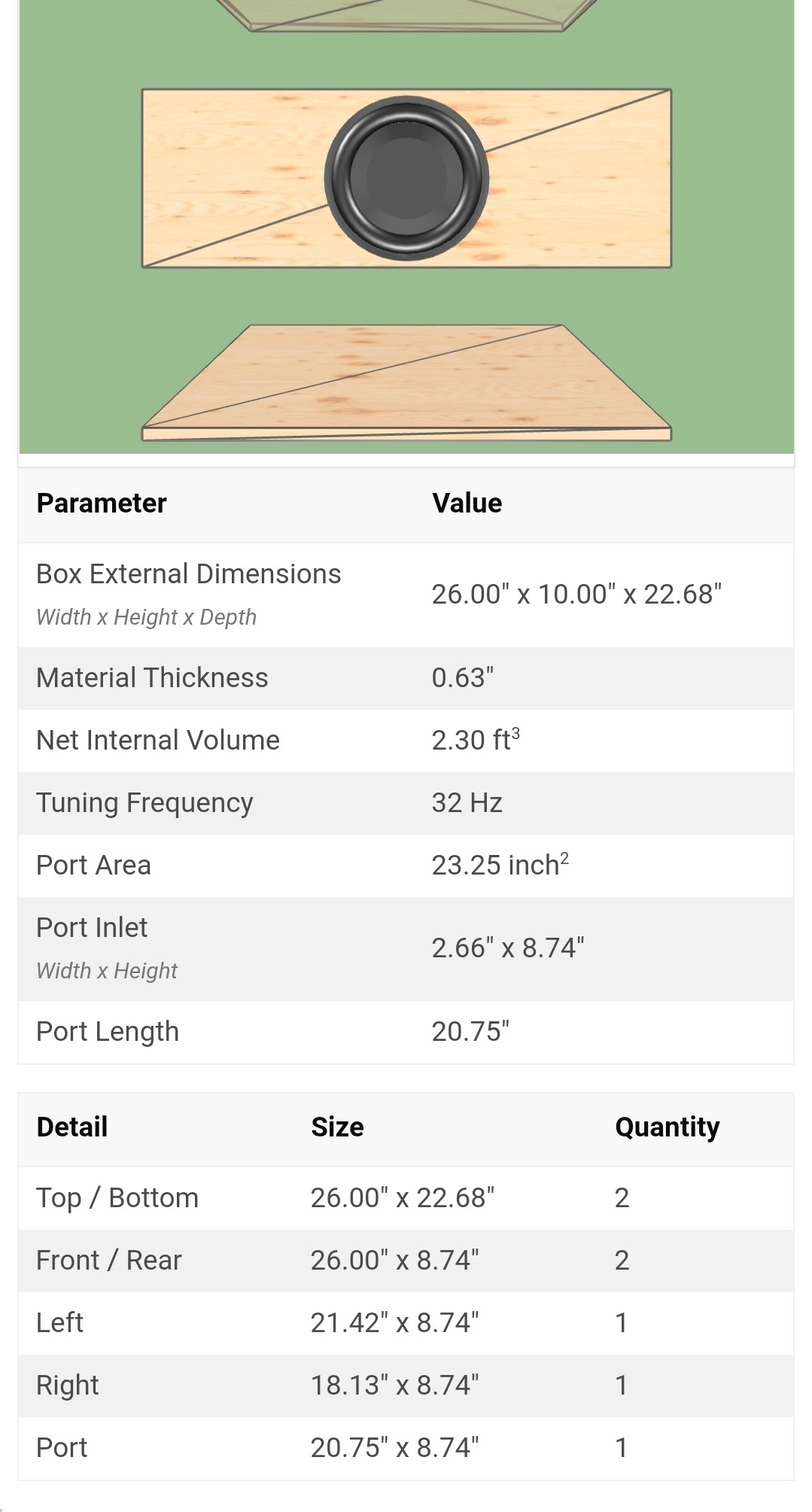

ekah Senior VIP Member 401 4 hawaii Dec 3, 2020 #1 I made this on subbox If anyone know if this looks legit and if the website is legit etc going off of nothing really Click to read more...

Buck 5,000+ posts little alien on campus 35,960 5,673 Inside of a pyramid Dec 3, 2020 #2 where's the port??
Buck 5,000+ posts little alien on campus 35,960 5,673 Inside of a pyramid Dec 3, 2020 #3 That's 5/8" = .625. I would use thicker wood.
OP ekah Senior VIP Member 401 4 hawaii Dec 4, 2020 Thread Starter #4 Buck said: That's 5/8" = .625. I would use thicker wood. Click to expand... The port is on the side like on the right side but idk how to input a different wood thickness

Buck 5,000+ posts little alien on campus 35,960 5,673 Inside of a pyramid Dec 4, 2020 #5 I do design, if you want one. People typically use .75" MDF or Birch.
OP ekah Senior VIP Member 401 4 hawaii Dec 4, 2020 Thread Starter #6 Buck said: I do design, if you want one. People typically use .75" MDF or Birch. Click to expand... Oh yes if you can help me i would love the dimensions that I used it says recommended tuned to 32 hz and I dont have a lot of room for a sundown x8 v3

Buck 5,000+ posts little alien on campus 35,960 5,673 Inside of a pyramid Dec 4, 2020 #7 ekah said: Oh yes if you can help me i would love the dimensions that I used it says recommended tuned to 32 hz and I dont have a lot of room for a sundown x8 v3 Click to expand... PM me
