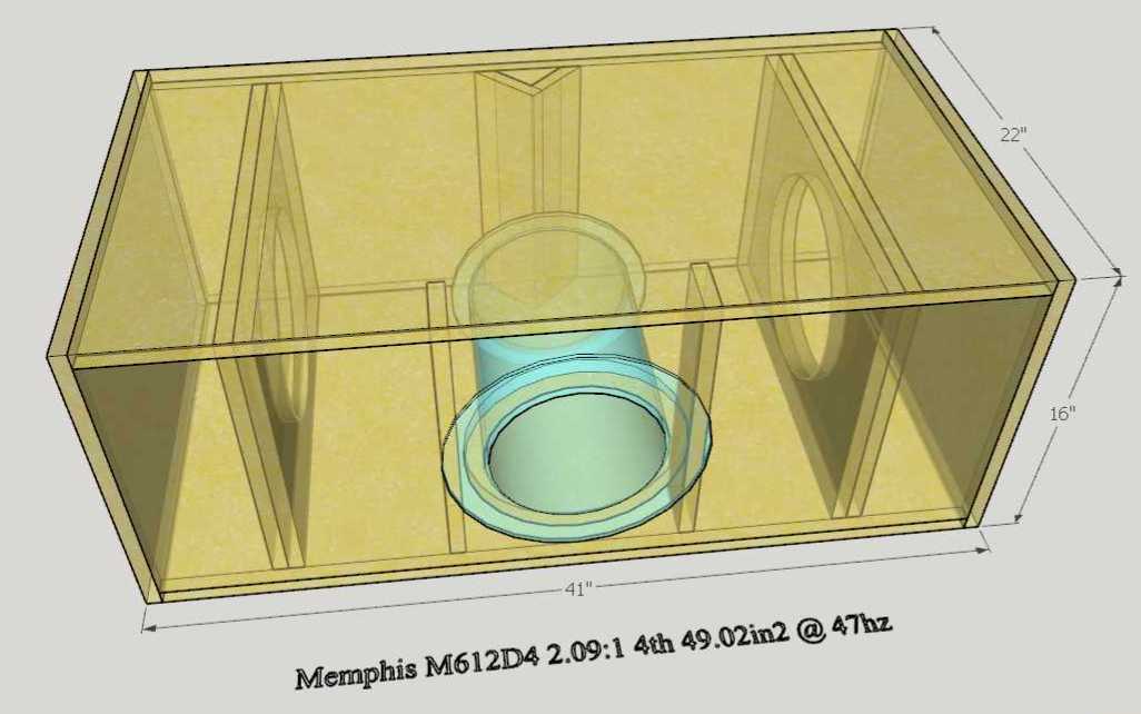

I'd probably opt for a 4th in that space myself with those subs.
1.8ft3 sealed/3.6ft3 ported with an 8" Aeroport 11" long to tune it 46-47hz.
What would you charge a design

Honestly... I haven't checked.
It might do better in a ported alignment and save space.
Just depends on what the sub likes
Tbh... the mounting depth will probably be a factor if its a higher powered sub anyways. The clearance was tight
Alright
You think a 4th order would be better for the higher powered ones or ported
I like ported if possible, the recommendations I saw with a quick check was 6.5ft3 net vented for 2, 62.5in2 ported at 36hz and to me it looks like the recommended port area is a bit low at 9.5in2^ft3 so I'd check the ebp to see what it likes if it was me. I bet it will do well in a 4th designed for them.
I like how a 4th looks after checking... 2.1 sealed/4.2 ported 90in2 of slot 18" long should tune 47hz or so and if you have the space I'd do a 4th myself. Without drawing it up I cant say offhand it'll fit so keep that in mind.
It will be substantially larger than the design i posted
