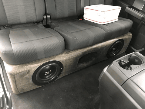

This response is great, thanks for the enlightening rant. If you had a crew cab truck ('19 f250 w/ 2" seat lift) what what you go with for sq and decent spl? I'm leaning towards a gately box for 2 idmax 10's in 3ft @ 35hz now.

Now you're getting the idea (or joining the club?)... That's another expensive option that imho could be improved on by having the port side or cabin corner loading imo.
If its seat lifted already a front firing side ported pair of 10s should really deliver.
The craftsmanship of those Gately enclosures is nice but for the pricetag you might expect more than you'll get.
Be careful with stating "sq" around here. What sounds good on music is one thing but stating "sq" can also be interpreted by members as that approximating that pursuit of perfection... And that will bring out the sealed box proponents and esoteric brand guys from what I've seen... :LOL:.
A fairly loud, musical substage with a pair of 10's on what I'm assuming is stock electrical shouldn't be hard. I've done a few myself but its frustrating to me when the user cuts the baffle and adds subs trying to get louder.

Just the roundover router bit to do that 1.5" edge costs 150$ Though honestly for the price of those boxes you could absolutely buy all the tools and wood needed to knock together your own (if you're handy with woodworking). Not sure what seat lift kit would cost on its own. That box looks very nice though.
If you don't live near an audio shop that builds good custom boxes you might try reaching out to a proper cabinetmaker and see if they couldn't knock something like that together for less. Just be sure they use some 3/4" stock of MDF or cabinet grade ply.
Check out the SSA F-150 build. They did a seat spacer and fit 3 F8L 8’s ported under the seat forward firing. Currently I have a fox box under my seat (F-150). I had Sundown E’s and yes it got loud but sounded awful (downfiring ***** along with his small ass port). I then sealed it off with 2 ID Q 10’s which I like but it’s still missing something. My plan is to take the box and customize it by adding some mdf and fitting an SSA Icon 12 front firing in the center. I’m going to post the build here when I get time to start (we are having our second child any day now).
