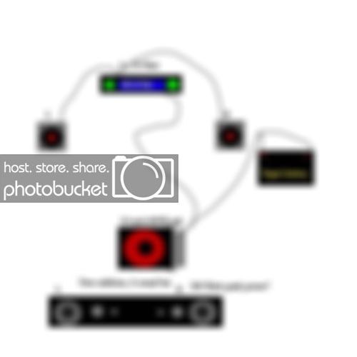

Allright, so im a total noob with wiring, i had a 10inch sub installed in my jeep TJ to add more bass... Now after a while, i wanted to upgrade the sound a bit more, I replaced the two front speakers, and purchased a "Sound Bar" Its a speaker bar thats installed on the roll bars on the Jeep.
so basically as i can figure this is my setup as it is
Now the soundbar is a Chinese peice of shit im sure, i got it mostly just because i was too lazy to try to create a custom sound bar for my car, i figured i would replace the speakers with some pioneers or something.
Anyways, the site I orderd the bar from, said the Speakers have a 200 Watt peak power, and the output of my Head unit is only 50 watt,
it says 50wX4, its a pioneer mofset something or other
as is its the front two Left And Right connected, this will be for the Rear Right and Rear Left, so im guessing I will just have to pull my head unit and connect the RR and RL to the appropriate wiring? or would i need an amplifier to achieve full potential of the speakers? do they sell smaller amplifiers? like a 200Watt amp? or 100 watt?, get two smaller 100 watts for each channel left and right?
I would suggest adding an amp. if you want "full" potential, but if would probably work just fine if you use the rear channels from you hu. If you get an amp. I would get one big enough to power your front and rear speakers that way they'll sound uniform, Just my opinion.
sound bar's are a nice setup, adding an amp to them and the front speakers would be best way to add more sound to your music. with a descent 300w 4 channel amp use the 2 channels for the front and bridge the 2 rear channels for the sound bar.
