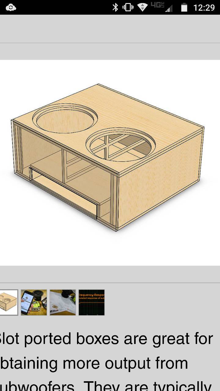

Something like this. It's in a 2005 Expedition. 1500rms.
Max depth (front to back)- *48
Max height (top to bottom)- 36
Max width (side to side)- 49
I got a design from Buck for my Sundown z12v3 but he stopped. He was going to do this one but I understand. Hope he's ok and if he's sick that he gets better.

Let me know.
Thanks

Have you searched on Sound Qubeds site yet?I didnt actually see any enclosures for subs up port up for a pair that would generally work well in an suv,but the Sq Ft measurements are there if you know how to calc it up/find a enclosure download.
I like subs up port up myself..Subs up, port rear generally what most like to run..but deff on what you really like.
This is for my brother. I think he got that design from CAF. Is there anyone that can build me a design like that with those subs and dimensions?
Sent from my LG-H910 using Tapatalk
Should work well enough in DD spec box as well if you like any plans on their site. If you're not chasing 10ths I don't think port back port side or port up will make much difference.
I think it's more the look of it. He just wants it to sound proper. 1500rms for those two subs isn't quite enough but should be ok.
