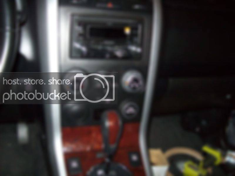

I'll start at the receiver: Kenwood DPX503 http://www.crutchfield.com/p_113DPX503/Kenwood-DPX503.html?search=Kenwood+VENDORID113&searchdisplay=Kenwood&tp=5684 I didn't want a screen in the dash again and I wanted a somewhat stock look with decent processing including T/A and easy hookups for my zune or my 4gb thumb drive. You can pick these up brand new from ebay for about $215 or so. I'll give a more in depth review of this HU tomorrow along with pics.

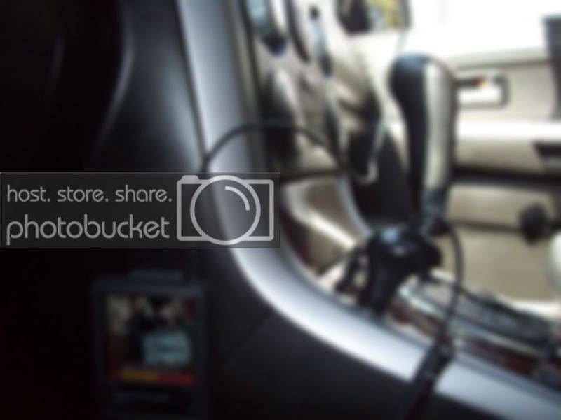

I am liking your Kenwood HU a lot.. very stock looking, I like that..
but I dont like how the cable running to your zune looks out of place...
I just checked the specs, it is compatible with kenwood ipod adapter.. why dont you use ipod instead eh? just a thought? so you can hide the cable and ipod behind the HU into the glove box?

Yeah, it's a pretty nice unit but there are a few things things that annoy me with it. The first thing is that it only has 2 2.5v preouts. The other thing is the remote doesn't allow for a lot of scrolling through the menus and only certain colors really stand out during the day to where you can see the screen clearly.

I have 2 mp3 players and wouldn't feel like getting another. The main reason I like it there although the wire is in the way, is that I can charge it through the cigarette lighter plug and I usually have to scroll past songs because I download a ton of full albums and I have to skip through songs a lot. I actually plan on using the thumb drive a lot more though. Thanks for all the comments and the vehicle is a 2006 Suzuki Grand Vitara.

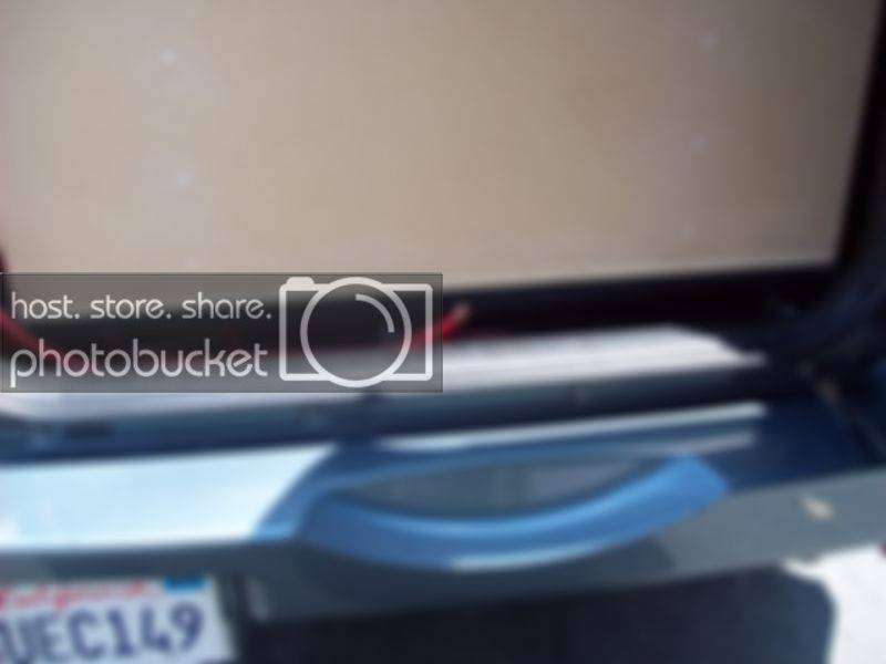

Here's some pics of the box and subs in the car. I still don't have a mono amp and the wiring isn't neatly done yet either cuz I'm waiting for a few things.

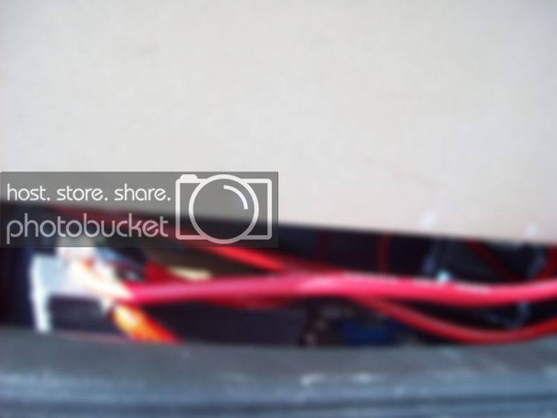

The amps are underneath the sub box. I need to figure out a way to mount the 2 fans I have. I have very limited space to work with. If I buy an audiopipe 3000.1 I'll have to mount it to the box on the angled side up against the seats.
You can kind of see the battery tucked away on the side of the box, I took a weird angle for the picture. I'll also have a volt meter there.
