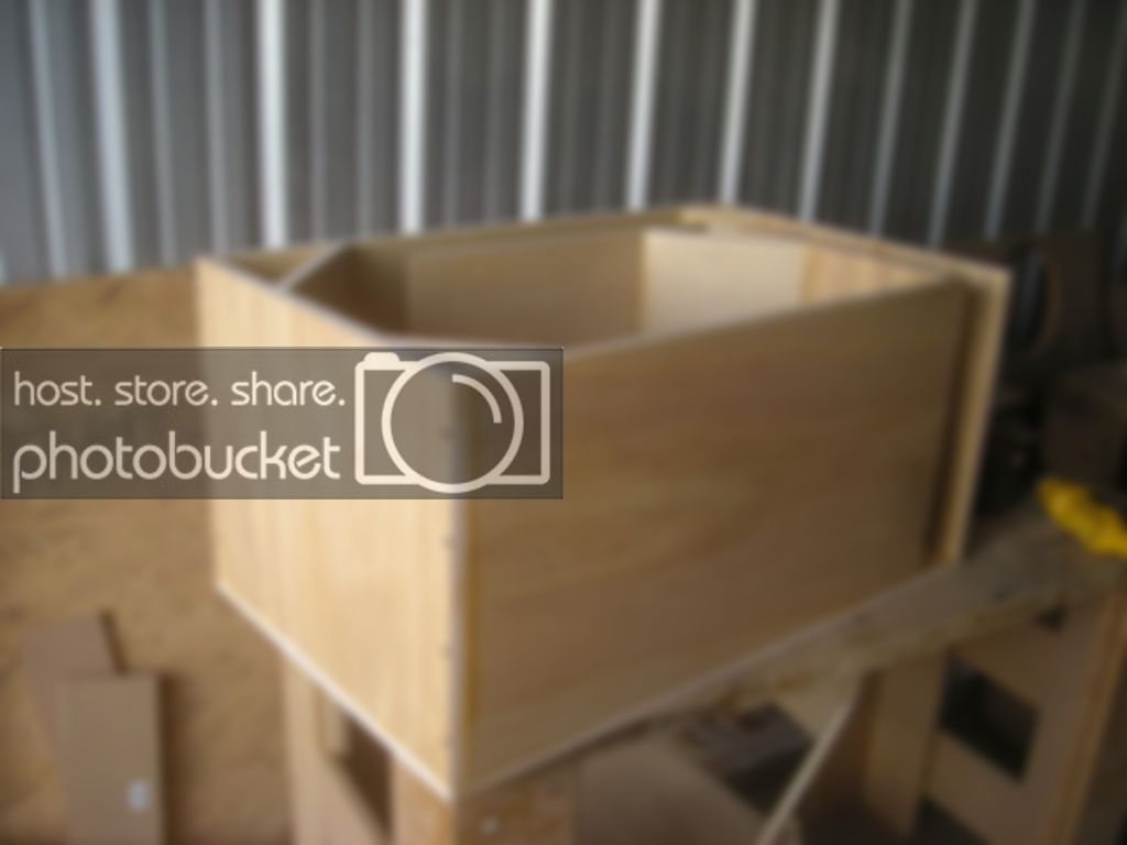

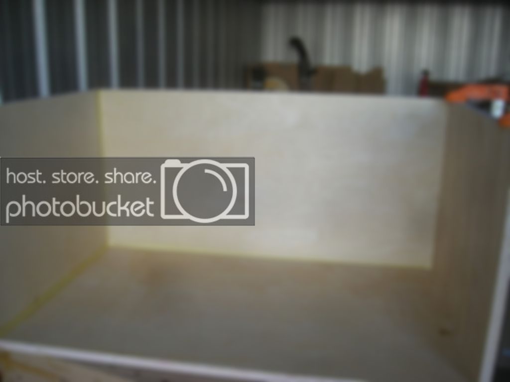

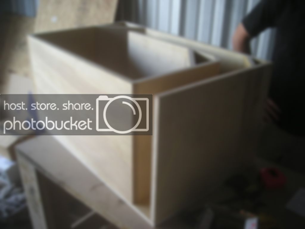

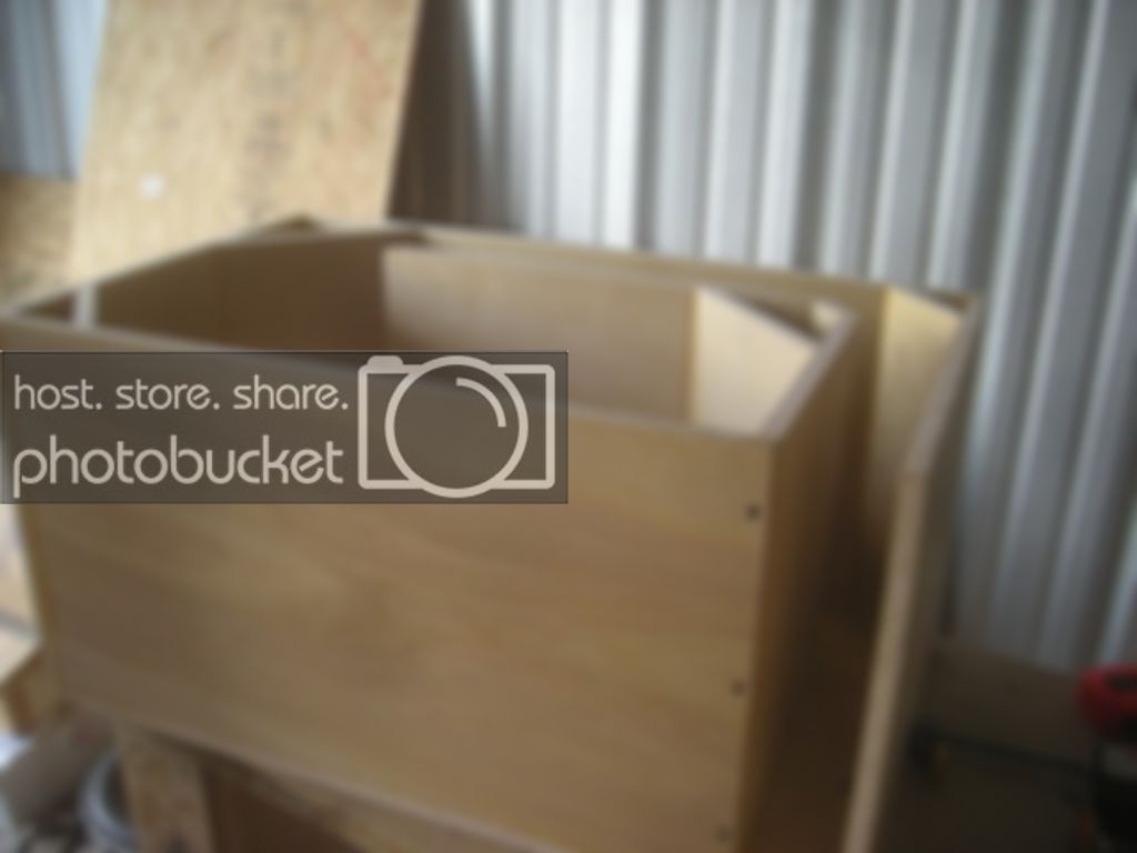

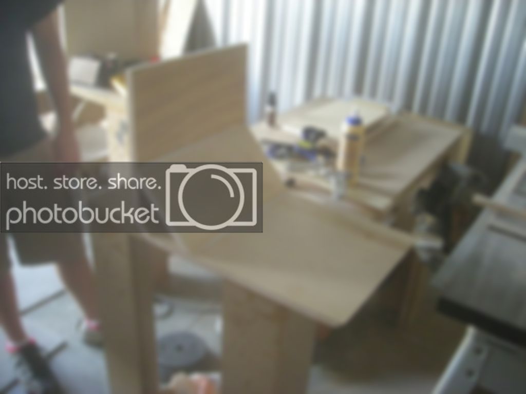

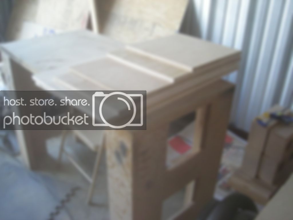

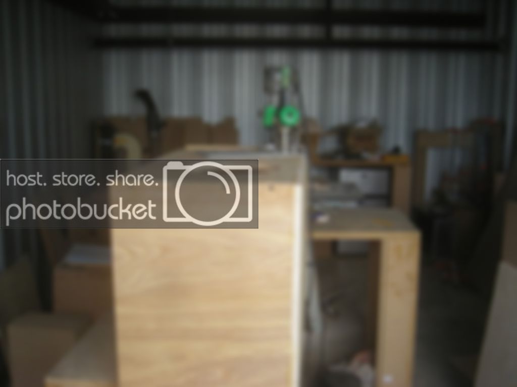

Alright, this enclosure will be 3 cubes net, 50.375 sq inches of port, and tuned to 30hz for a pair of 10's out of randy's (assman's) van.
Most of the pieces cut..

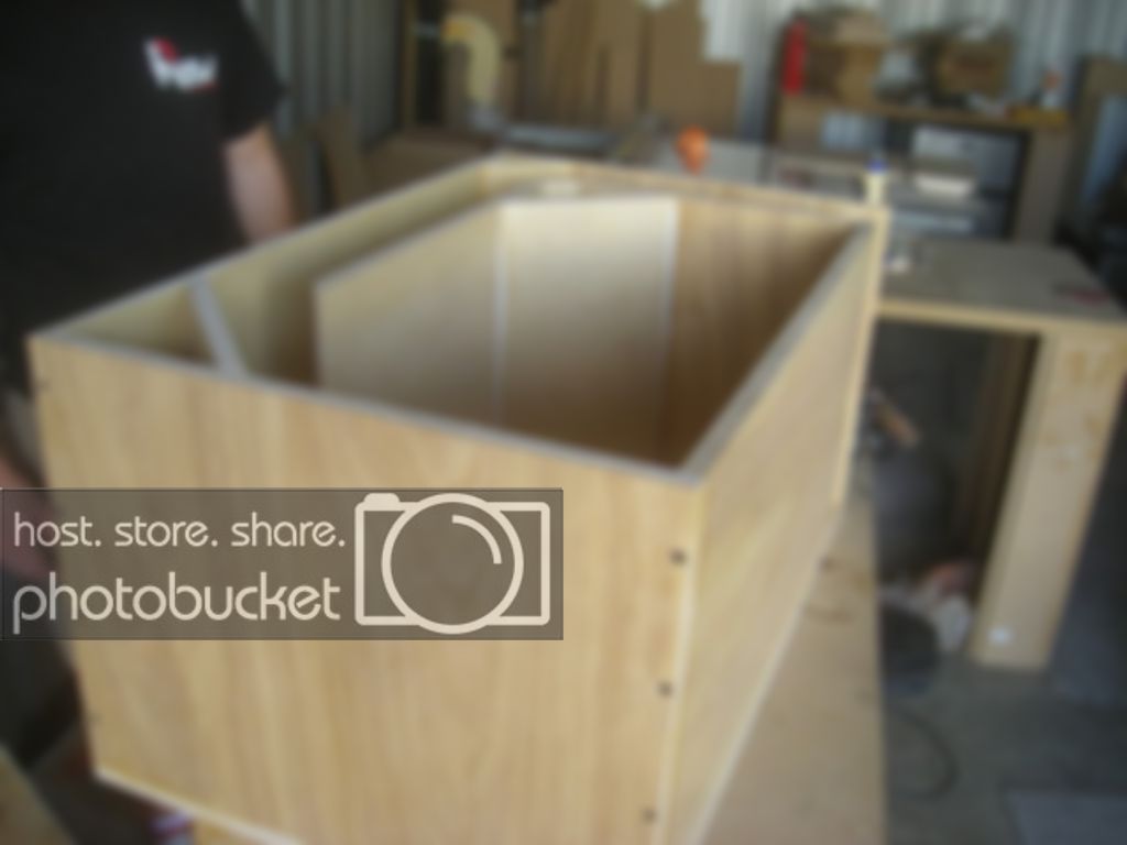

Inner port made up..
Getting the holes cut, more when it's finished and install pics..
Thanks guys...and yea, birch is way lighter and the screws bite better into it imo along with it being a bit stronger I'd say.
And yea, I used birch for the enclosure in the saturn...it's rock-solid.
