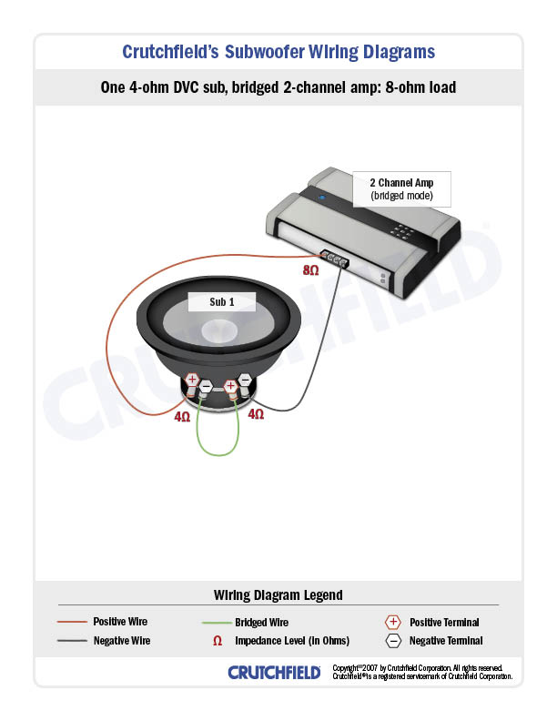

So if I got a P2D2 would it work at 4 ohm?
no u would need a r2d2 lol jk
a dvc 4 ohm can be wired at 8 or 2 ohm by itself. adding another sub u could do 4 ohm but ur amp can barely push 1 sub
just google "how to wire subwoofers" and theres a bunch of sites that will tell you how to do it
If i was you i would get a better amp, a mono sub amp.
I googled that amp you said you had and it cost 100 bucks. so u basically get what u pay for i guess
and my bad BoominTahoe i basically just said what u already said earlier except i had pictures lol
So after answering bjohnsons question I realized after looking at wiring diagrams that if i wanted to run 1 ohm on 2 dvc subs i would want to get 4 ohm subs not 2 ohm correct?
I just assumed that 2-2 ohm dvc could run 1 ohm but from what i seen it doesn't look like it. Can someone verify this for me? thx
Yes...to get a total load of 1ohm from (2)dvc subwoofers they would need to 4ohm DVC speakers...each coil being 4ohms. All 4 coils in parallel.
A 4ohm dvc sub will give you: both sub coils parallel = 2ohm, both coils series = 8ohm.
The same holds true for the subs...(2) 4ohm subs can give you:
Sub 1 (in series coils) 8ohm in series with Sub 2 (in series coils) 8ohm = 16ohms
Sub 1 (in series coils) 8ohm in parallel with Sub 2 (in series coils) 8ohm = 4ohms
Sub 1 (parallel coils) 2ohm in series with Sub 2 (in series coils) 8ohm = 10ohms
Sub 1 (parallel coils) 2ohm in parallel with Sub 2 (in series coils) 8ohm = 1.6ohms
Sub 1 (parallel coils) 2ohm in series with Sub 2 (parallel coils) 2ohm = 4ohms
Sub 1 (parallel coils) 2ohm in parallel with Sub 2 (parallel coils) 2ohm = 1ohms
For 2ohm dvc subs just cut all the values in half.
Here's the equation, so you won't need to learn it by heart but logically //content.invisioncic.com/y282845/emoticons/wink.gif.608e3ea05f1a9f98611af0861652f8fb.gif : 1/R1 + 1/R2 = 1/Rt ( when wired in paralell) R1 + R2 = Rt ( when wired in series)
When only one DVC sub:
Rt : Total load
R1 : load of one coil
R2: load of the other coil
When more than one DVC sub:
Rt: total load
R1: load of one sub (total load of the two coils)
R2: load of the other sub (total load of the two coils)
With these two equations you can check the total load you will get no matter how many subs are wired together.
