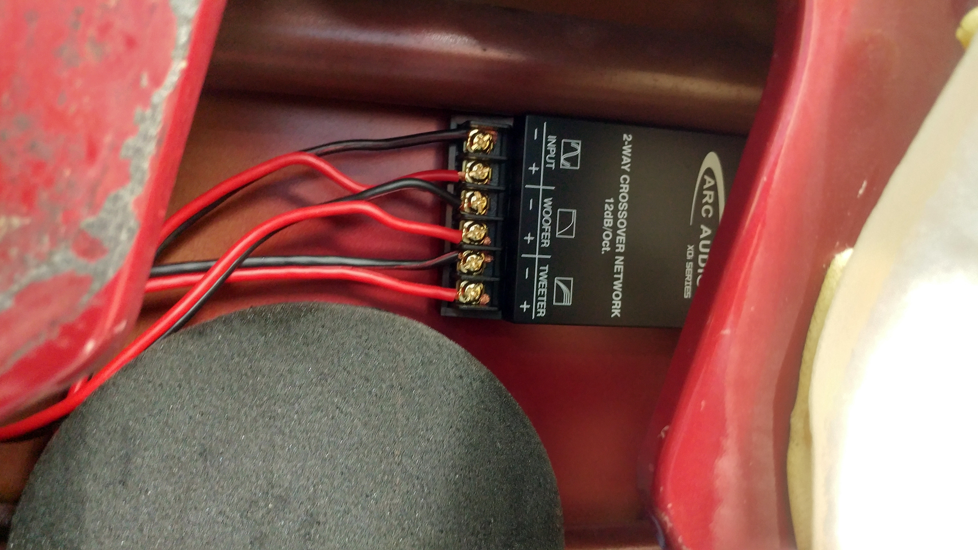

These crossovers... I know I know... bad location.
ok, its good that you are using the right passives for the right tweeters. When i say "proper passives", i mean ones that are designed for the drivers in use. Passive crossovers are more than just "pick a frequency, a slope, and DCR". They can actually get extremely complicated and take care of a lot of acoustic issues. Car audio ones are typically crap and super basic due to space constraints and cost, as well as the unpredictability of every car/install. for mids in your budget, look into the Audiofrog GS25 or GS40
