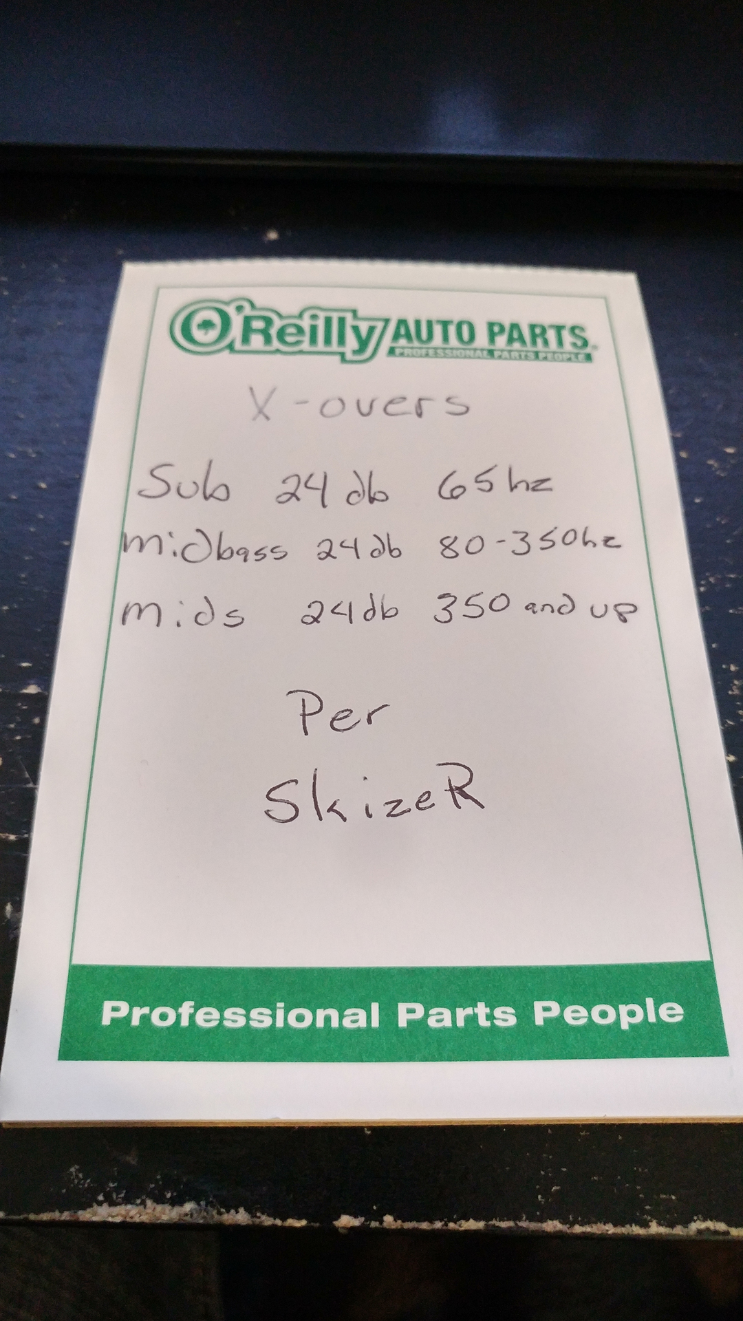

1) why are your crossover points so high? unecessary. do sub up to 65hz. midbass from 80 to 350, midrange/tweeter 350 on up. you also shouldnt be using generic passive crossovers while mixing/matching drivers, but thats not a huge issue right now if nothing is blowing
2) he means half octave, but this is for a more common crossover, like around 80hz.midbass at 80hz, sub at 65. this helps keep them in phase at the actual intended crossover point while allowing the sub to play at a higher amplitude. This is also ONLY for the sub to midbass crossover. NOT all of them. Set

0 - 65 | 80 - 350 | 350 - 4Khz - 20Khz
Yes, with 24db Linkwitz Riley slopes. Follow that guide. Read every single bit of it. I can tell there's a good chance you didn't read the whole thing because i wouldn't have needed to write everything above

I redid the crossovers. I had to do a bunch of eq work but ok, yes, it sounds better. I turned off the sub to listen to the midbass, the midbass is handling a kickdrum just fine. I think I would like to see if it improves with sound deadening as well.
SkizeR you were right.
