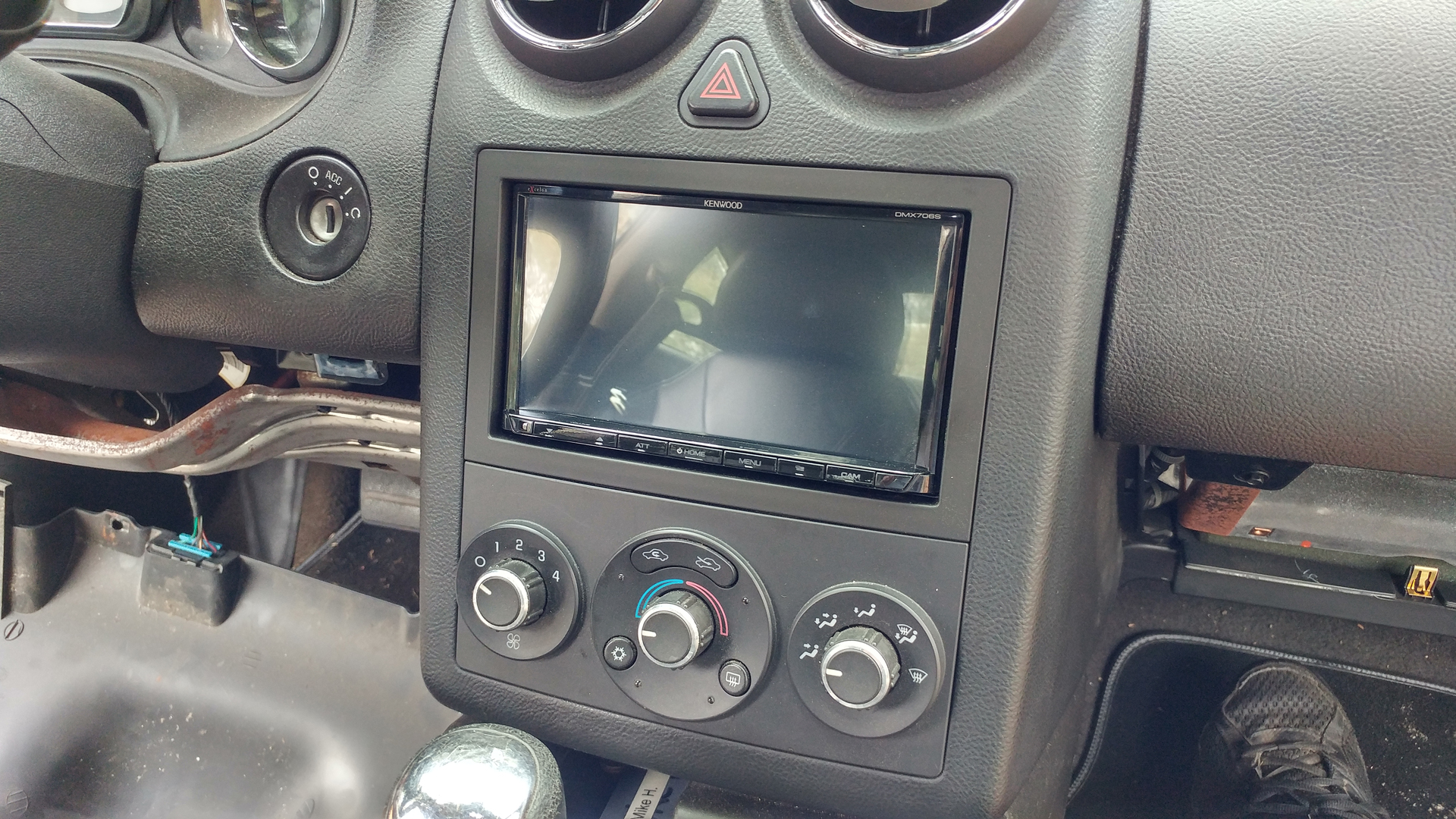

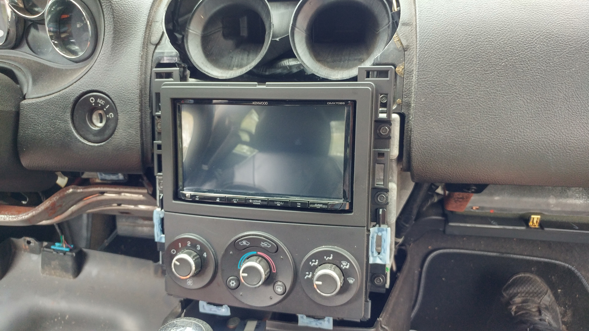

My first "Active" "SQ'ish" build attempt.

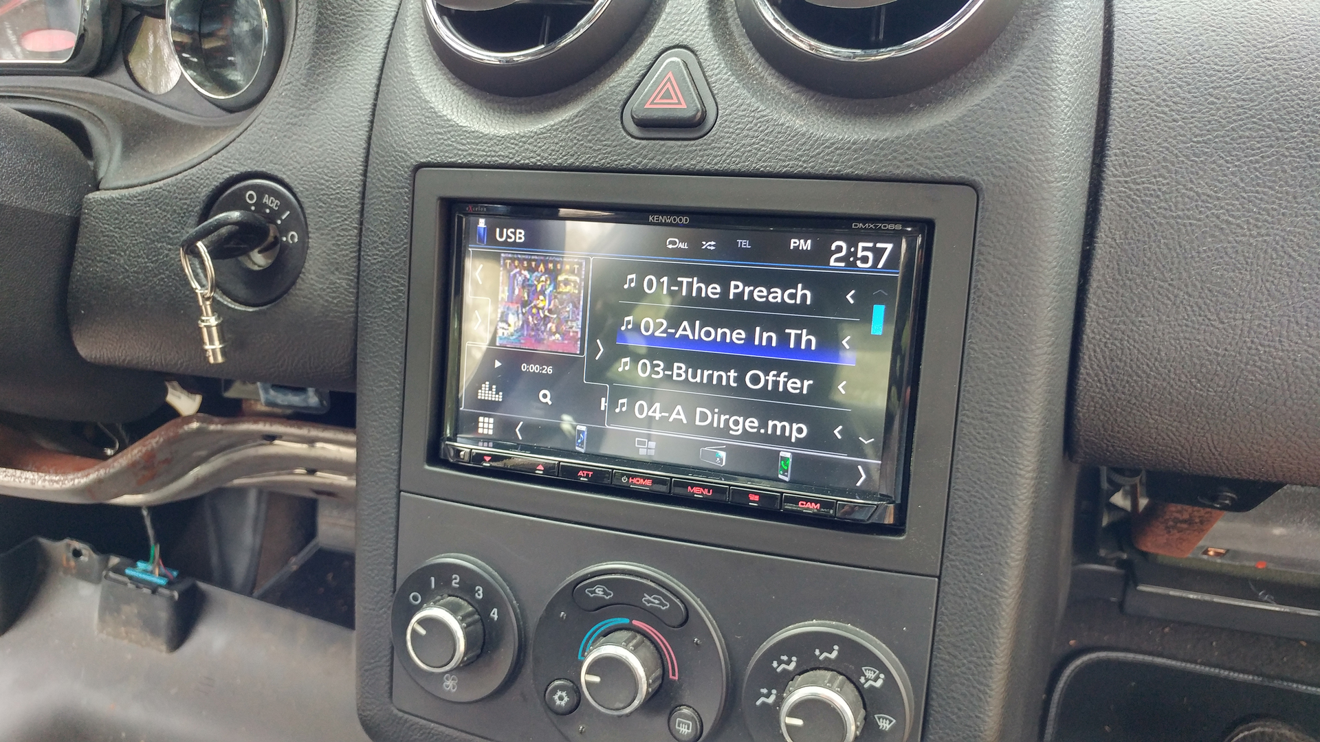

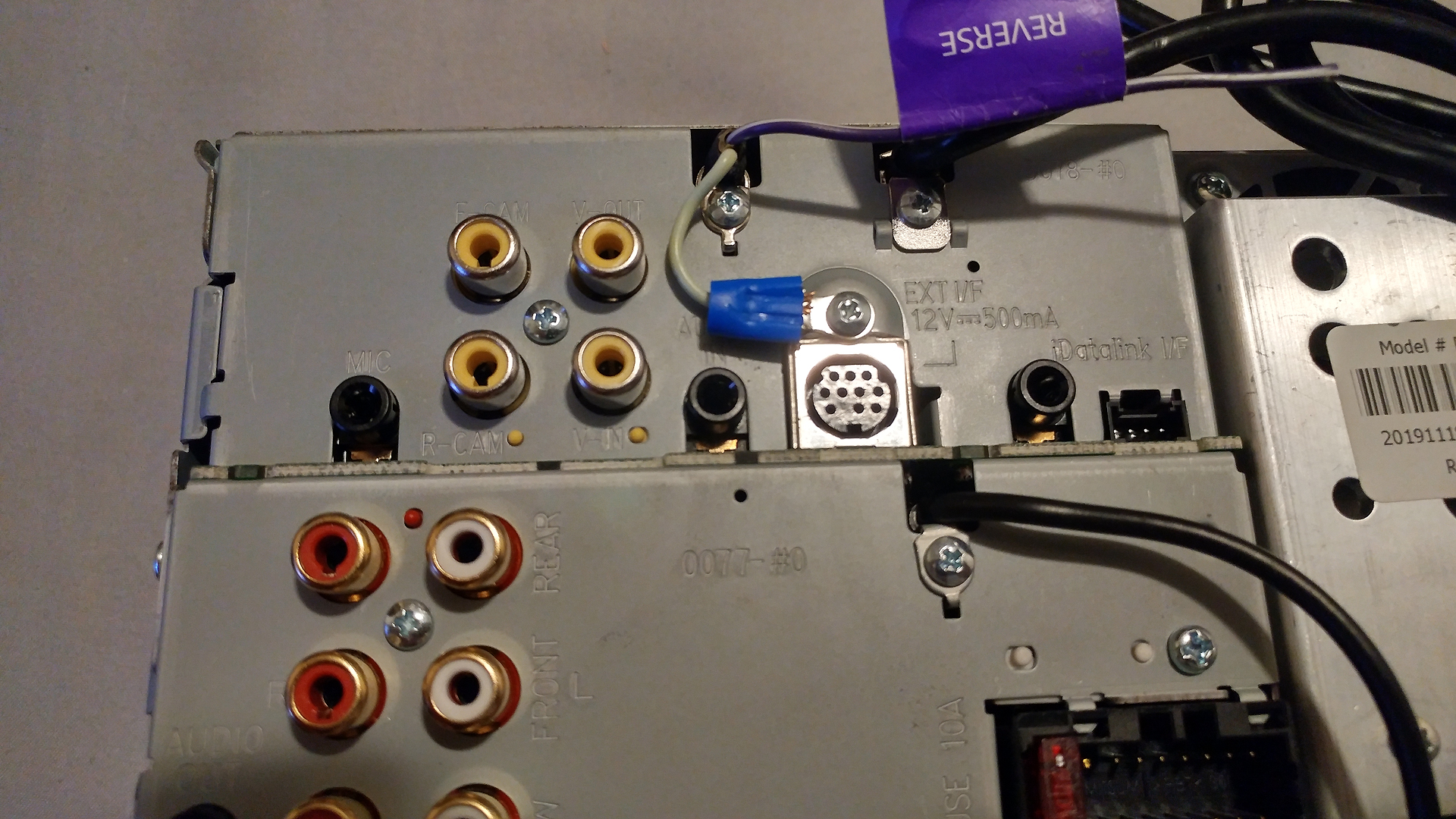

I did some pre-install wire trickery. Did the Kenwood Parking Brake Wire Bypass. It's nice and secure.

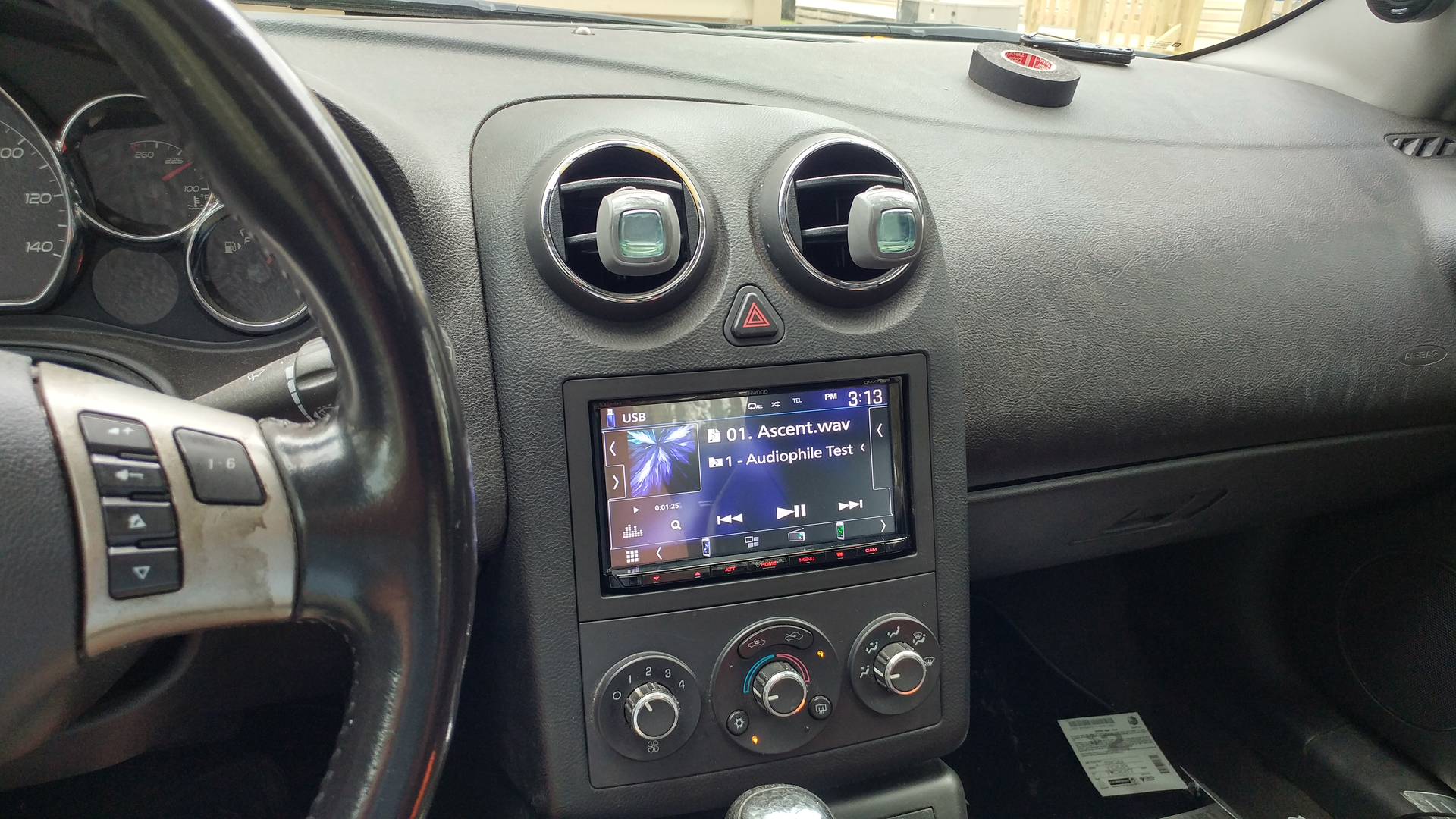

So I for sure found out your phone still has to have direct view of the sky for satellites. I got a cheap magnetic mount for the phone so it sits way up on the dash with a clear view of the sky. The Mic seems to work great and I can navigate 100% hands free.

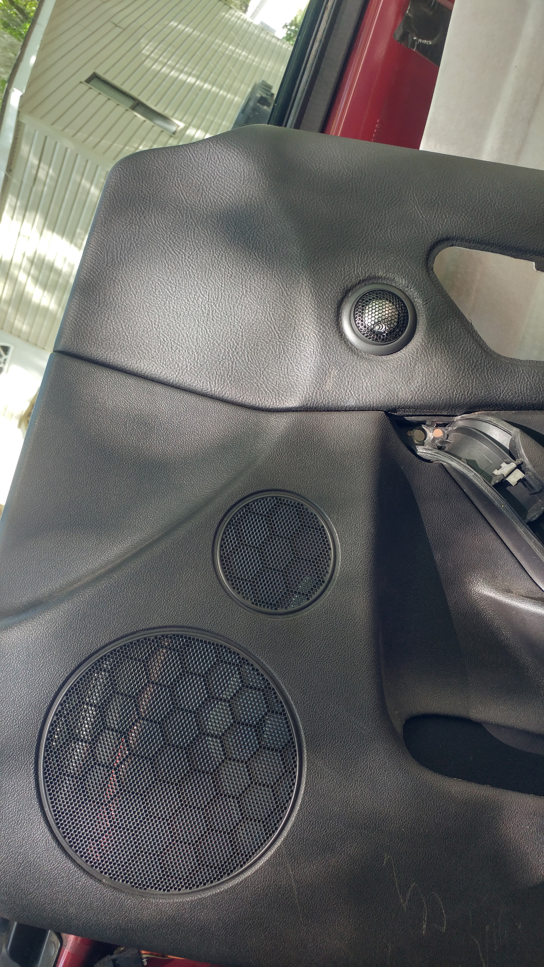

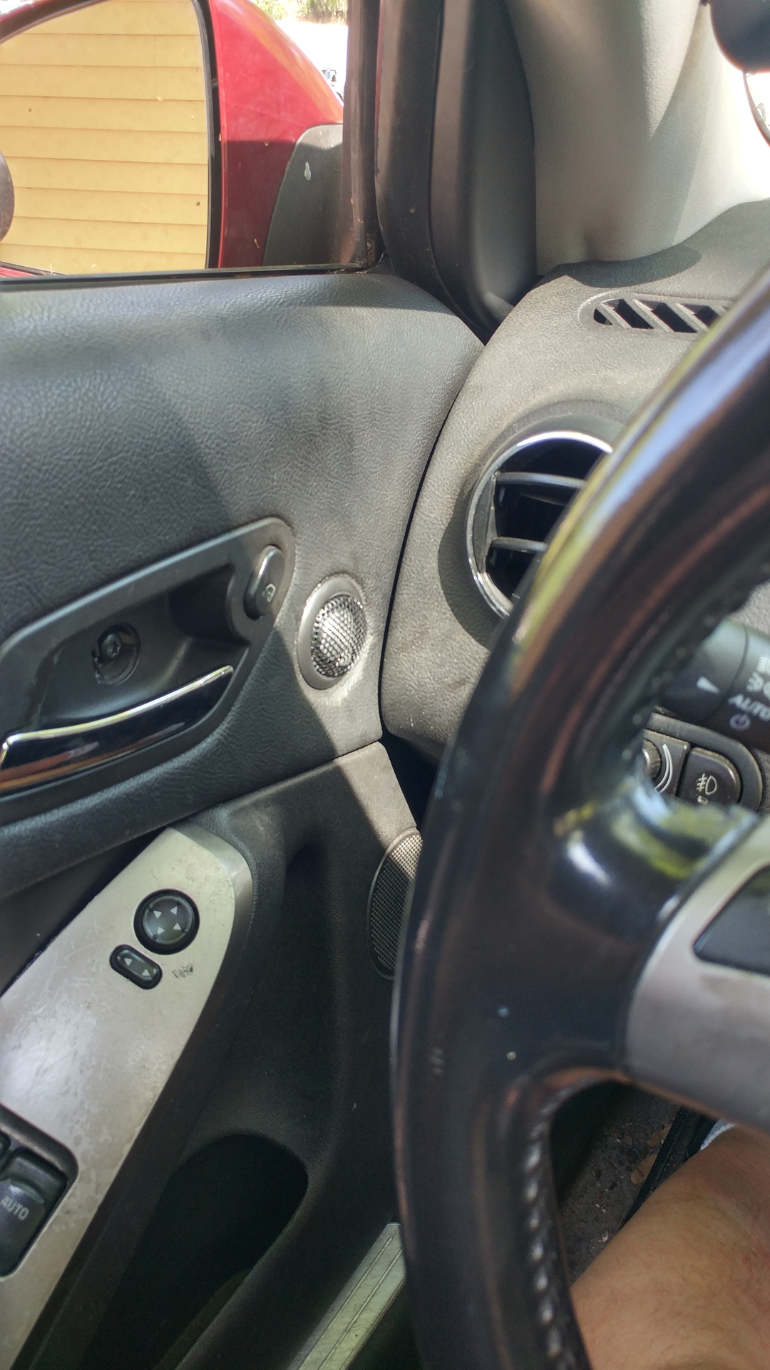

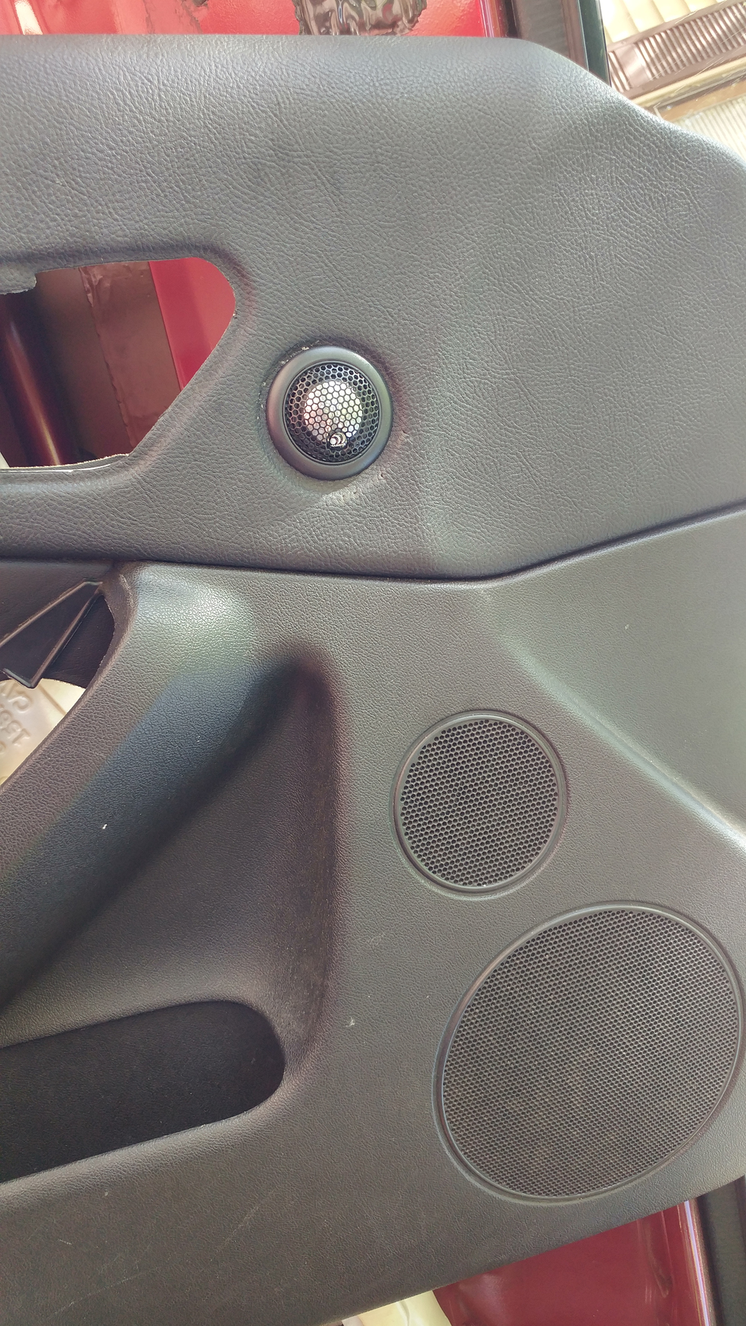

Right now these Alpine tweeters I am using are sort of on axis and they are brutal now that my hearing is back to that of a normal human. The further back I put my head, making the tweeters more off axis, the better they sound. I may move them back to the stock locations in the doors. I also have a set of Massive Audio aluminum tweeters just sitting around... what to do, what to do.

I am going to run a 4ohm 6.5" and a 4ohm tweeter in each door. (Active).

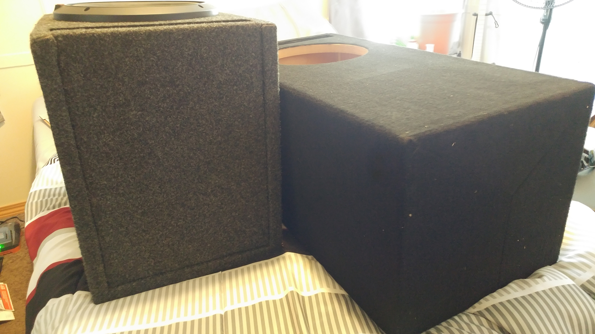

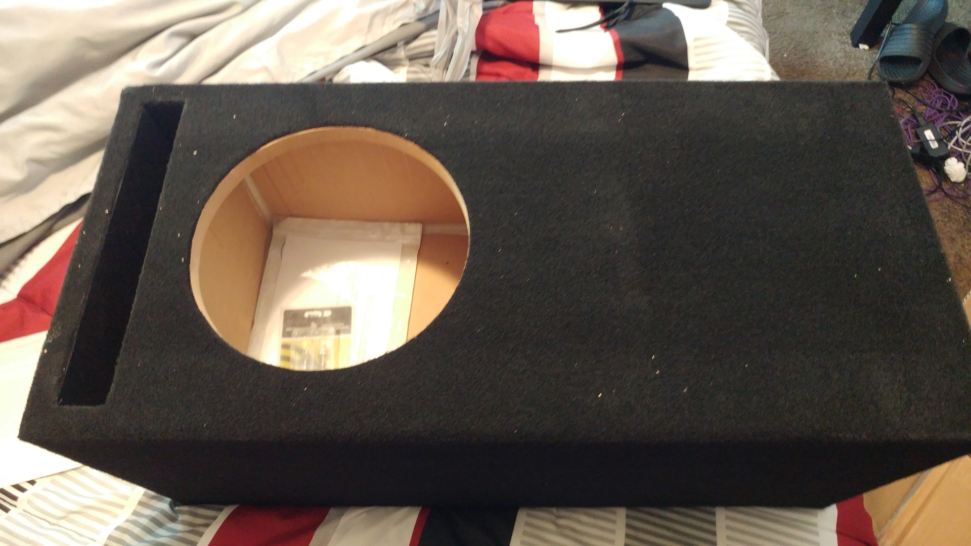

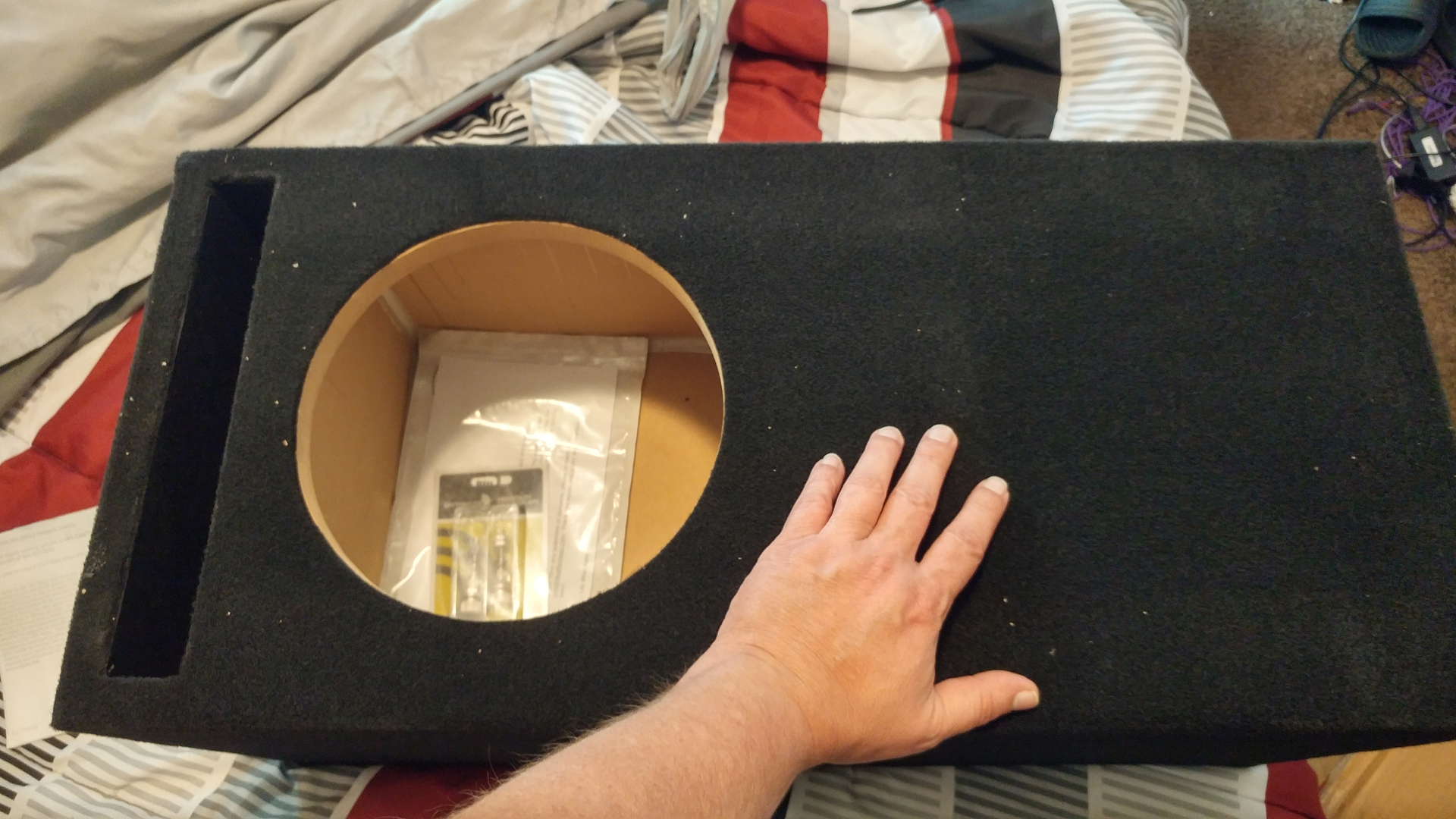

I am going to run two 10" subs at 1ohm. (Active)
I am going to run a 4 channel Punch P600X4 (Mids and Tweets)
I am going to run a mono Punch P1000X1BD (Subs)

I want to run the Punch Pro 6.5" mids
I want to run the RF T2T-S Tweeters
I want to run two Punch P3D4 10" Subs

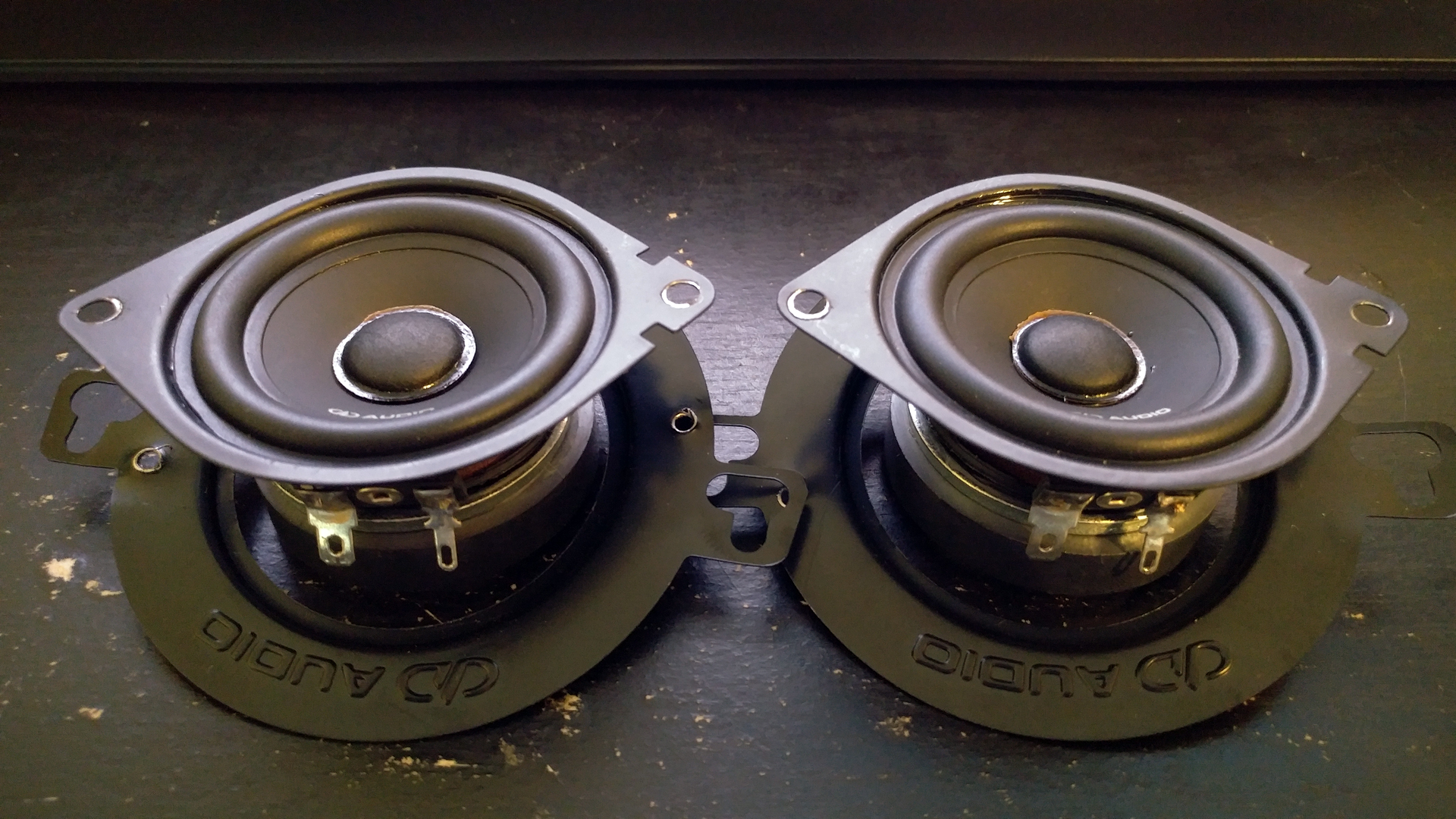

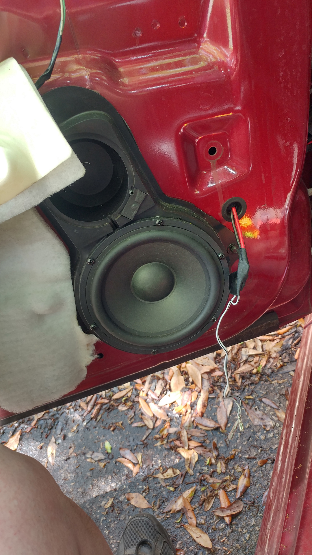

Wouldn't you know it... I think my 2.75" DD midrange speaker in my passenger door has shit the bed. I checked each speaker with my ear right next to them, the Alpines, the DD's and the Silverflutes. That ONE speakers is crackling while playing.

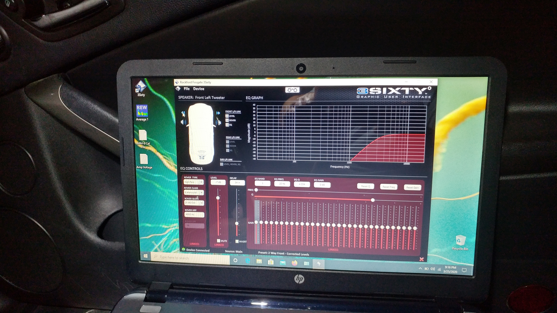

In between rain cycles I took the DD's 2.75" mids out of the equation and the front stage is back to a 2-way set-up. I extended the crossovers for the 6.5" Silverflutes to 90 - 3.5K @12db and the Alpine tweeters 3.5K @12db.

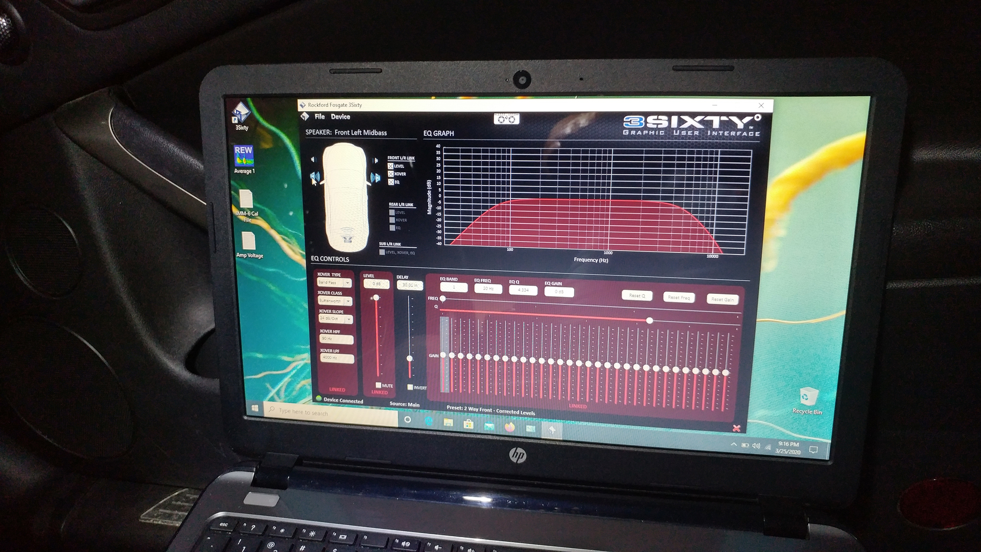

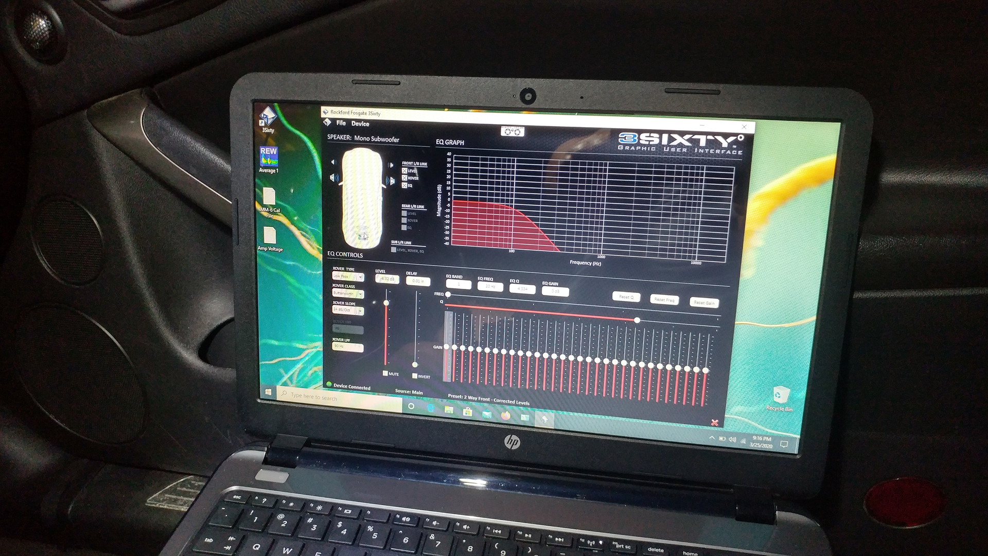

I also used the DSP to find the max volume of the head unit... finally. It goes to 40 but the 3Sixty.3 says max undistorted volume using their "level set" track is 36 out of 40. I also added some gain by ear to the mids and highs listening to music. Barely moved the gains but it helped.
I went into the DSP and fiddled with the EQ for a while. Sounds good. Those Alpines though... the better my ears get and the more I can hear clearly, the less I like these Alpine tweeters. I can't put my fingers on it.
So when I installed the Massive tweeters I removed these DD 2.75" mids. I originally unhooked them because I though I blew one. Well, I tested the voice coils and BOTH settle dead on 3.9ohms. When I gently push the cones in by the dust cap until they stop moving, the impedance's rise at the same rate as the other speaker. I have to assume that one is not blown and they are both just fine. Are there other test I could do?
I went out to the car, disconnected all the speaker wires from the amp and labeled them. I took out my DMM and turned my gains down all the way. I used a 1khz -5db tone and set the gains on the amp for the mids to eventually 18v (18.2v actual) - should be 80w approximately at that setting on a -5db signwave. I then set the gains for the tweeters... again this DMM wanted to say 9. blah blah volts... wtf???? So I found my CHEAP red harbor freight DMM and tried that. YAHTZEE!! Ok, now I was able to set the voltages for the signwaves. Mids to 18.2v and the Tweets to 15.5v (15.6 actual) on a -5db 4khz tone - should be 60w approximately on that signwave.
I also had to reset the EQ in the DSP for the sub as it had been boosted above 0db in a few frequencies. So now nothing in the DSP is above 0db. The tweets levels -7db and mids are 0db in the DSP. Volume on the head unit is 36 of 40 (per suggestion of the DSP). All EQ's flat in the DSP (EQ set in the HU.) The sub is crossed over at 90hz 24db. The mids are crossed over at 90hz - 4Khz 24db. The tweets are crossed at 4Khz 24db. Distances for time alignment reset for the tweets, untouched for all other speakers.
Now! The system sounds so ridiculously clear when listening to specific songs that show off the clarity of a system. All of this at MAX volume. Kick drum is snappy as f**k, bass guitar is clear, vocals don't sound hollow, cymbals are crisp and not over powering. The problem... it is not loud. Ok, It's loud but not to the point it will overcome road and wind noise at 45-70mph. I can hear it at those speeds with the windows down but it is softer and less detailed then when driving under 45mph or with the windows up. Pretty sure this is normal but my ears need the extra DB's for sure when the windows are down and winds are making noise.
