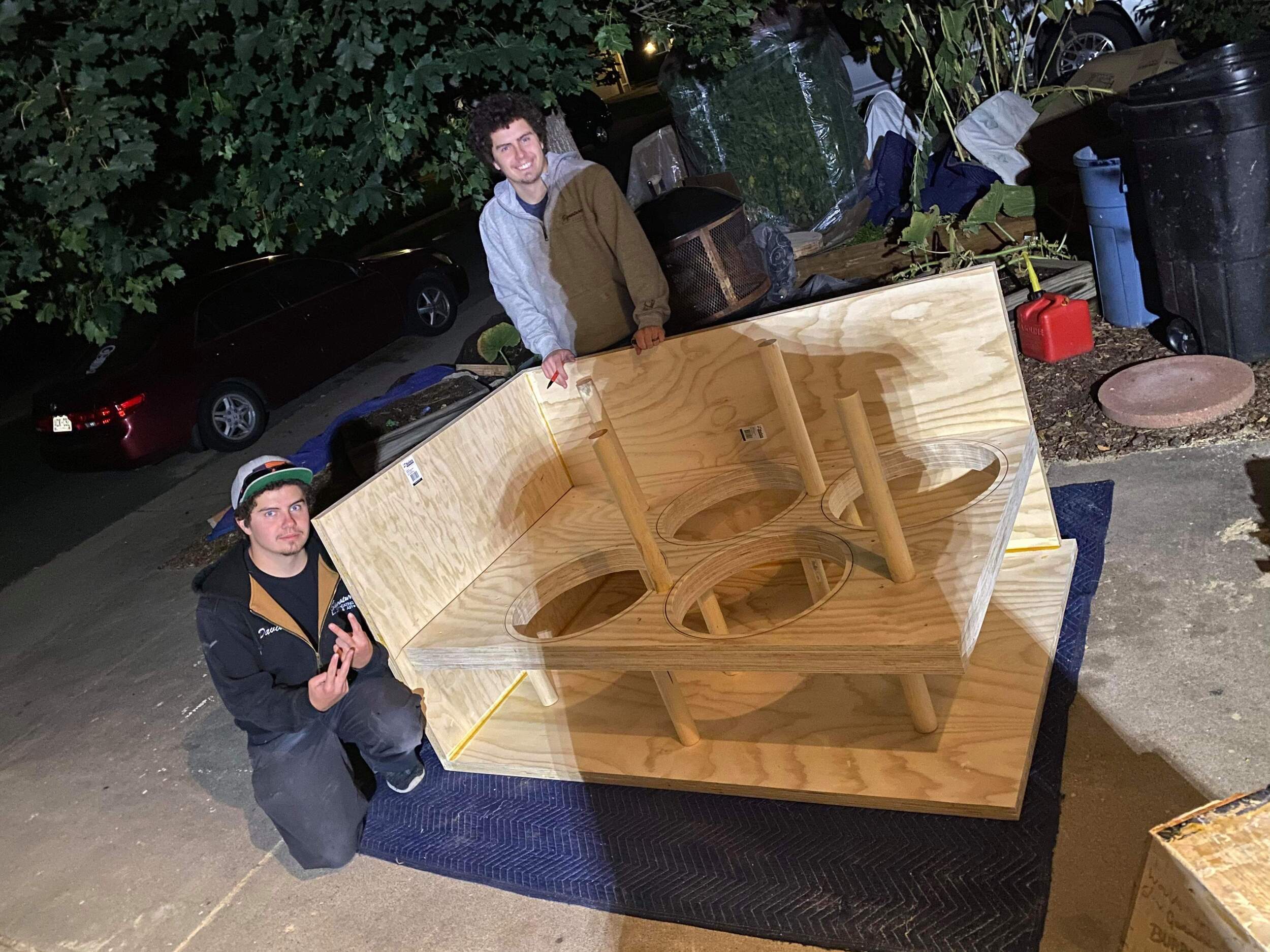

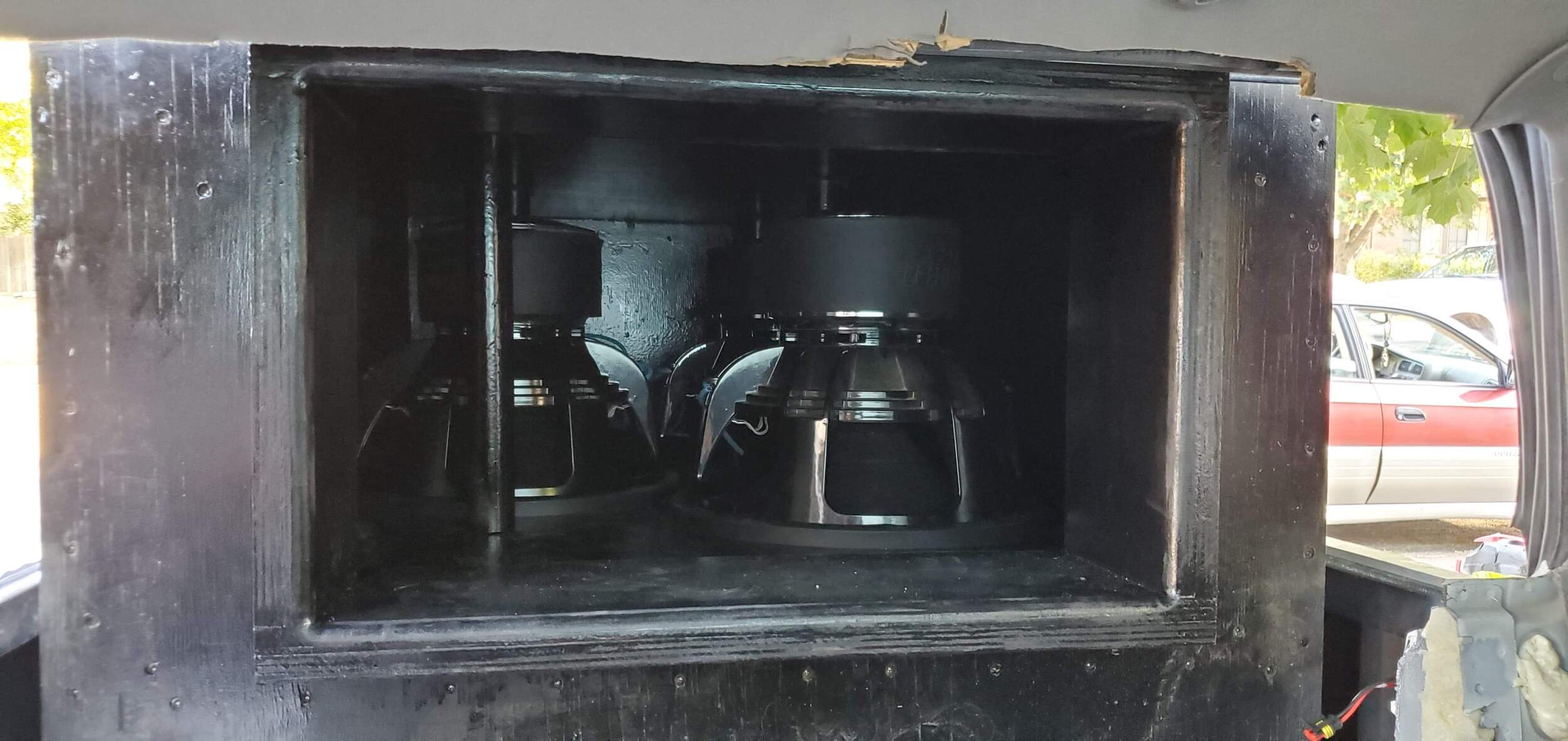

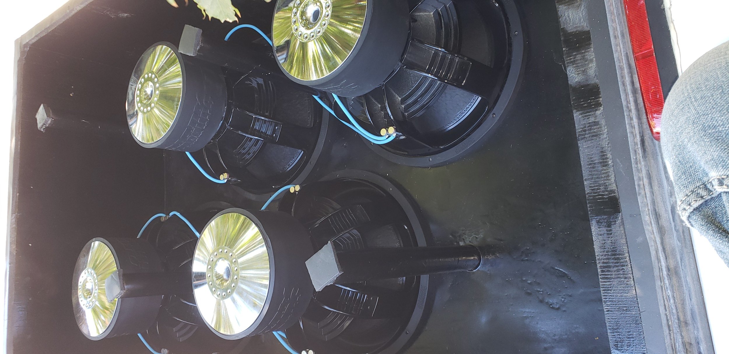

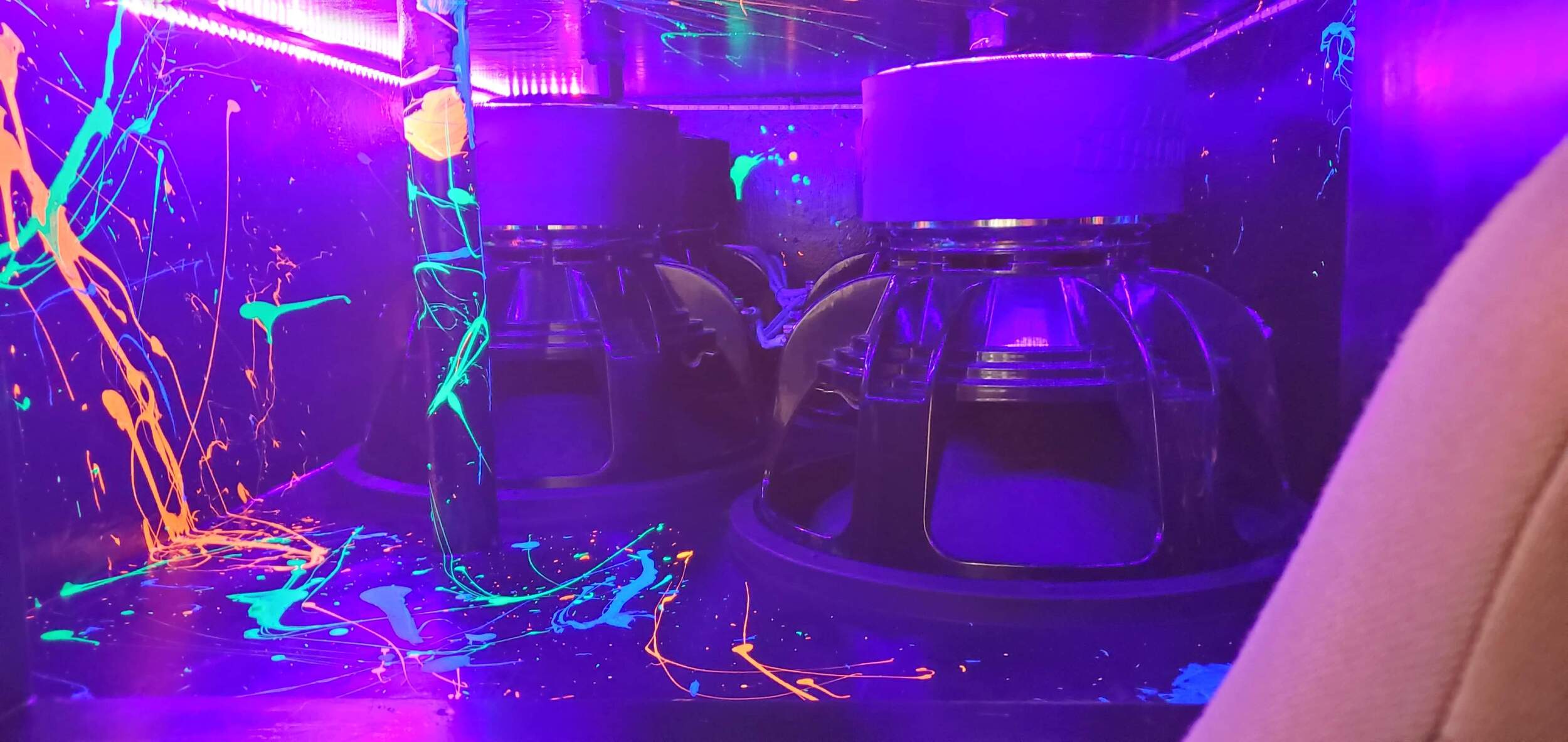

I've posted about this build 2 other times so if you missed those they might be nice to visit first. This is my brothers truck but we built it together and to make things easy I will refer to it as mine. I started with 4 8s hitting 147 in the 30's then we put in 2 18s in a 4th and hit 155 at 34. Our most recent rebuild is 4 Zv518's in a walled 4th order blowthrough peaking at 159.4 at 34 with bandwidth from 21 to 50. We hit 155.6 at 20, 157.4 at 50, 159+ from 32 to 42. Overall its very flat for SPL. Im currently 5th in Colorado and the loudest musical vehicle. Ill post some pics, if you want any more details let me know.

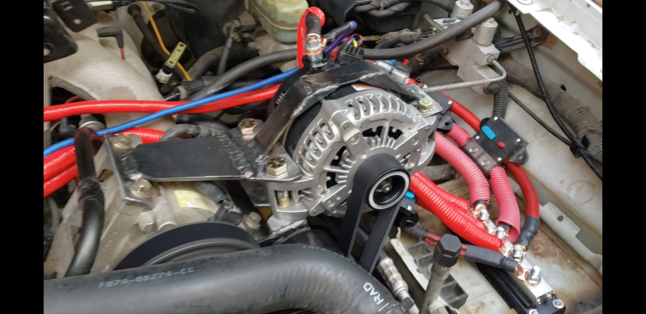

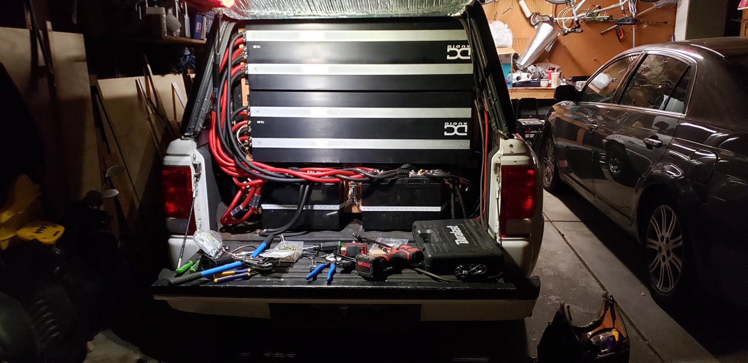

2 10k's? Whats the electrical situation?
2 mechman 320 alts going to a pair of homemade headway cells. Roughly 140 ah of lithium. The second alt needed a custom bracket. We wanted to keep air conditioning and had room from doing a front battery delete to put the second alt in that area. My buddy does custom offroad stuff and he's the one who built the bracket.
