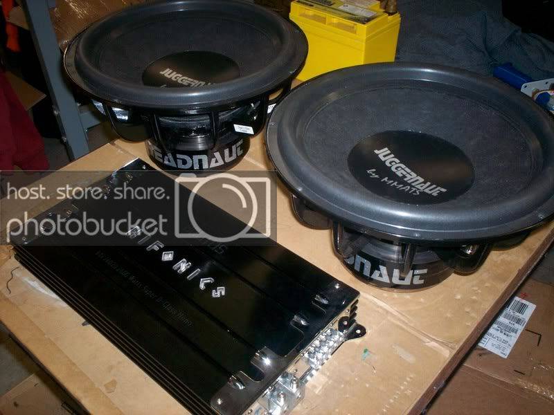

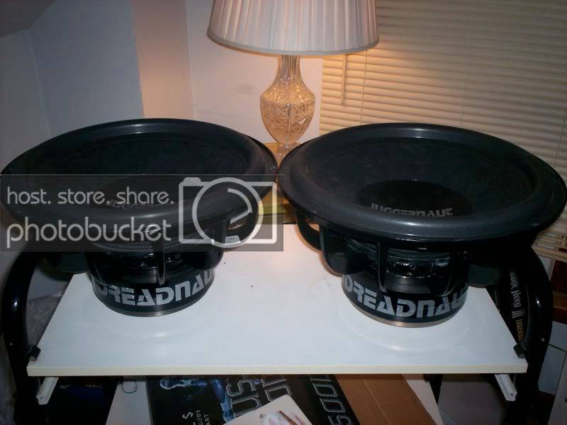

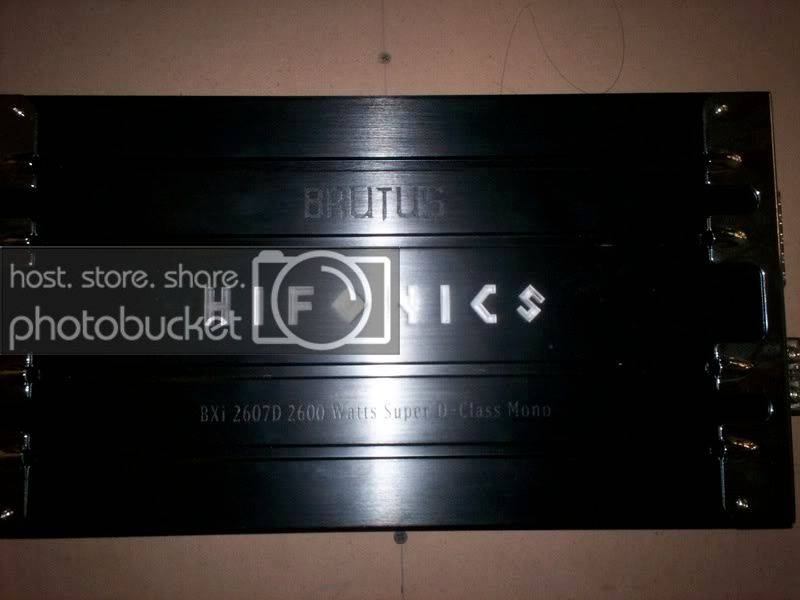

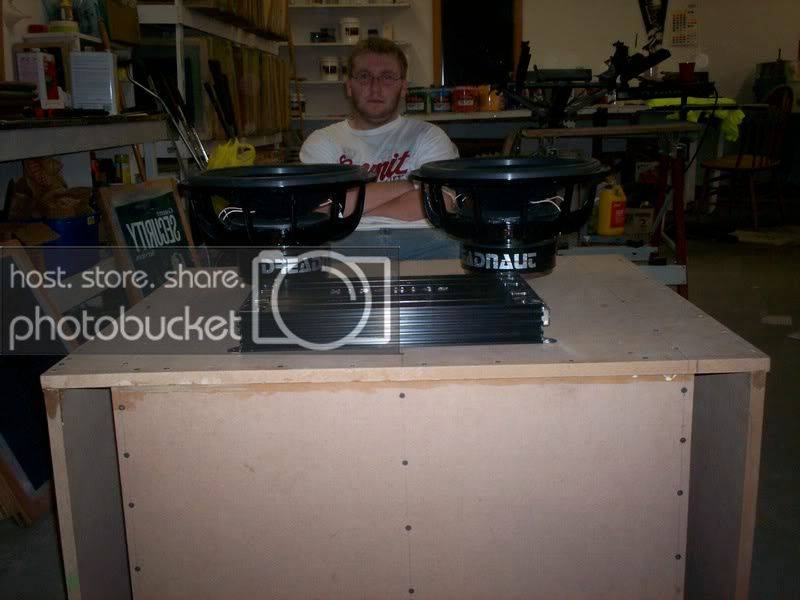

Ok well I decided to upgrade finally, and I will layout the system and everything. The system consists of:
- 2 15" MMATS Hybrid Juggernauts (Druggnaut 30's)
- 1 Hifonics BX2607D (2 ohms daily, .5 for comps)
- 0 Gague wire all around, A Redtop up font, and a stinger SPV35 in back (for now)

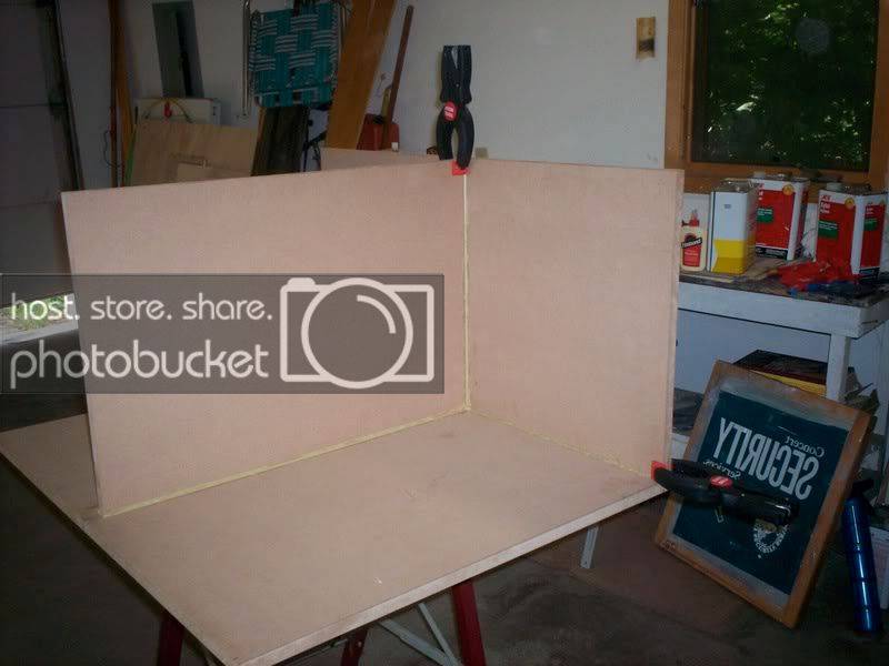

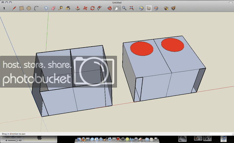

Box Specs Are: 39.5 x 31.5 x 21.5
12 Cubic Feet @ 34 Hz
Pic I Drew Up:

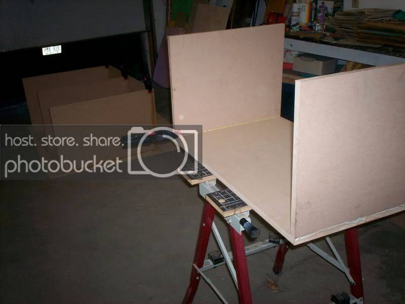

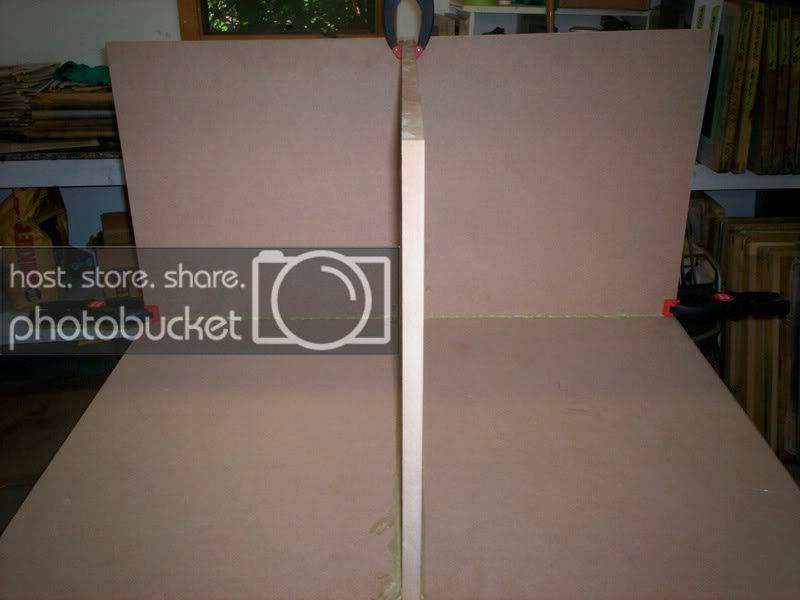

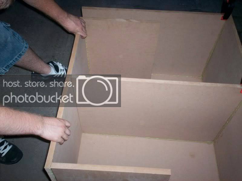

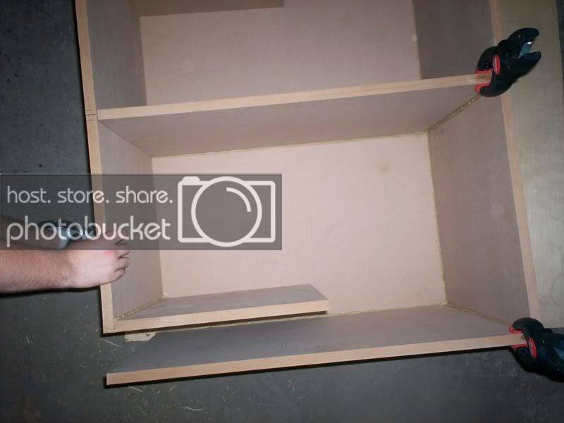

Setup
Wood

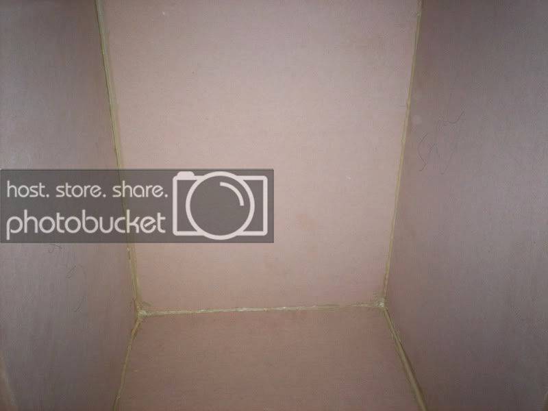

Bottom

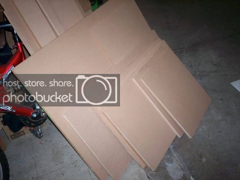

Suppliez

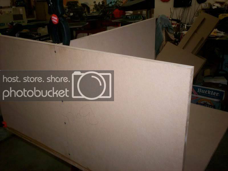

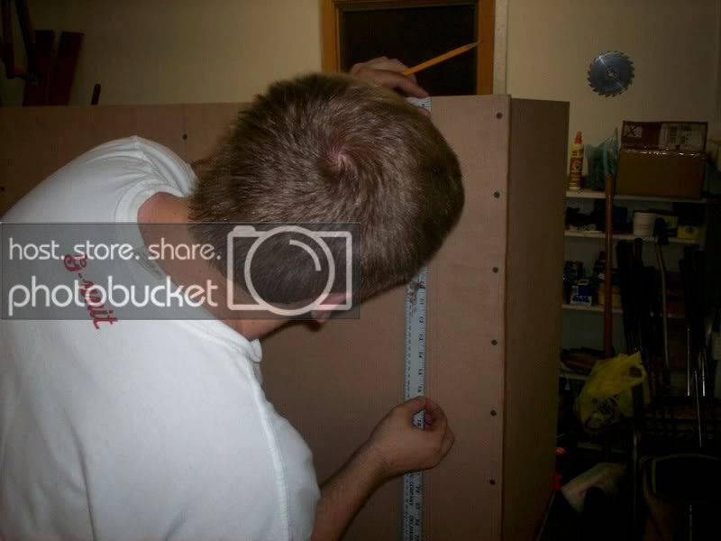

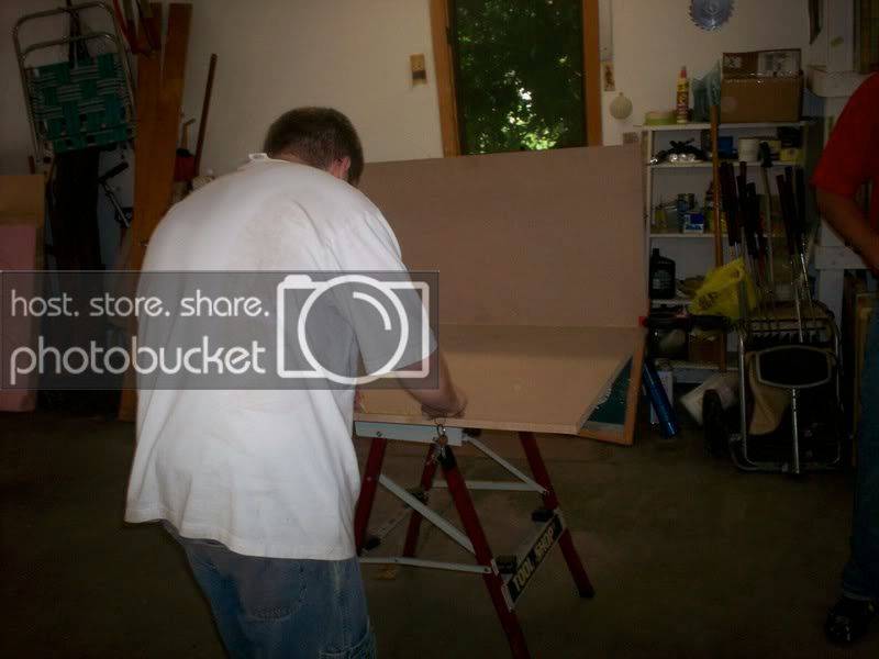

Measure Measure Measure
Center Piece On@
Thomas Not Doing SHIT ^^^

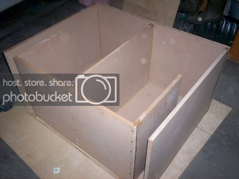

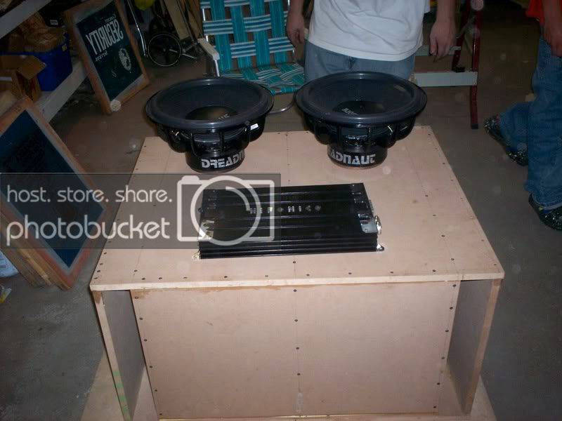

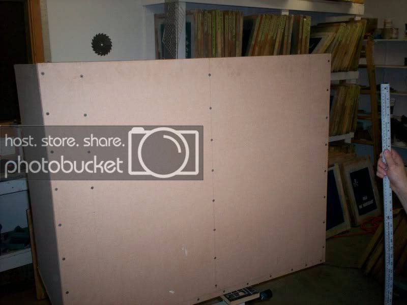

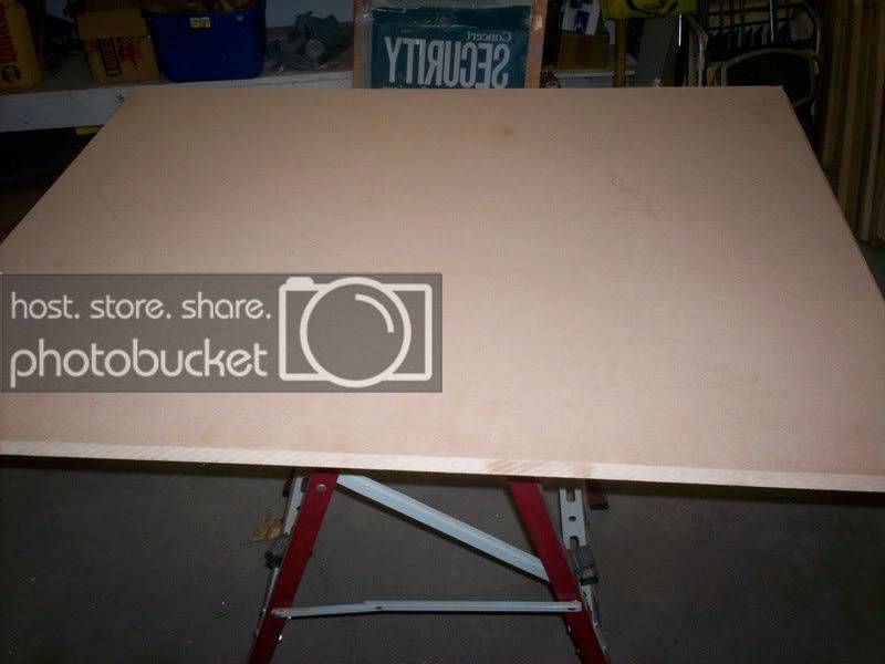

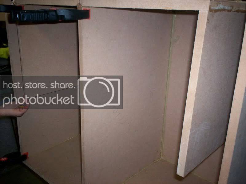

Still gotta cut out the sub holes N put da suckers in, so thats what I have for now, tell me what yall think

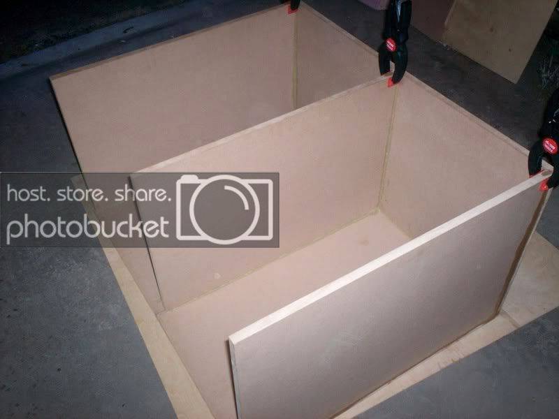

good looking build. should be loud. Did you double baffle it?
No //content.invisioncic.com/y282845/emoticons/frown.gif.a3531fa0534503350665a1e957861287.gif I didnt have enough money to get 3 sheets of wood they are 27$ here //content.invisioncic.com/y282845/emoticons/frown.gif.a3531fa0534503350665a1e957861287.gif
where you get that lil program at? and thats a hell of a box you got going on there it should sound pretty good
Its google sketchup, and thanks for the compliment!!!
If you haven't cut theholes yet, I I would mount the subs further to the rear of the enclosure. It should be louder on there meter like that, if you are looking for some decent numbers.
