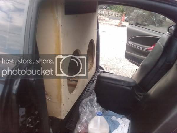

right now there is like a 1inch gap around the top and sides, the metal is also at a slant so its about 1 inch wide and about 4 inches resessed at the bottom. I want to fiberglass to the car and to the box, so theres no more gap around the box. mostly for looks, a little is that it will seperate the cab from the trunk. but if you look at the picture of the deck there were the mids are, theres alot of holes I would also have to glass over to truley "Seal" the back

got the wood now for the sub floor. Also, took out the fiberglass mat and played with it a bit... Its nothing like the last stuff I used.. I can see why you said to fleece it then use the mat to back it.
Long story short, heading to walmart to see what fleece is on sale, and getting a staple gun for affixing the cloth to box
So I got the cloth, and have it affixed to the box. also got a sub floor in the back now to mount the box too and have my new rear mids and highs in... A pretty good day for the late start I got.

got the glass laid, and some paint on it. I really should sand it down and repaint, but this is gonna be coved by my rear seats about 98% of the time, its not a show car, customer car, or any other thing that I otherwise care about the aesthetics. That, and I am tired of not having a car. So tomorrow, front mids / highs go in, subs go in box, seats go back in, and it should be done!

thats 1 layer of fleece, though the ONLY place it needs any strength whatsoever are the the little triangles it made on the left and right, just above the wire holes. Everything else is screwed into sheet metal or wood.
so here I got the subs in. really underestimated the rigidity the resin would give the wood where I brushed the face of it. I literally had to kick the subs in. Oh well, they fit nice and snug, don't think there going anywhere.
THEY FIT! Starting to look like a car again.
And what I been aiming for:
